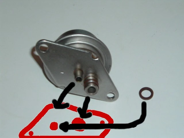

Check the size of that Oring looks like the wrong one theres one that stays in the hole i pointed the loose one to. if u took that O ring off the old FPR then look in the hole to see if it is still there.
