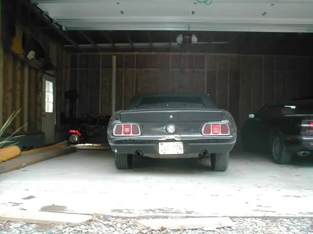

The reason I am doing this is because my drivers side rear end sags and at the tire it is about 1-1/4 " lower than the passanger side. I have already lowered the front end with 1" lowering springs.
I like the stance better looking toward the drivers side.
I just checked the CJ Pony website (haven't called them yet) and they have standard rear leafs and a set by Global West. But I didn't see any that were lowering. So I am afraid that the rear is going to sit way too high with standard new springs.

my saggy rear
updates will be forth coming
