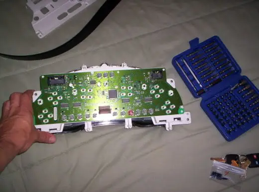

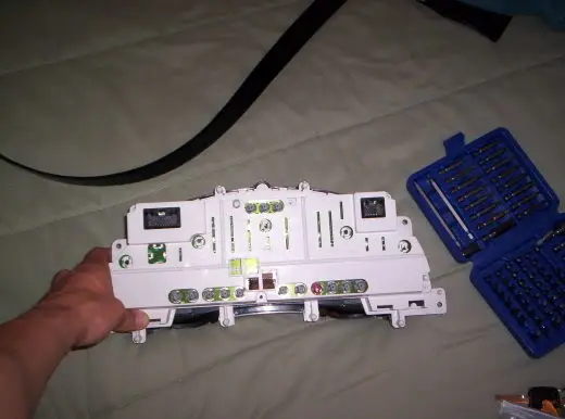

I haven't done this yet but I've been looking into it because I'm going to swap to a Mach 1 cluster and I was under the assumption that you had to change the back green board. I hope this works for you. Here's what I mean.
Take off the white plastic then
Then swap the green board. Like I said, I hope I'm right and that it works out for you. :nice:
