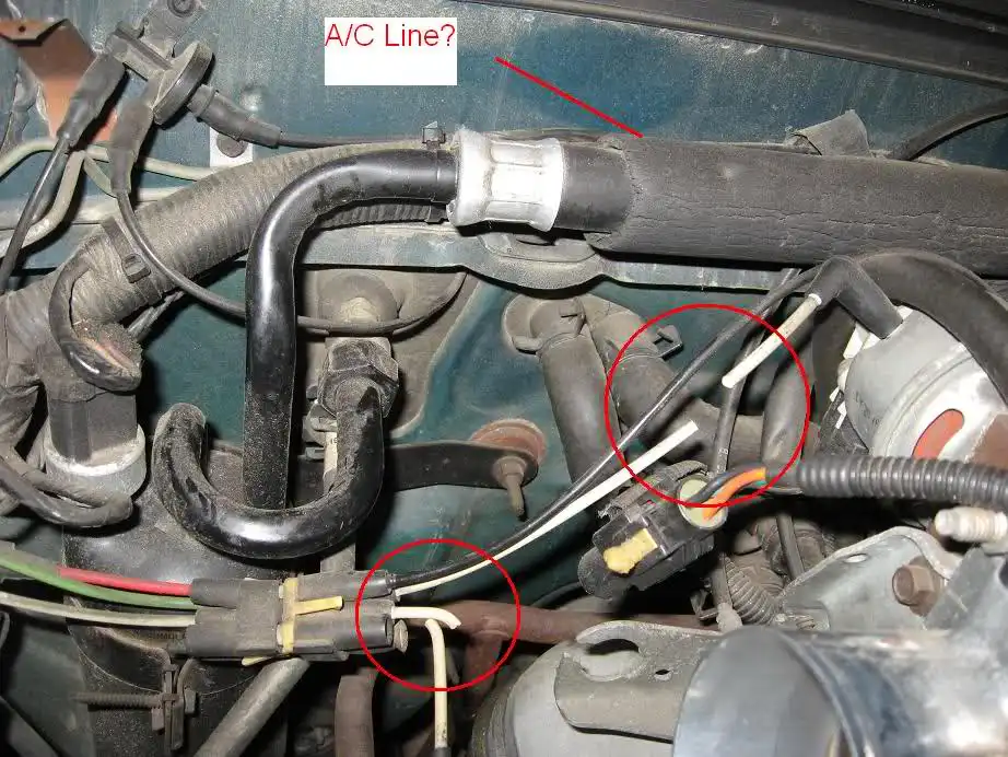

First, since it was really cold out, we went to move 2 vacuum lines and they just snapped. I think both are for EGR, one goes to the back of the TB and the other goes to a Tee alongside the passenger side header - they come off a distribution block on the passenger side. I've circled them below. Also, to remove the upper intake it looked like the A/C line is in the way? Is there enough give to move it to get the intake up and out? I think my dad and I decided to postpone the operation until we get warmer weather - the plan is just to take off everything, cut off all the hoses and crap and replace it all with new stuff as we go. So, my questions:
1. What lines broke (circled below) so I know what to ask for at the parts store?
2. What do I do about the A/C line in the way of the intake? Not my engine in the second picture but my line is almost resting on top of my intake.
3. Anything else I need to know to carry this out when we do it? I thought it would be simpler yesterday, but I think there are a lot of old hoses that are just stuck on everywhere and I didn't want to break anything else trying to get the intake off.
Thanks.
Thats just standard hard emissions tubing. It is usualy sold rolled up in a package in different lengths and sizes. Best bet is to take some in with you so you know your getting the correct size. I've also taken rubber vacuum hose and put over the hard plastic line to splice it back together. The broken line on top is to the EGR valve the other line I'm not sure.
To fix the cracked hard vacuum line, i've found that sliding a peice of heat shrink over the two ends and heating it up usually does the job.
Not the right way to do it, but it has worked.
Those lines are sorta unique, and short of finding them off a junkyard car i don't think you can get an OEm replacement
Okay, thanks for the replies. My plan was to find some rubber tubing to make the splice, the heatshrink is a good idea, I hadn't thought of that. They're capped off right now and the car is running fine, but I'll rig that stuff up. Do the spark plug holders just snap onto the valve cover bolts?
Yes, provided you put the intake bolts with the studs in the right spot.
