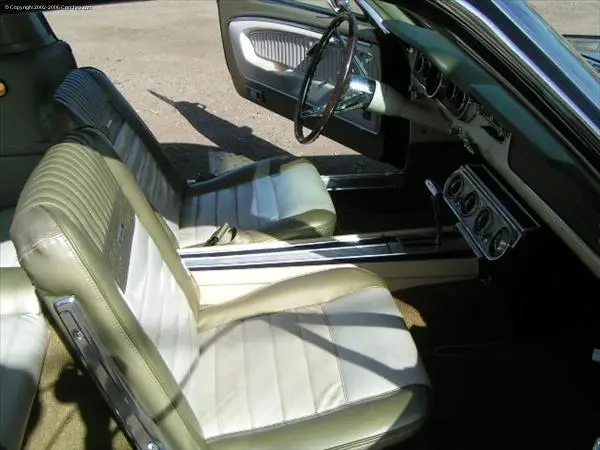

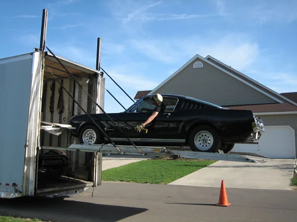

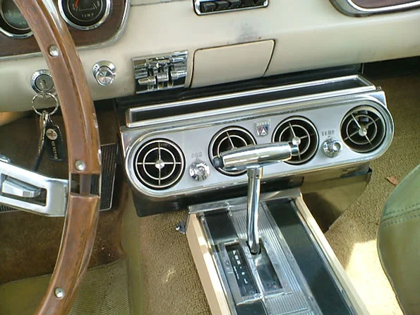

Ok,
I just picked up a '65 fastback in black with original deluxe interior in white/ivy gold. For the most part, none of the interior is salvagable aside from some trim/chrome pieces, so for all partcical purposes I am starting from scratch.
I am having the hardest time picking what I want my interior to look like. Black would be the easiest choice, but would like to get some contrast for character. I have also like the look of maroon/burgandy.
I am requesting opinions, pictures, and the recommendations for the best place to order interior quality materials from.
Any help would be much appreciated!
Thanks in advance.

The outside looks nice, but the inside is kinda weak. My interior is black as you can see from my avatar, but since your exterior is black, I'd choose burgundy or maroon for contrast, but please don't get a bright red interior---unless you want it to look like the inside of a whorehouse :nono:
Congratulations on finding a nice looking fastback. In my humble opinion the '65 - '66 2+2 Mustang is one of the best looking cars ever built, then again, I'm a little bias.

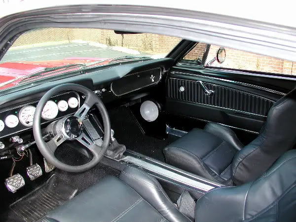

For your carpet, you can order any color and type of carpet you want from Auto Custom Carpets - http://www.accmats.com/ - They custom made me a plush cut pile carpet, heated molded for my car and it only cost $10.00 more then buying the stock heathered loop from one of the venders. Also, forget the stock and reproduction door sill plates, they are way to flimsy. Scott Drake finally came out with a Stainless Steel door sill plate that is much thicker and more durable - http://www.mustangdepot.com/OnLineCatalog/Interior/door_sill_plates.htm

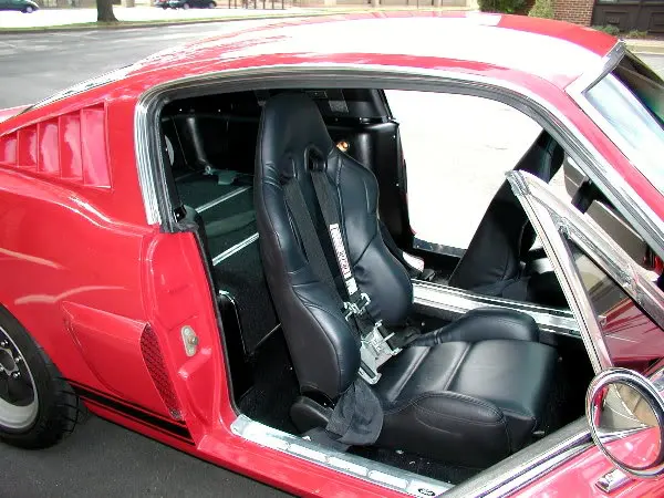

Take the old stock seats out (and store them) and get some new style seats. They will be much safer and more comfortable. Start a new thread, just on seats, and you will get a ton of good ideas. I sprung for some new Corbeau CR1's in black leather - http://www.corbeau.com/products/cr1/cr1.shtml

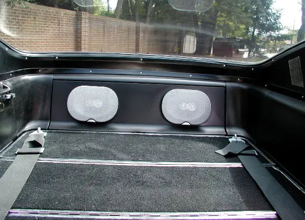

For your stereo, I say go ahead and cut the dash and install a good quality head unit. I've got the top of the line, over priced, Custom Auto Sound Kenwood Cassett Player, CD changer ready, receiver - and it is a total piece of Sh_t. I do have some nice Infinity Kappa 6X9 speakers mounted in the rear lift up panel.

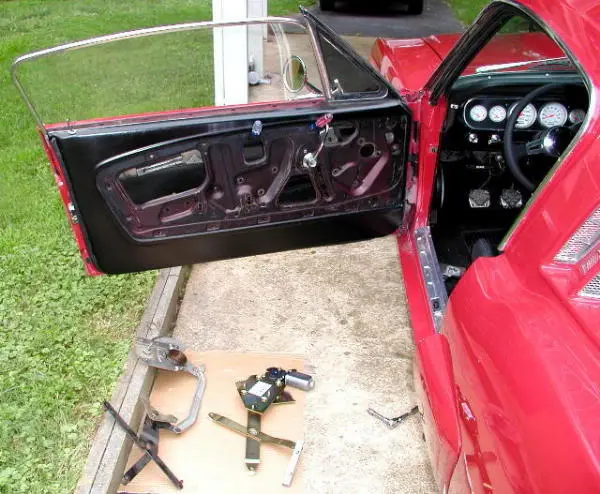

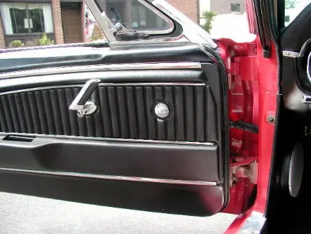

And some componet speakers up front. I installed the woofers in the kick panels and the tweeters in the hole left by removal of the window crank (when I added power windows).

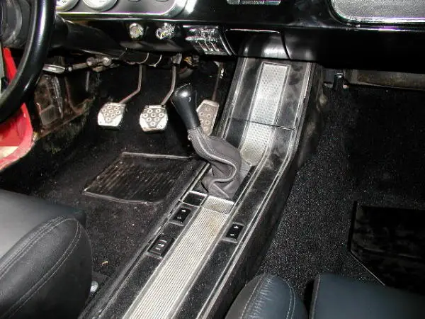

Power windows are a great mod to do.
I installed the window switches in the console.

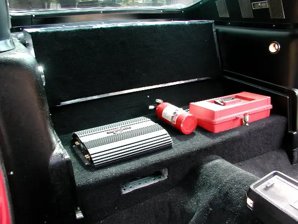

Sorry, I got a little carried away. Also, I removed my back seat and made an amp rack and tool box holder. I've got pictures of the process if your interested.
