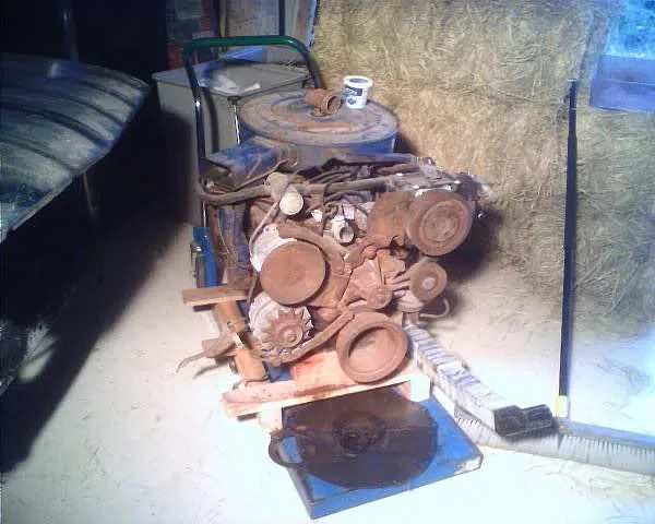

-Aside from the second owner taking the engine, tranny, and font clip off (I have them) this car is 100% complete. The engine looks like it did in 1968 (It's just rustier and not in the car).

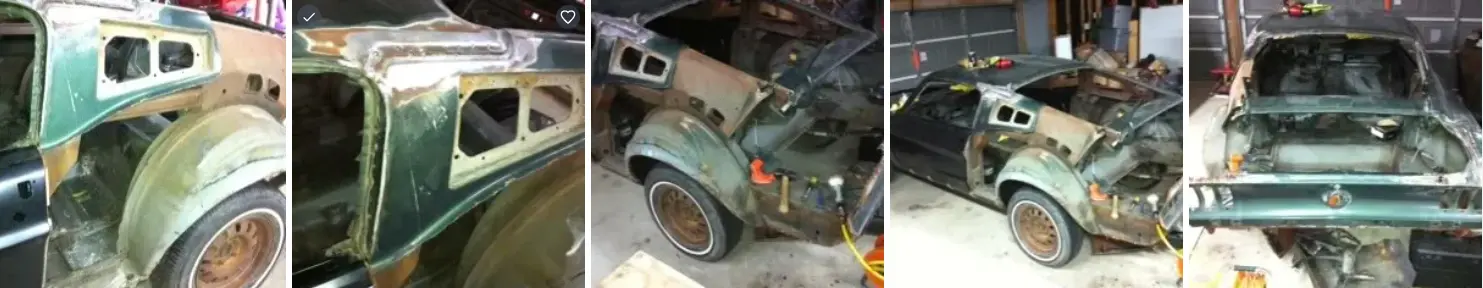

One reason for the Quarters and tail coming off...Rust on the underside from the "Greenhouse" effect:
Also...there was damage in the quarters... around the wheel and the passenger C.
The OMG - what did I do?/??? moment...

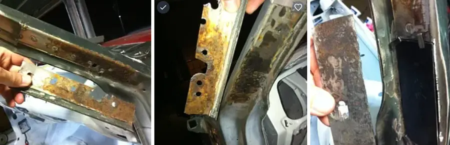

The Red on the inner structure is rust - just surface though...apparently not painted by Ford.
Rust all cleaned up:

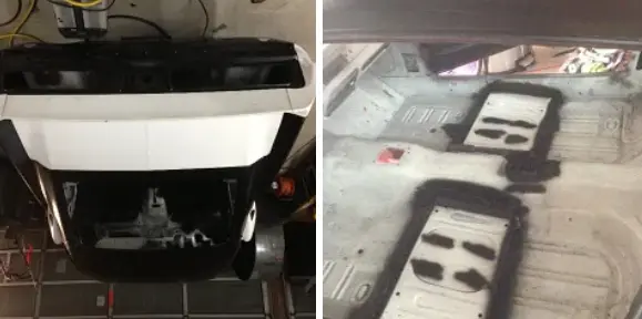

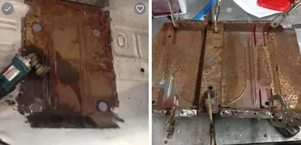

Cut out the seat pans - cleaned underneath (Needed it!). Cut 1" off height and rewelded further back in the cabin... I am 6'2" and relish the thought of a Mustang that is comfortable to me (NOTE: with the build for the kiddo...I might need to move them back to original ... sigh).
Before and After Seat pans:

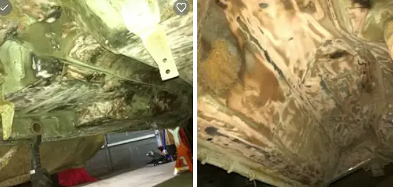

That is POR-15 black (Never EVER do this) with the original 'primer' overcoat for looks
During the cutting for the center pull brake lever...noticed something hanging down under the car. Crawled under there and it was where the POR 15 had separated from the clean metal. Pulled on it and got a strip about 10" long where bare metal was exposed. Crud. The bottom was thoroughly washed and prepped with the chemicals that POR 15 supplies - I guess it is just not good without rust on the metal (I have heard this). Found several other places where the POR15 did not adhere. SIgh. Some places it did - that sucked even worse getting it off the second time.
Needed to remove everything from the bottom of the car AGAIN and repaint.
So... did what any normal person would do and built a homemade rotisserie out of some oilfield pipe, dropped everything I could off the car and lifted/rotated it. Was able to re-clean the bottom side from standing and sitting position...ton of work.
On Round 2 of cleaning the bottom - Just left the underside a shiny black= can overcoat with the red primer for authenticity later...or not. The seal from the Gloss black is what I wanted. You can see the installed (homemade) frame connectors....I welded these in on the ground with the car levelled - then left the cleanup for while the car was rotated.

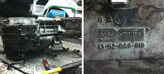

Trans out of donor car T5 transmission. Car would not go into second gear... Turns out the 'planetary' gear had a burr on the inside not allowing it to slide over the inner gear and engage. Had a friend of a friend who had the exact gear laying around....awesome - got it reassembled and functional (well hopefully functional :) ).

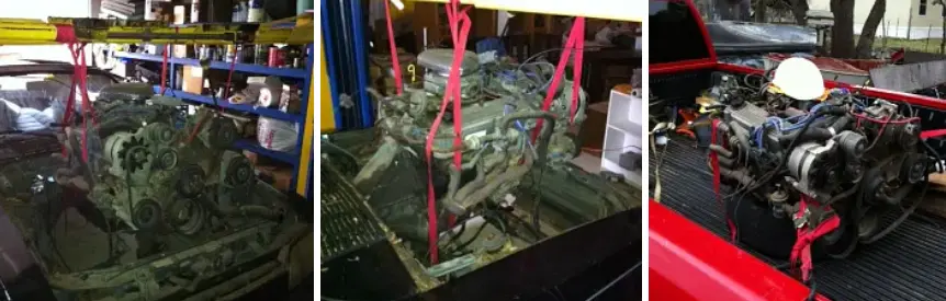

Motor coming out - has since been completely rebuilt (bored a little, hardcore pistons (I think Hypereutectic...maybe forged, cannot recall), trick flow heads, rebuilt carb <with solid floats in case we need to pressurize the incoming air ;-) >) and sitting on a stand. (Sorry no current picture of rebuilt motor, did choose to paint the block Ford Blue...picture it clean prettier). The AC compressor is shot - but it "Free Spins" so that A/C install can come as we assemble the car. <Yes - I used a car lift to get the motor out>.

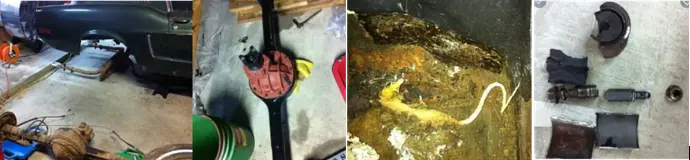

Assorted pictures: The Ford 9" (Yes original to this car...was small block GT). Before and After.
Found the little guy (Rat Skeleton) behind the Rear Passenger Drivers side Armrest...anyone for a real Rat Rod?
The Pieces are getting the original leaf spring out - bolt would NOT come out of sleeve - had to cut through everything to get in.

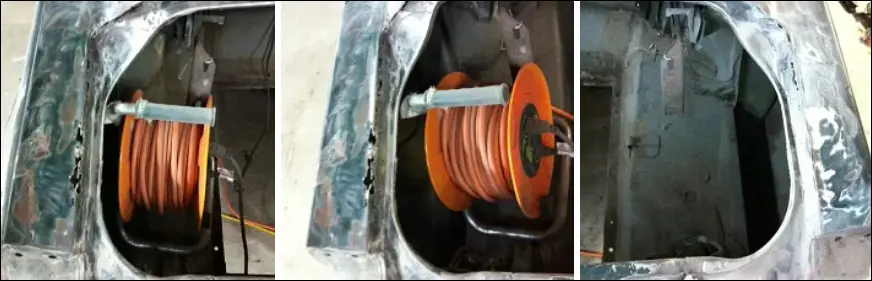

Quarter panels coming off - that last bit near the vent is less fun as it is tacked on three sides.

POR15 does piss me off. But that was my own stupidity - I knew it was iffy and POR15 even says not to use it on bare metal. No way I am leaving a speck of rust on the car so....Zero use for POR15. -CONFIRMED that stuff is NOT for use on cars - just use on where you keep your rusty stuff.

Yep por15 will peel like a sheet of paper of clean metal even with there prep kits, better to just use a real 2k epoxy primer/sealer, learned that about 20years ago after removing rubberized undercoat off one of the Gt's I owned.... Still will never buy an under coated car. real Epoxy Primer/ sealer and paint only, no rattle can products.
