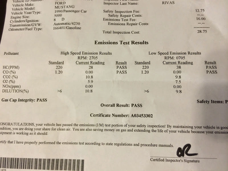

Here's another interesting piece of info: I took the car to get inspected today, half expecting it to fail due to the lean codes, but it passed with flying colors. The tech commented that it was one of the cleanest reports he has seen.

Glad to see you passed the emissions test. They can be difficult with older cars.
