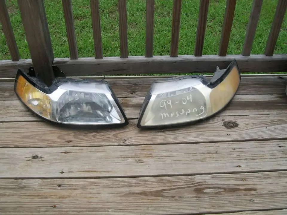

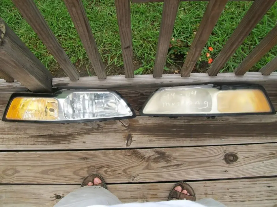

With all the talk about fixing headlights, I decided to fix a pair for my 04. My factory ones are too far gone to repair, but I got a free set of 99-00 lights and with about 2 hours with the 10$ Turtle Wax kit, they look brand new. Next I'm going to spray them lightly with some nightshades and clear and then wet sand.
Here's a couple of one finished and one the way I got them.

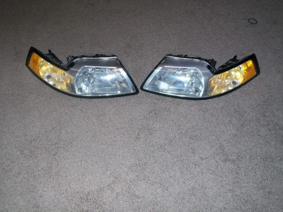

And one of them both done. They actually look clearer in person than what it looks like in the pic.

I dont think your headlights came out as clear as the ones I did....
I don't do this kind of thing all the time either. That's the first set I've done, and it was by hand.
They are little bit more clear than they look in the pics.
