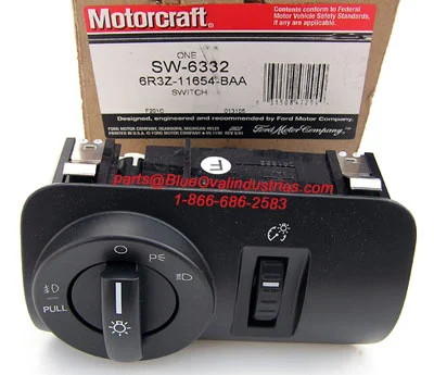

why cant i get the GT connection? or the switch for the pony package equipt cars. the GT has fog lights obviously, so couldnt that switch be bought and used for the grill fogs like a stock gt?
You can, and it will work ,,, but your car is not pre wired for the Fog lights -
so even with the switch - the wiring, an in-line fuse or a relay to the fuse box will still have to be done.
There are some good kits out there that are 'Turn-Key' - I'd recommend that you take advantage of them.
best of luck ~

The other thing to consider about the GT switch is that Ford will need to make some programming changes to the smart junction box to get it to recognize that there are fog lights. IT likely shouldn't take much for them to do but I don't think most Ford service departments will know how to do this.
IMHO you're better off getting an after-market wiring harness and extending a couple of wires through the firewall into the car... or using a remote control switch as I and several others on these forums have done.
I have had the GT switch installed and its not a big deal at all ...
We just used an in-line fuse and tapped a hot headlight wire for power.
no problems at all, and a cleaner install than adding another switch, IMO
Cool! So what did you use to trigger the fog light switch? I didn't recall reading that there were discrete contacts on the back of the switch so I assumed that the ECU and SJB were resonsible for bridging between the GT switch and the fog lights.
