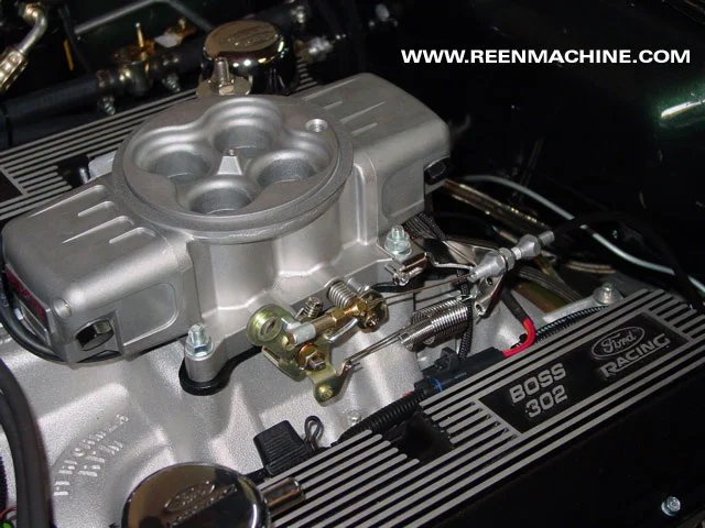

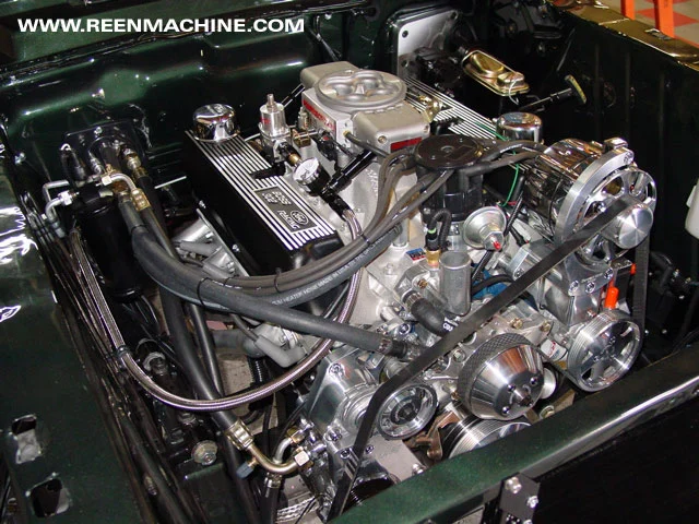

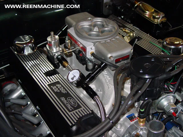

The install was super-easy, but it'll be a while before I fire it up as I'm waiting on the fuel tank.
Basically put it on like a carb. Make and connect fuel feed and return lines, hook up a few wires (coil, keyed hot, constant hot), plug in a couple sensors (O2, coolant temp), and that's about it. From the driver's side the thing looks pretty much just like a carb.
Our customer ordered the older version. Had to place the ECU, AFR meter and all that good stuff. Some fun finding places for it all. The injectors are a bit louder than you would expect. Thought we had rocker clack for a minute. Only real problems we've had so far is the start up enrichment isn't rich enough. And one of the fittings broke waaaaay too easy. Jump through hoops to get a new one. But runs great cold, good throttle response.
