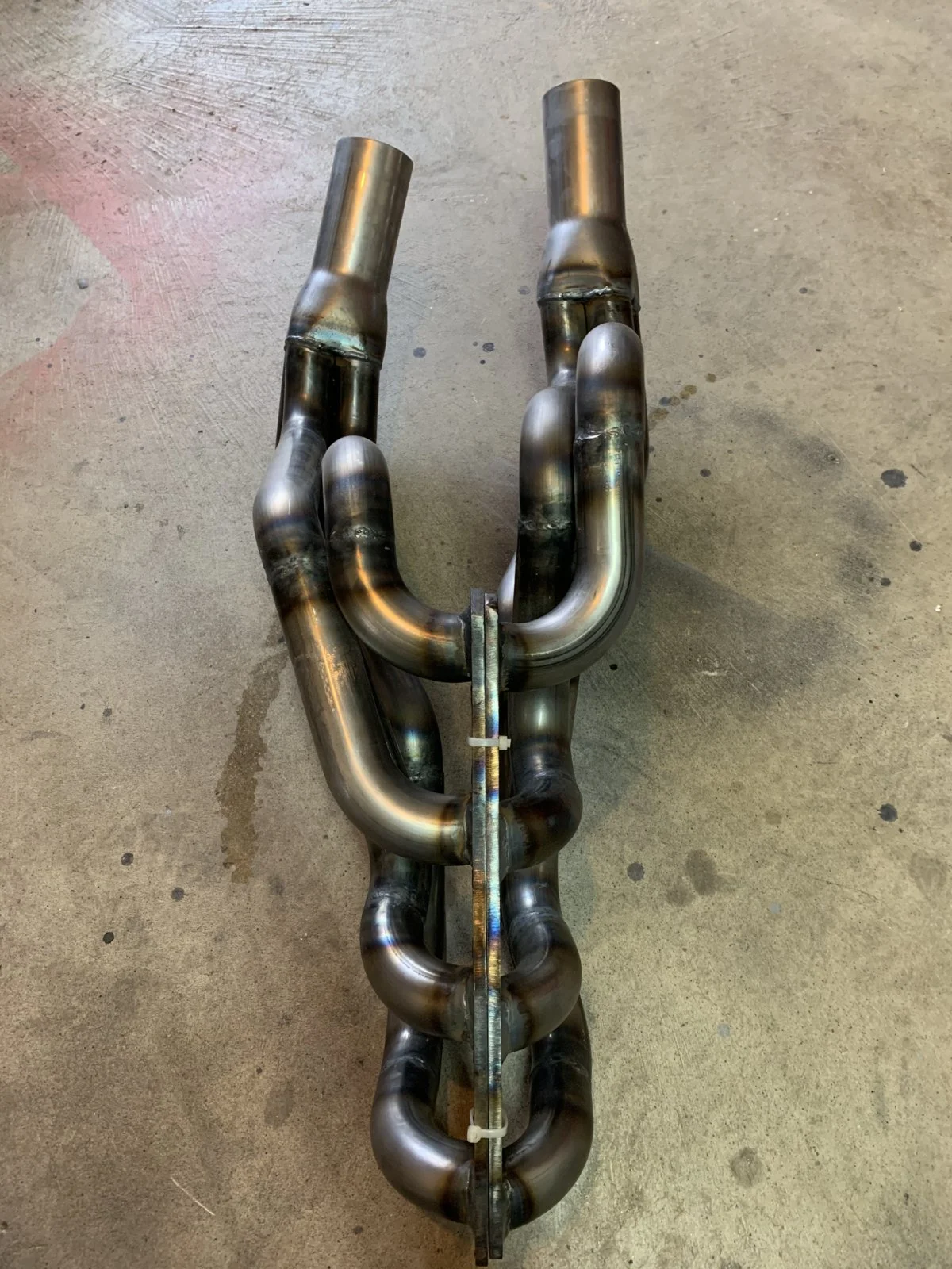

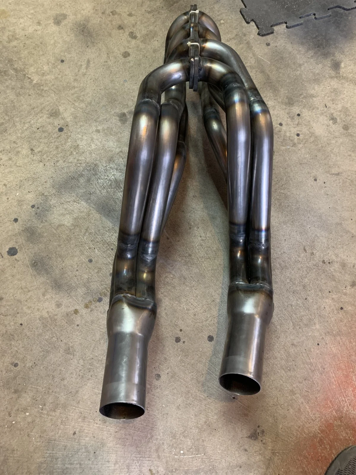

Here are photos of the headers I ordered for my 1970 mustang, 351 stroker with 225 twisted wedge high port heads and the Heidts mustang 2 IFS front suspension kit.
In both of these photos it is visually apparent that the collector for the passenger side header has been welded at to severe of an angle toward the center of the car. When mounted the collector points toward the center of the mustang.

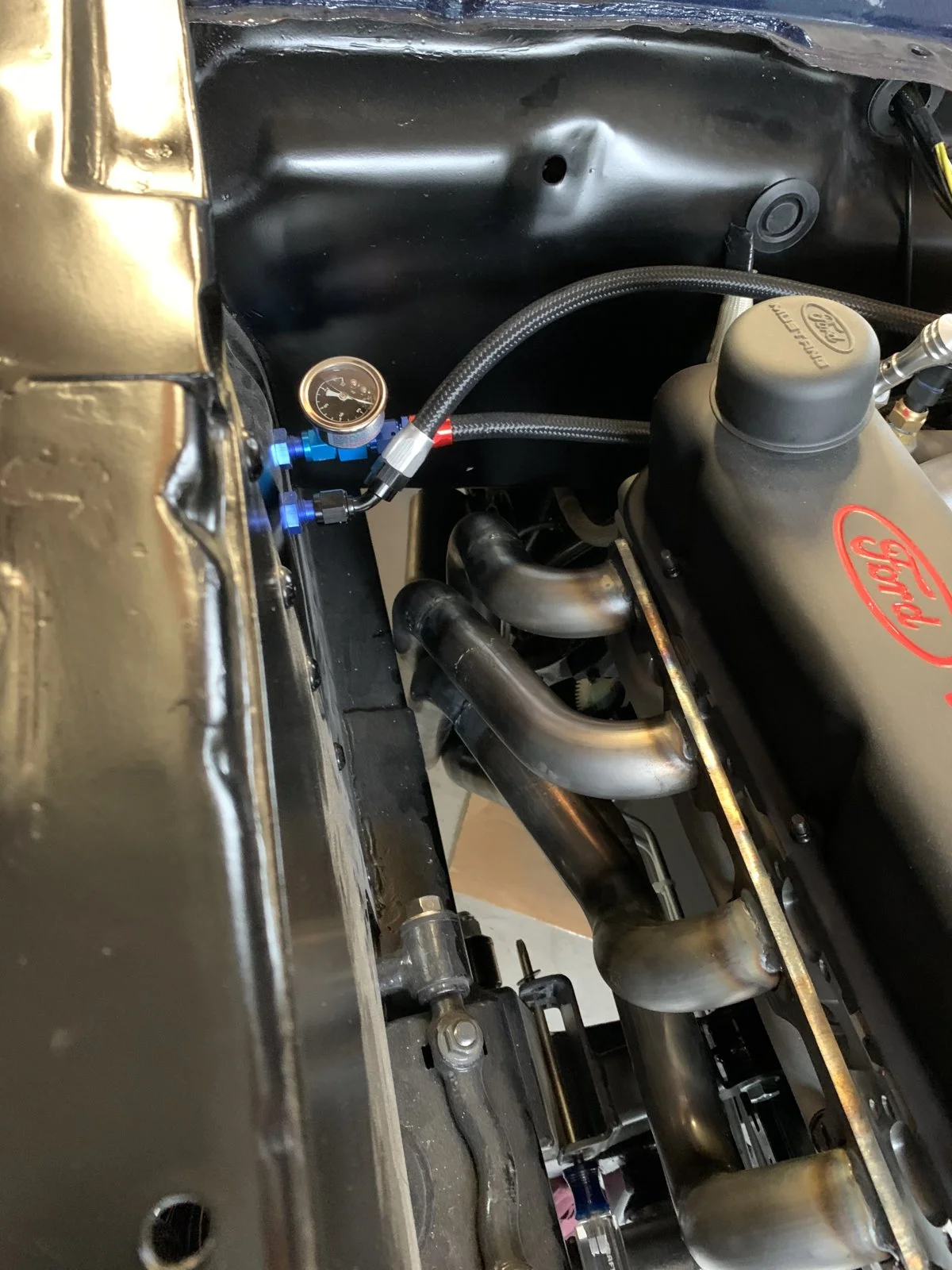

In this photo you can see that the header flange is prevented from mounting to the head because tube 3 is hitting the frame. This is about 4” behind where the Heidts mustang 2 IFS has been welded to the frame. You can see that the motor mount has been moved from being in the way of the header. Also notice that this is without having any form of header gasket even installed yet. The front of the header is still approximately 1/2” to 3/4”from the mounting surface on the head.
It should be noted that we tried to test these headers on a bone stock 1969 mustang with a 351W and they also hit the frame rails. This car is in the process of being restored to original. So these headers will not fit on a 1969 mustang that is in OEM condition.

Fair enough, Saberdemon has had his say. We built the headers that this gentlemen ordered. RCI Headers are built in a steel fixture, so they can be duplicated as people order them. There is nothing unique or different about the headers we sent him, and they were exact duplicates of headers we have sent to hundreds of other Mustang enthusiasts with the same year Mustangs. Somehow, other people say they fit fine in their cars. Saberdemon says they don't fit in his car. Either there is something different abut his car, or the engine is not in the OEM location. I don't know which and neither does he. We built and sent the headers out in good faith. If he had not been such a dick about it, I would have refunded his money, but he refused to return them. At this point, I'm fine with him dealing with some other company, and good luck to him...
