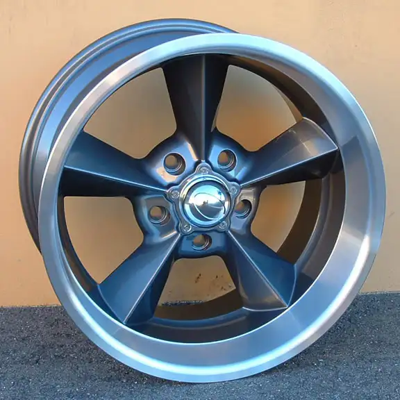

Discounttiredirect.com is the only distributor of the wheel. Here's a picture in gunmetal, I'm looking at the chrome version, but their website is down right now for some reason.

Those look nice, remind me of Coy's C-55's. I have Coy's C-5's on my '61 Buick Invicta.

Very similar actually. The price of the MB wheels are much cheaper though. $188 i believe for the 17x9.5. Free shipping too

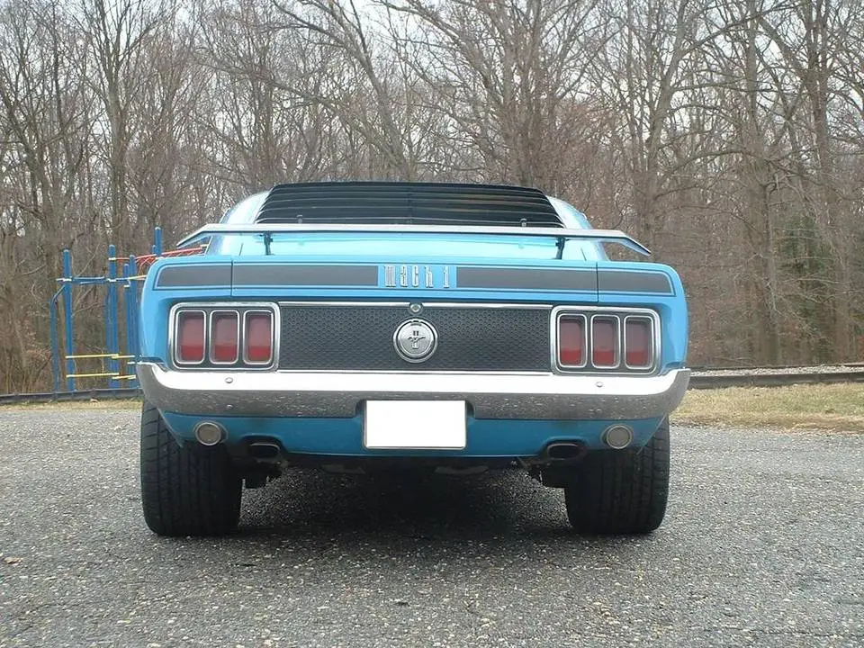

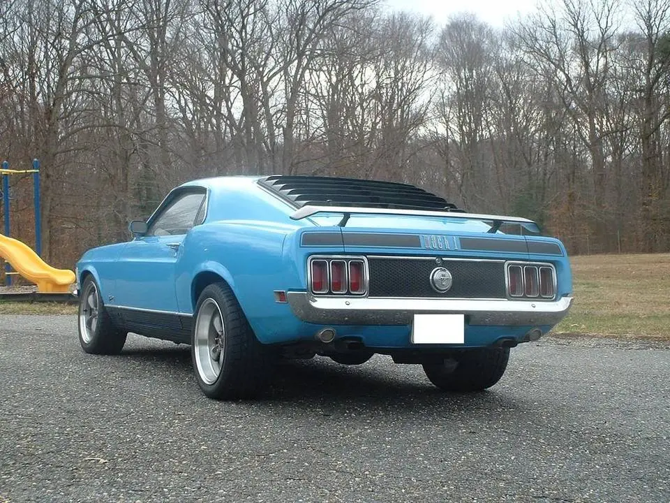

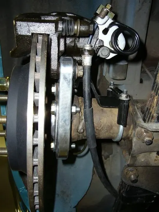

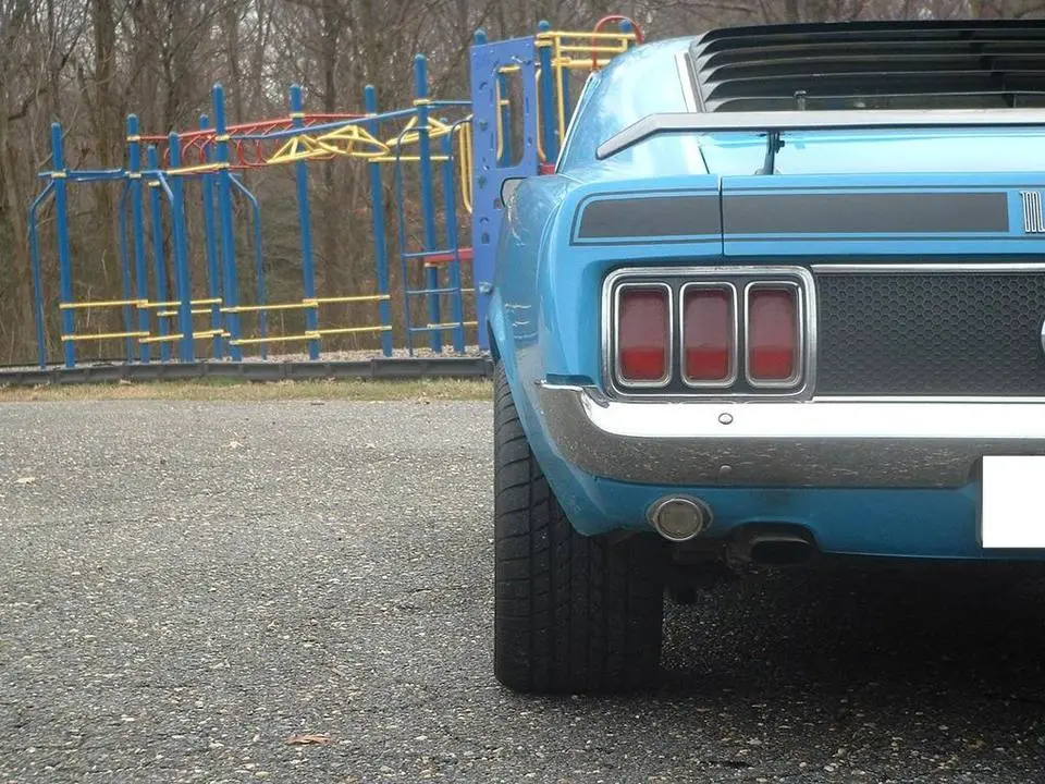

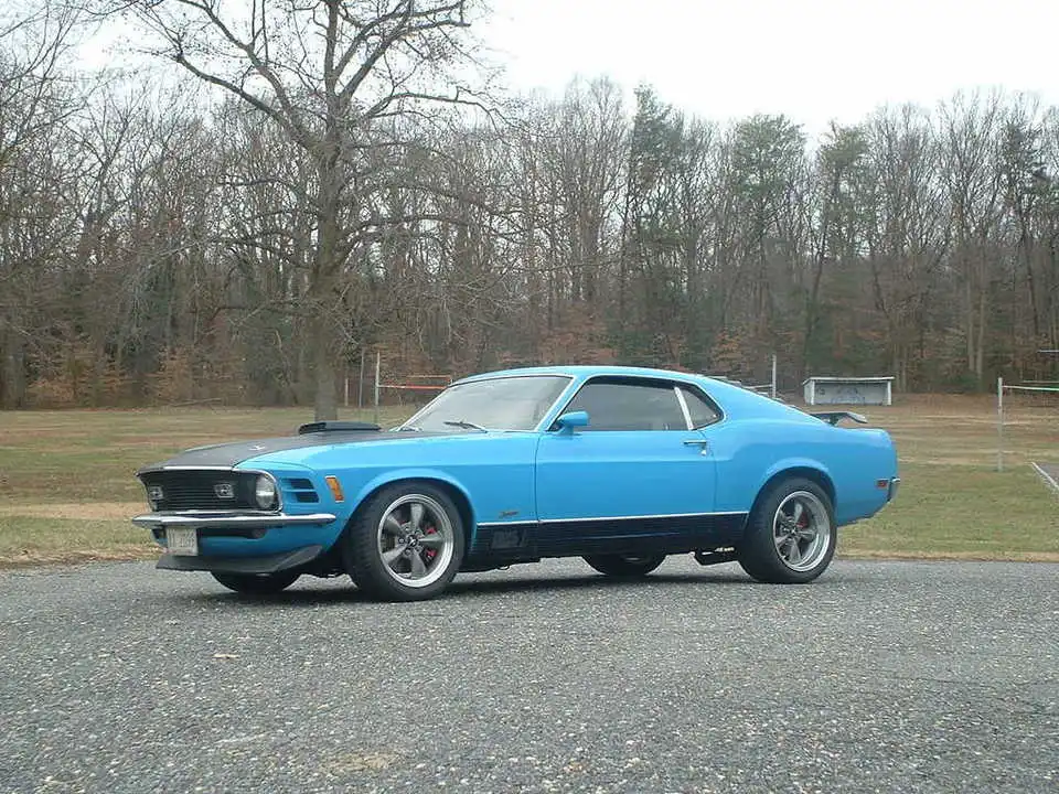

It depends on the kit you use. For instant the Vintage Venom kit I am using to run discs front and rear increases the front 1" and the rear 7/16", this doesn't include the thickness of the rotor hats. Here's some pics of mine with the Cobra brakes and 17's.

I was looking at the vintage venom kit, did you use the SN95 Spacers with the kit? I don't understand if the caliper bracket bolts to the axle housing why that would affect the spacing.
G
Grabber70Mach
Jul 6, 2003
305
17
Indian Head, MD
Mar 26, 2009
#20
  • Mar 26, 2009
  • #20
Yes I used there complete kit. The bracket bolts to their adapter which bolts to the axle housing. The hubcentric spacer fits between the rear axle and the rotor.
