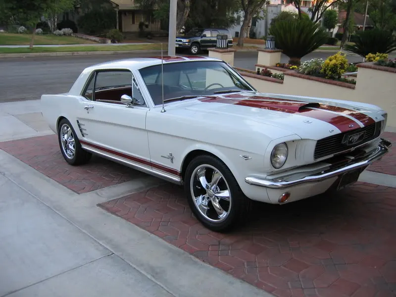

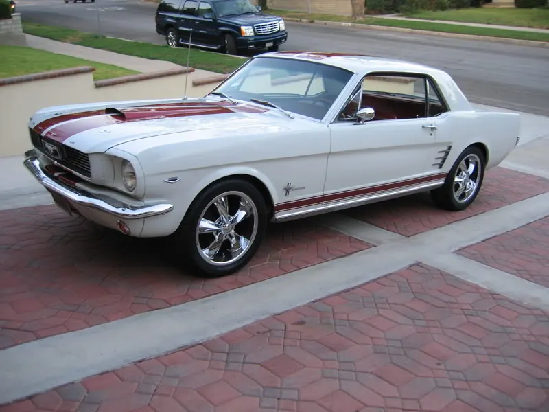

Got em today! man they look killer... they really completed the car, they look a lot better in person.

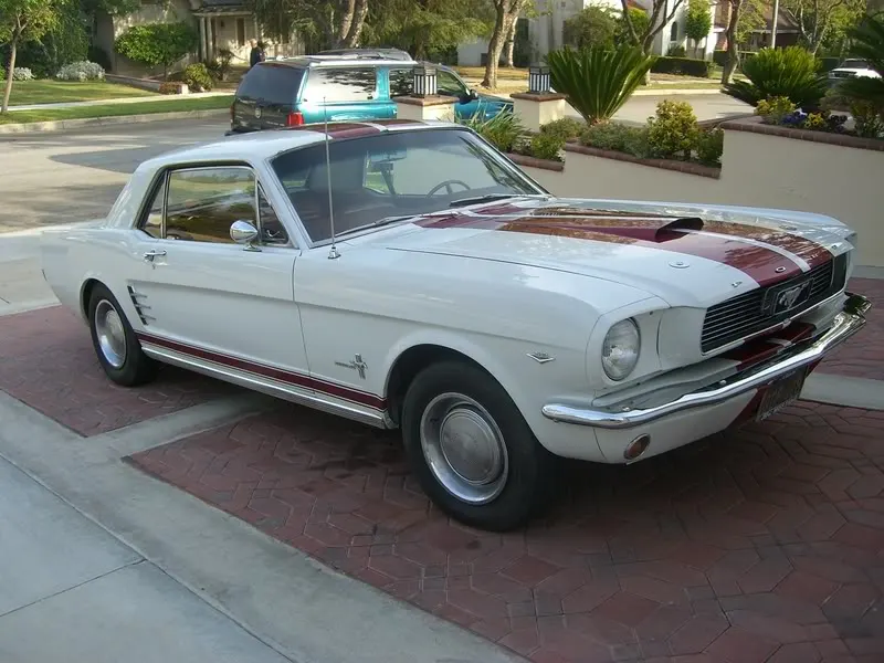

Before:
After:

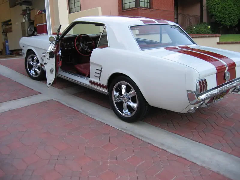

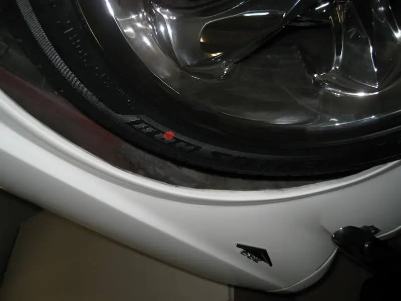

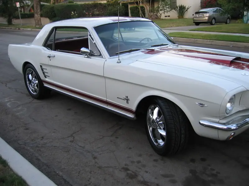

They're 17x7s with 215 HanKook tires wrapped around em. I am having rubbing issues when i go over bumps, but guy who installed the rims said i need to think about redoing the front end, he said hte bushings on the front right are shot.. anyone want to enlighten me on this and maybe the signs? The guy seems really cool but he still doesn't have my trust just yet. He works for overhaulin as previously mentioned but some of the comments he makes... i dunno
Here are some pics he took of it:

a 215 should not rub.The wheel offset is wrong.Regardless of a worn front end, the wheel should sit more inward and not flush with the fender lip to avoid rubbing.

+1. He gave you the wrong offset.

+2 on the wrong offset. Looks nice though.

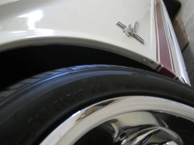

this how my 215's sit in the wheel well

Eh. I'm not sure, the rubbing never happened when i was driving, my dad claims he hears it though (i highly doubt it, even with the old tires, when i went over a bump you could hear the the front shocks or something up there go thump thump [I think he's just not used to a bigger tire look] ) . I can't find any damage on the fender lips and i think they sit just fine. The top of the tire is just inside the end of the fender lip...
When he ordered it, he ordered a 4.5 in backspace... he said thats usually what mustangs get. and on dodgestang's chart it checks out, #62. one person is running 215 on the front stock drums and suspension like me, without any issues. I tried to measure the backspace (it was a very rough attempt, a small piece of cardboard with a measuring tape (those flexible ones) taped on, and another piece of cardboard to draw to act as a line for the end of the rim. It was not less than 4.5

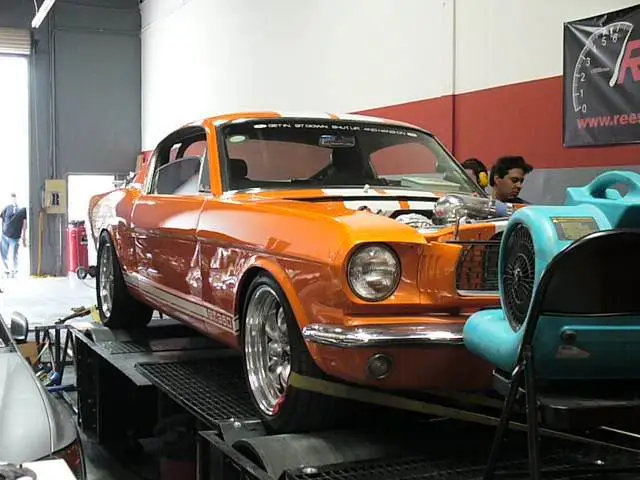

Marlon at fly ford runs 275s on 17s in the back and has no rub (forget his fronts, think they're 225), without any major fender rolling (or any mods to the rearend housing). I saw his car rolling down the freeway yesterday, was a good sight to see.
But yeah, 215s shouldn't rub with the right offset. But don't fret, I messed up and got the wrong offset with my 15s too. Fender rolling and a rear sway bar fixed the issue for now.

So i drove it around this weekend (before i messed it up [another thread]) and it was great! I went on a 60 mile drive it was fine, on the way back on the freeway i hit an unexpected bump. I heard a pop kinda sound. Came home, inspected it, the tires rubbed.
So, i'm guessing the shocks are shot. when i replace em, i think i'm gonna raise the front a little, just to be on the safe side. Or should i roll the inner fenders?
P.s. the rub was on the way inside of the fender well
I would just roll the inner fenders. Shocks aren't gonna make a difference really (i mean, if they're shot replace them, but ride height is gonna depend on springs about 100 times more than shocks). I don't think that will help much, if at all.
