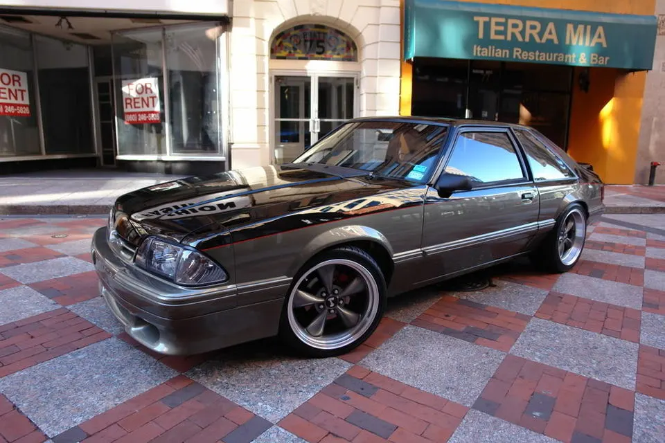

rims?
ya. i think thats what 25th has
but it also looks like he's got 91+ fenders....they give an extra 3/4" of clearance so you may have to adjust tire size accordingly...im certain they'll still rub at a hard turn...my 17s with 45 series tires rub the front ground effect part that wraps into the wheel well
stick with fox length axles and roll the fenders. you should be fine. If you go with an sn95 rear then you will most likey stick out too far and cause severe rubbing issues.
