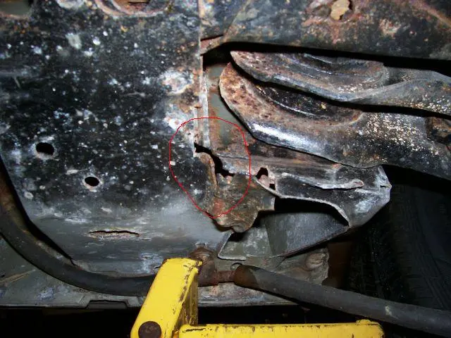

Just bought mine and found out the passengers side rear is torn and looks to have been that way for a long time. Previous owner drove it for a year. Here is a pic.

My passenger side upper ripped all the way off the car..luckily not while I was driving..I have another friends turbo mustang (has gone 8.30s) and he ran stock suspension with stock torque boxes until last year he ripped the uppers off going down the track..he came back around and the tires were resting against body of car...got lucky as well..I put wilde rides kit in my car and he is running wild rides adjustable replacement kit...I know UPR bolt in/weld in kit is pretty nice for street car and cheap too...
