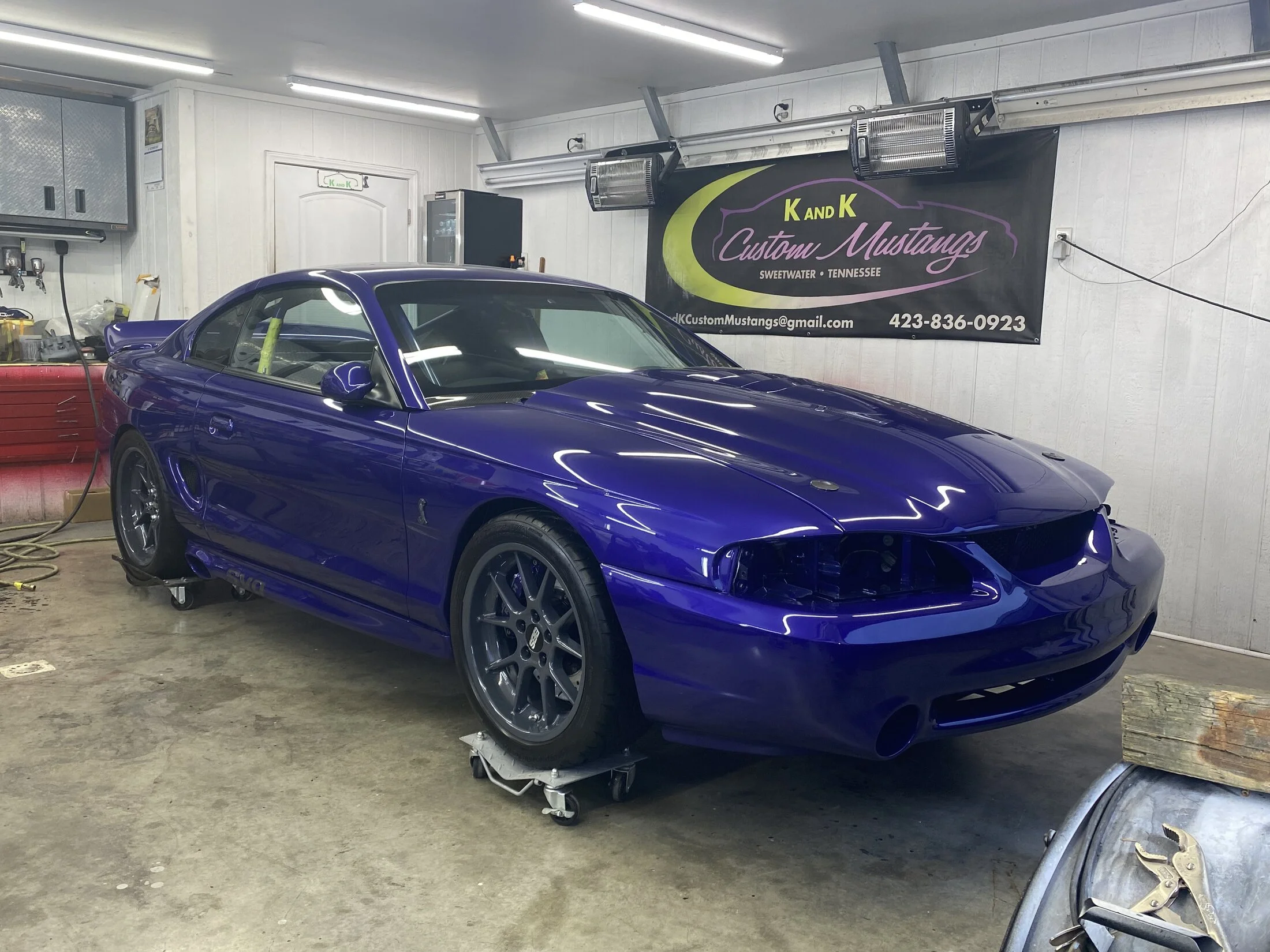

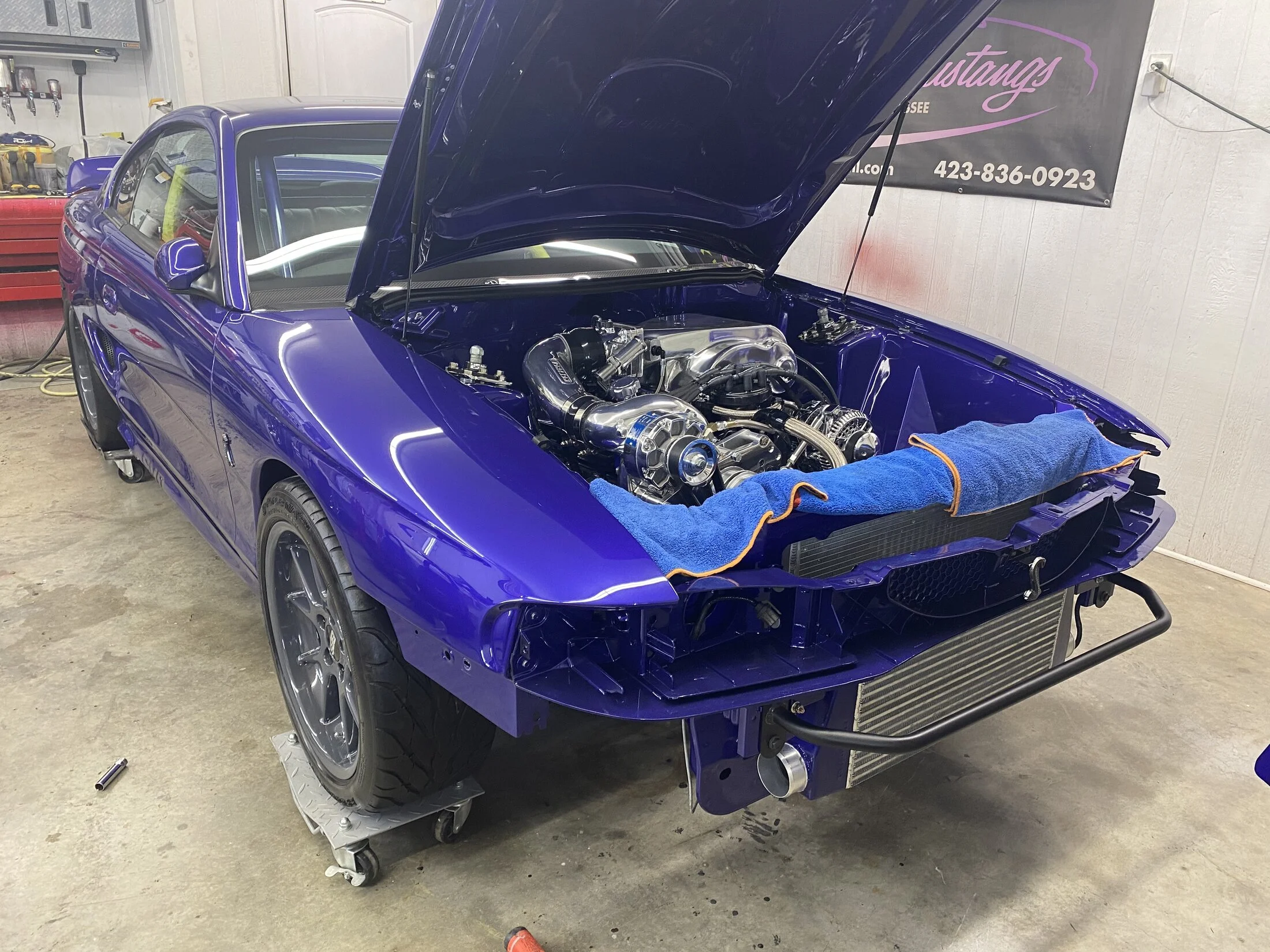

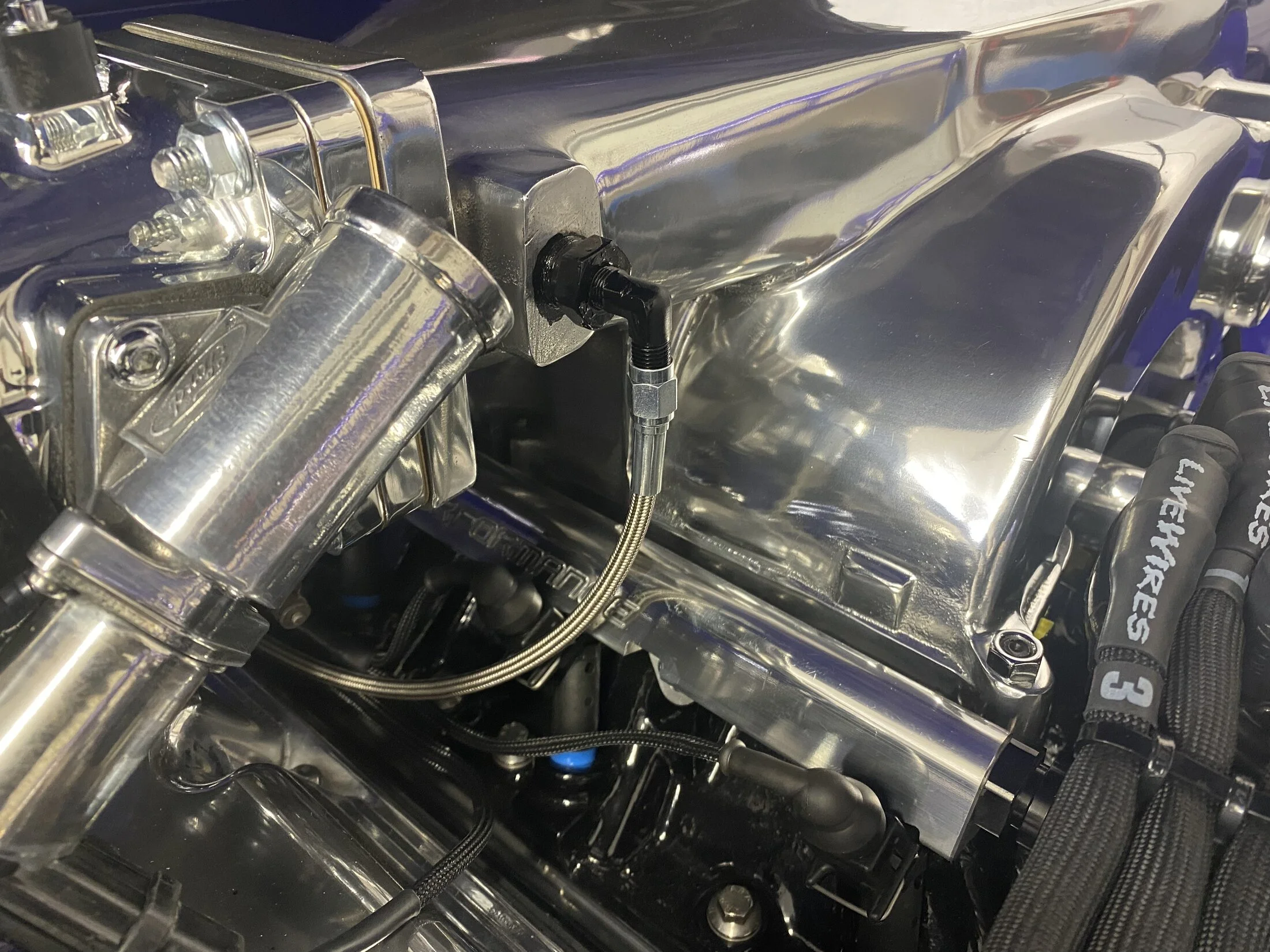

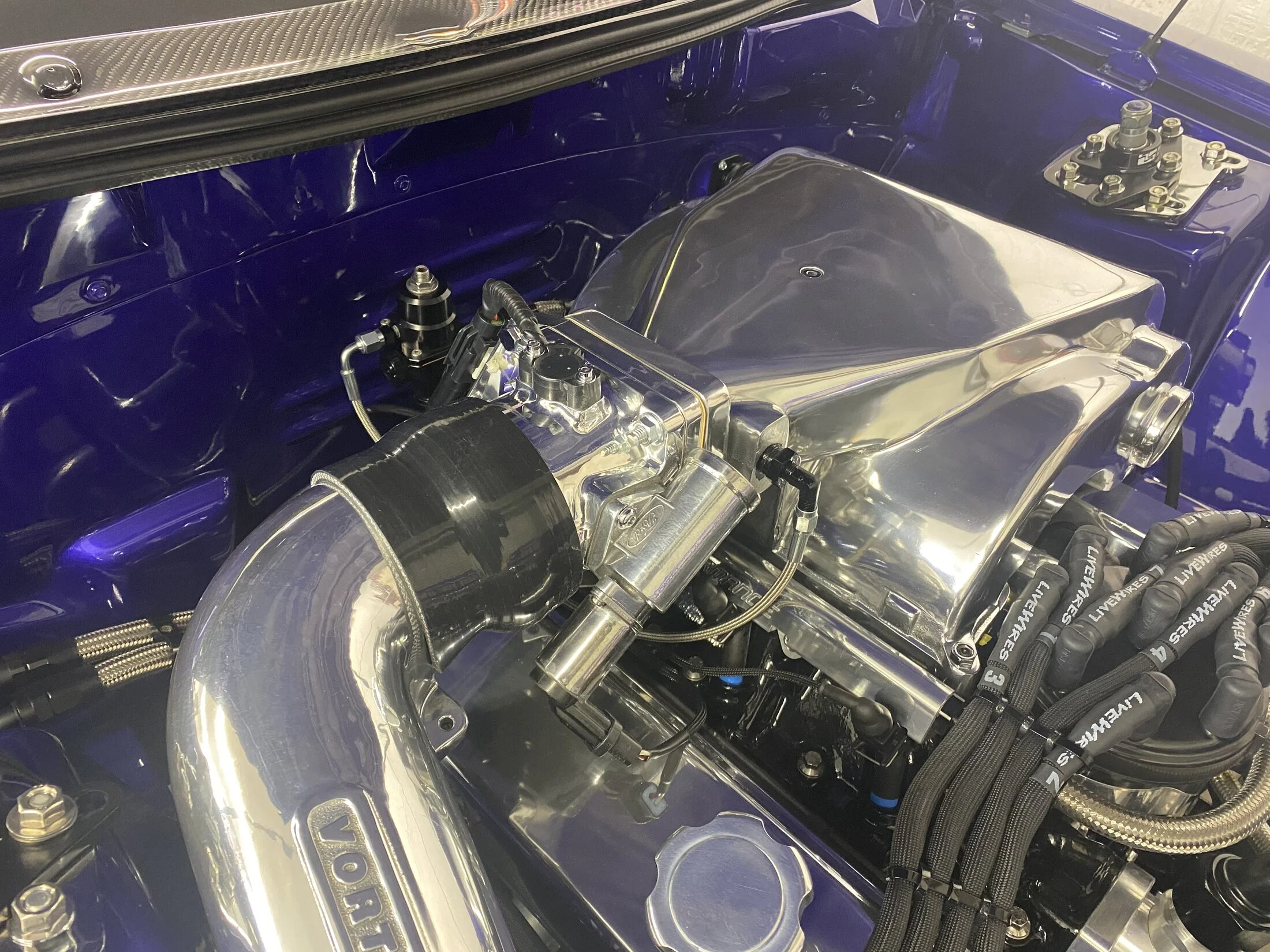

Last engine connection made.
Now to focus on getting the interior all together.

Are you planning on having the engine running before the show or just drop it off the trailer and push it around where needed?
I’ll have it running with a startup tune but it will be in engine break in mode anyway for a while so wont be seeing big boost or power till dyno tuning. After the engine has some time on it.

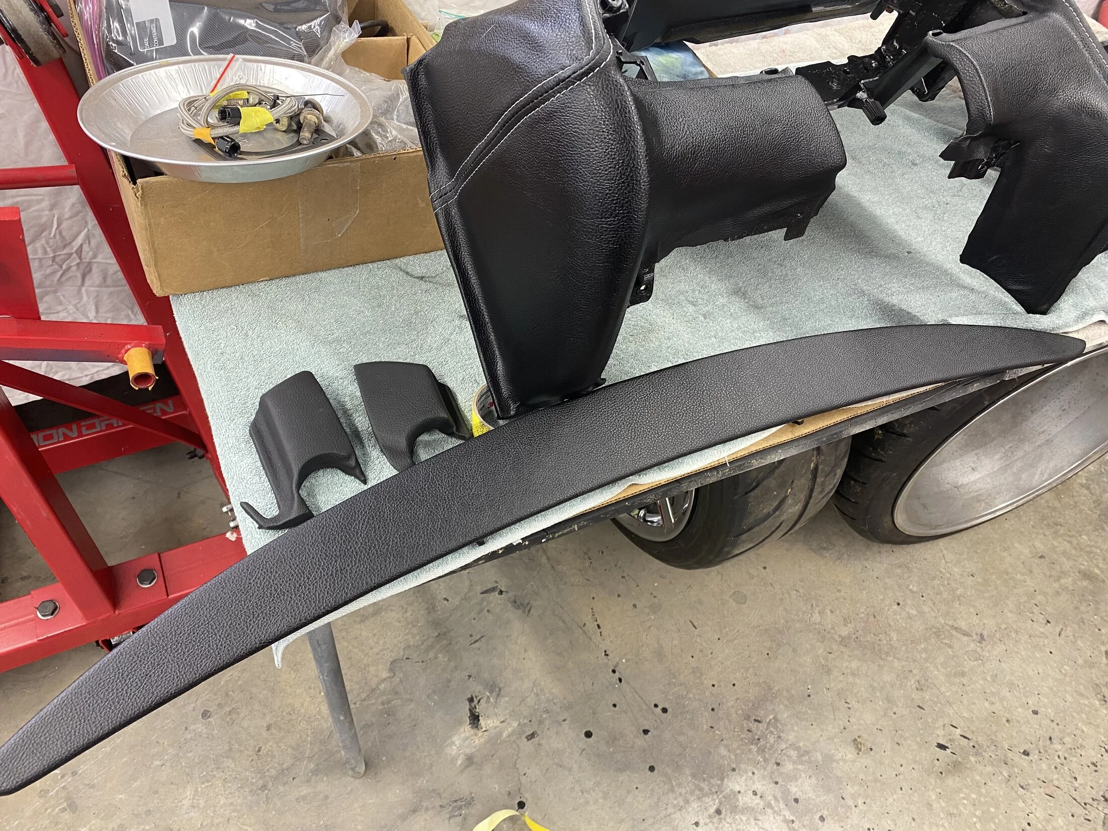

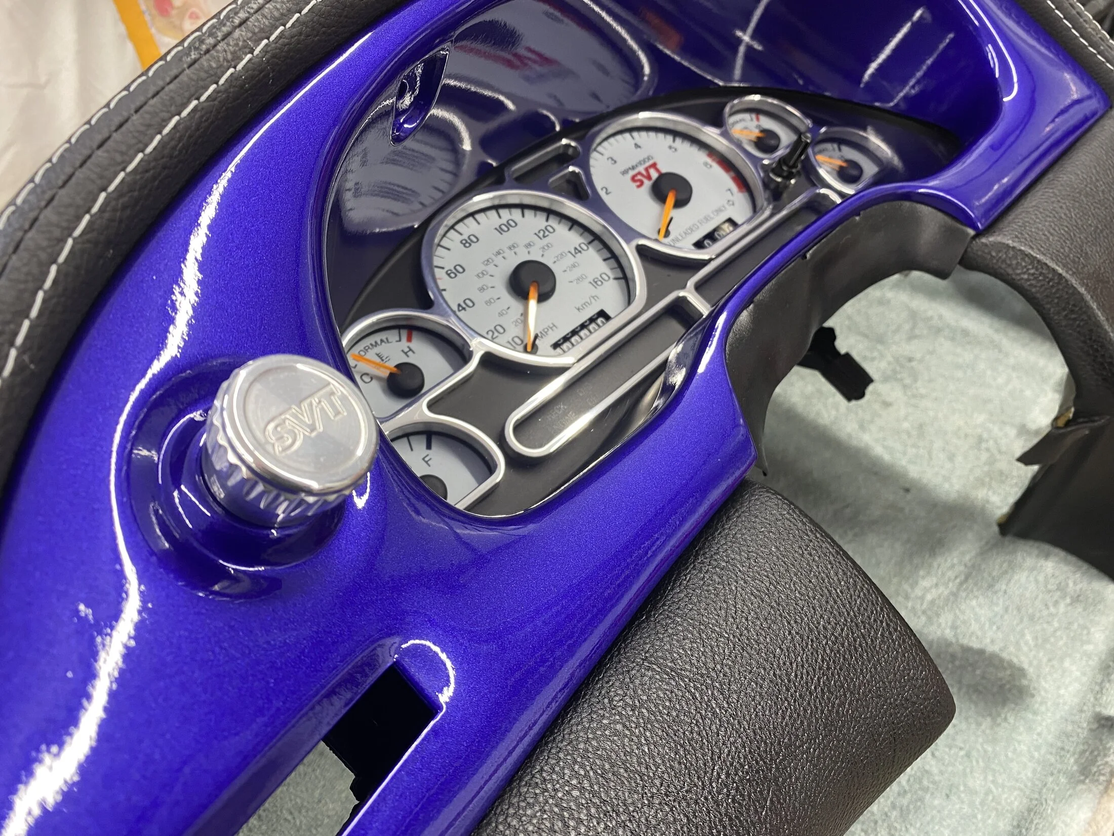

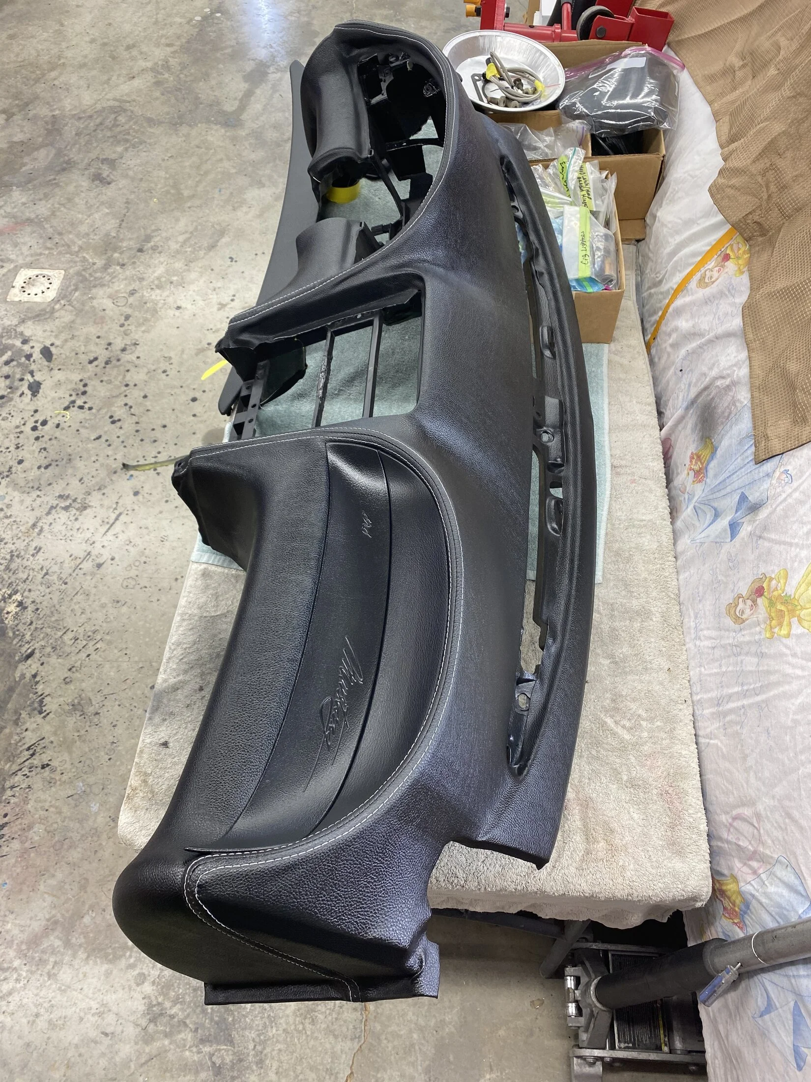

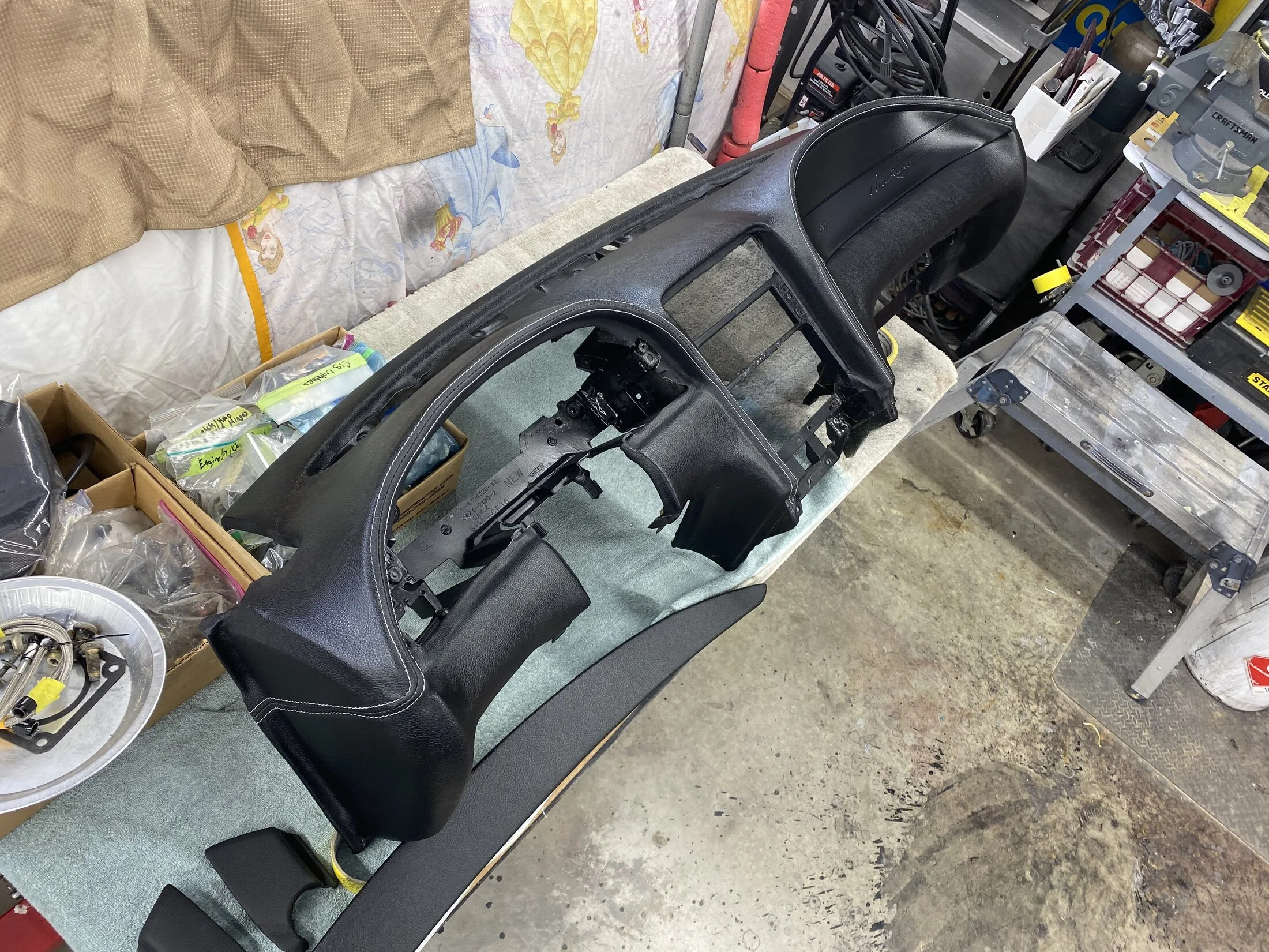

What a pain this was…This dash project feels like a build of it’s on.
Reactions: KZGUNS, General karthief and RaggedGT

That looks fantastic, and a massive PITA... I don't need that on my build.

How heavy of a machine does it require to do the stitching?
Thanks man. Im never doing another one anyway. Well. Thats not true
Need a commerical/industrial grade specifically setup for leather work.

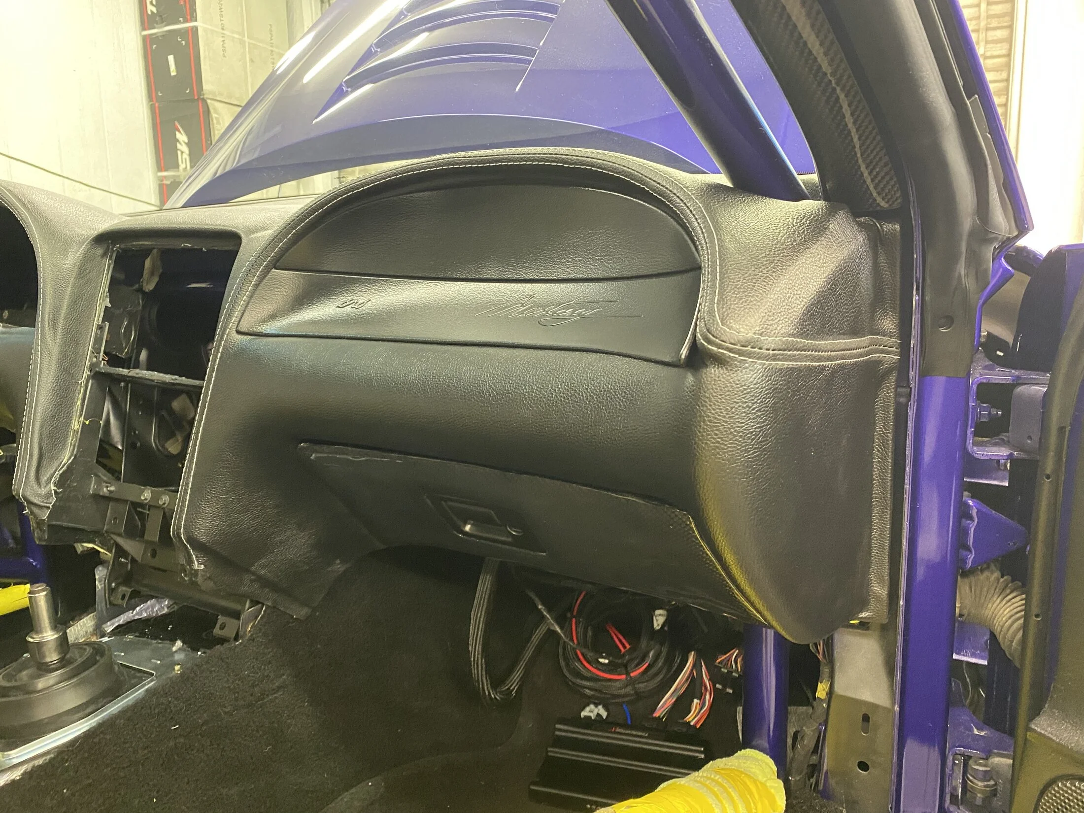

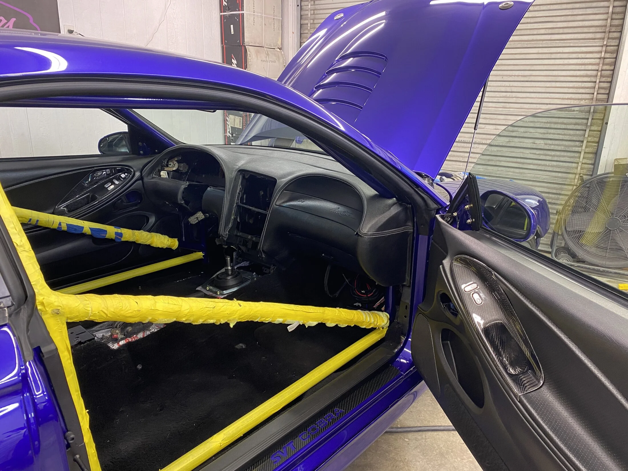

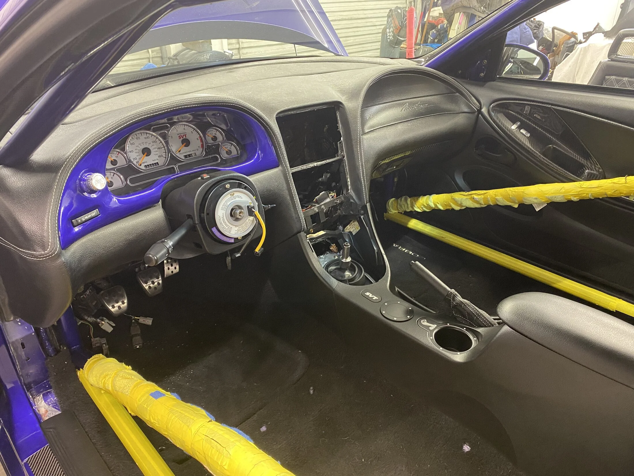

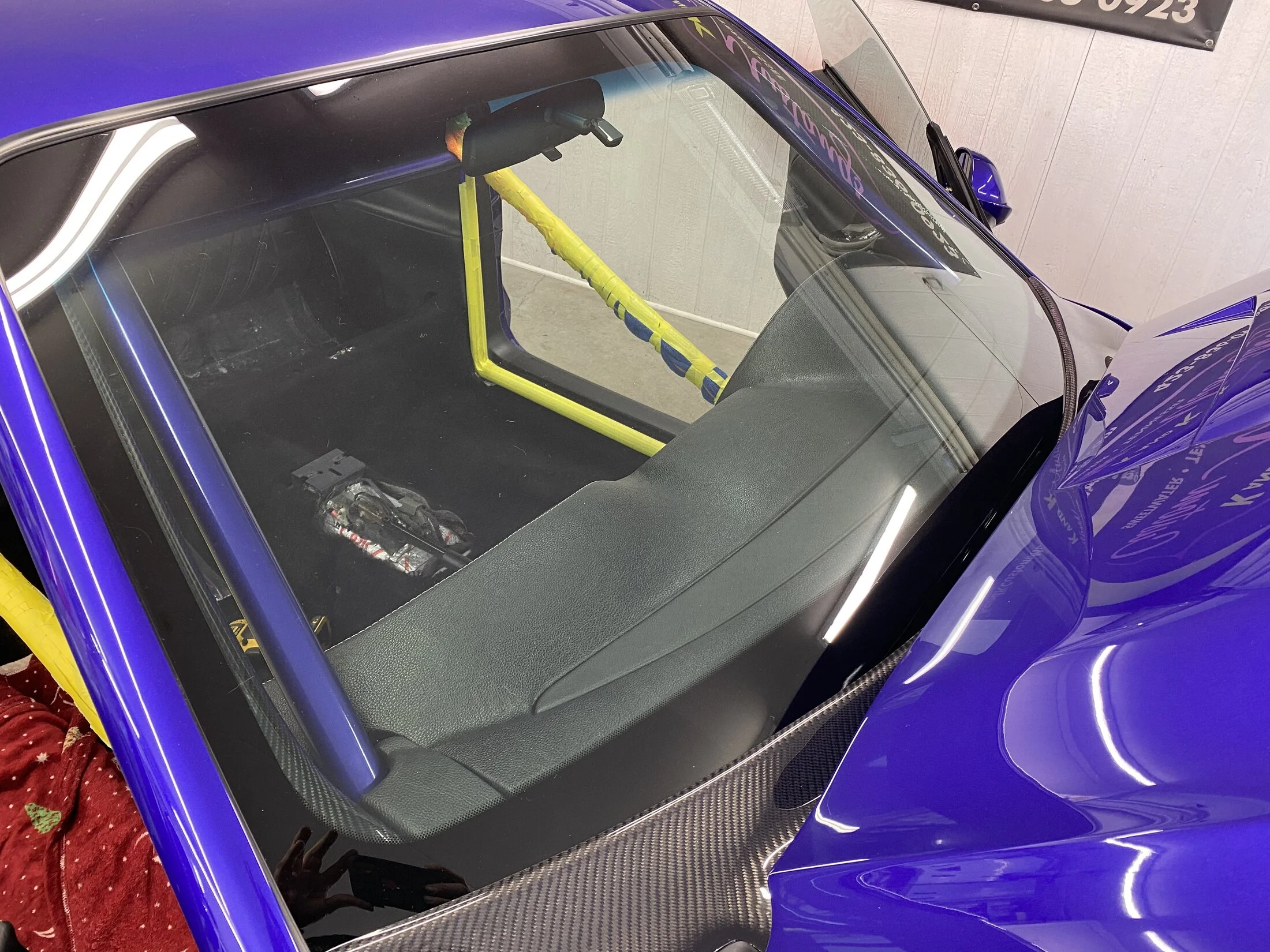

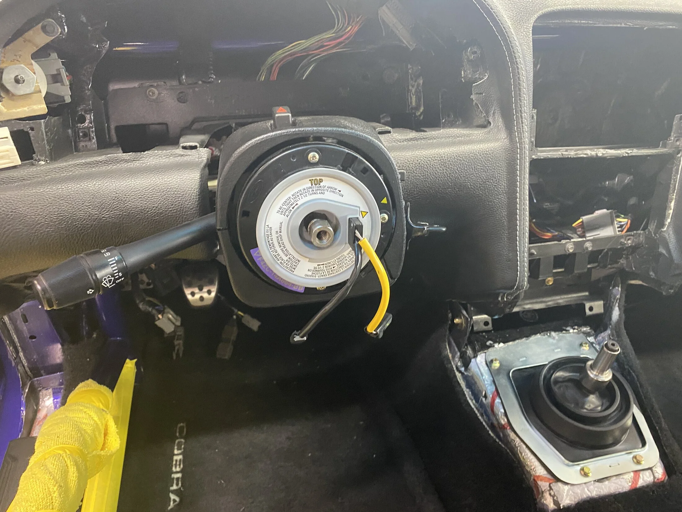

Its in. I could have painted a car with all the hrs I have in this dash project. Had to remake the metal dash frame to go around the cage but since I had to…I went ahead and made the dash/frame tie to the car and cage.

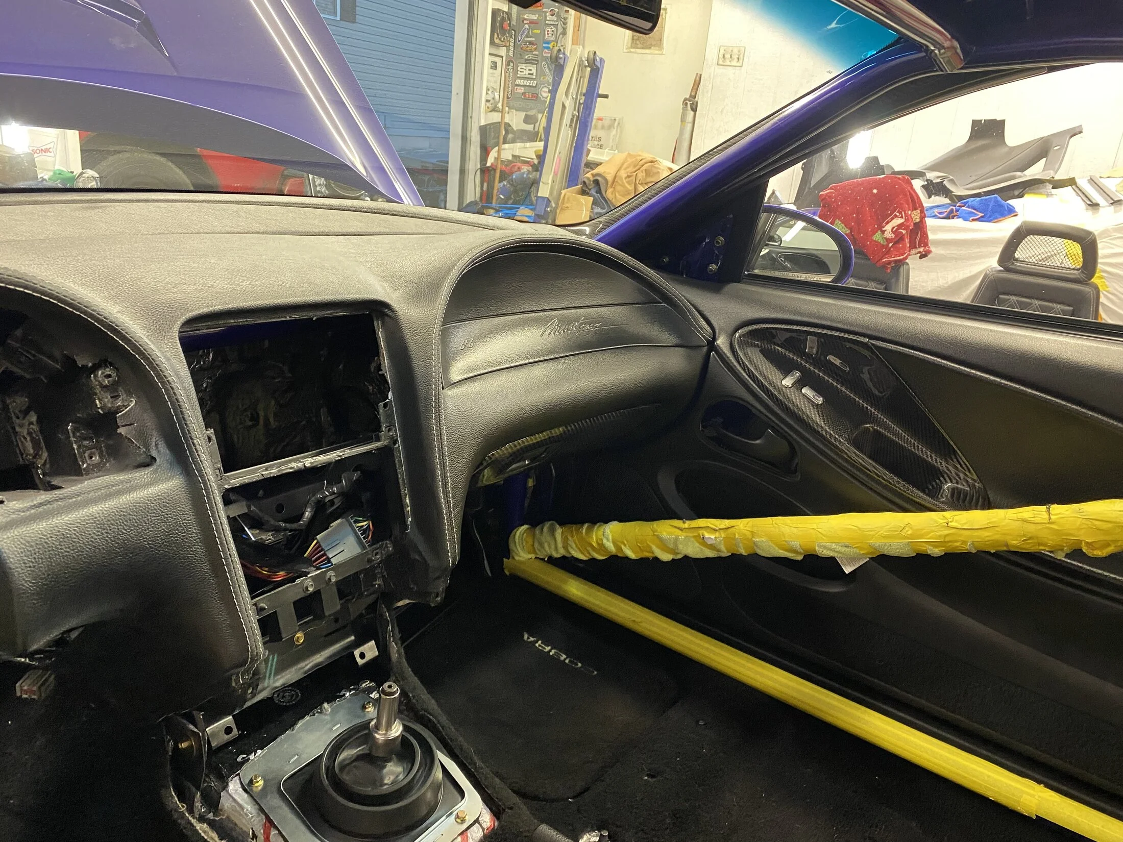

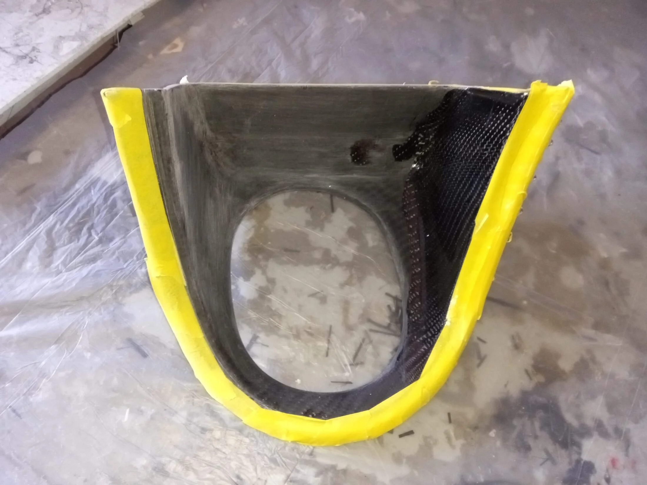

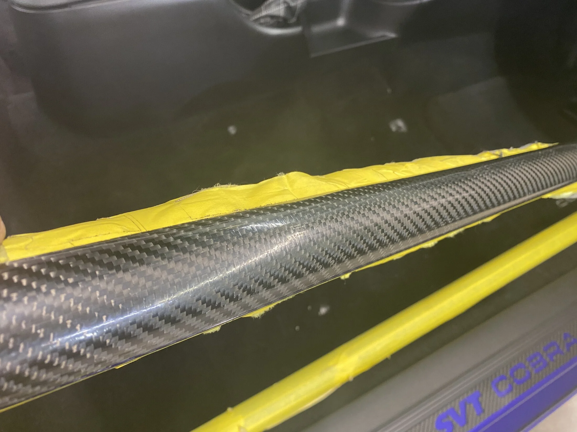

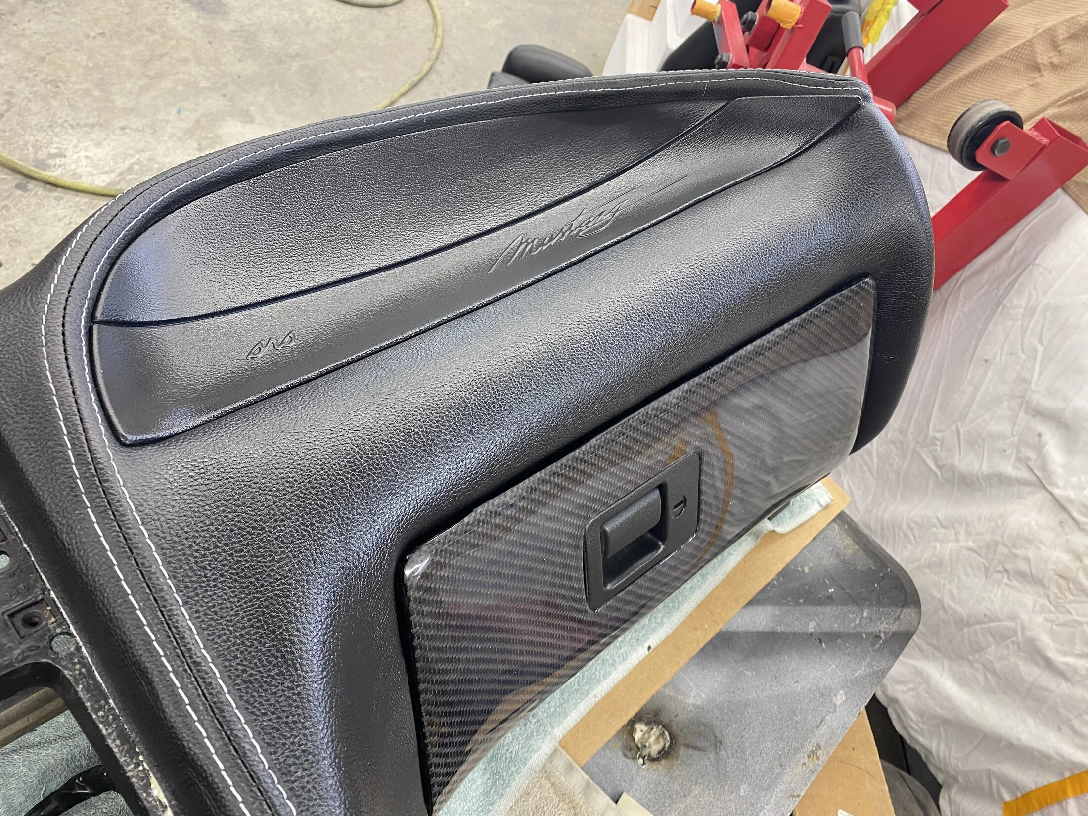

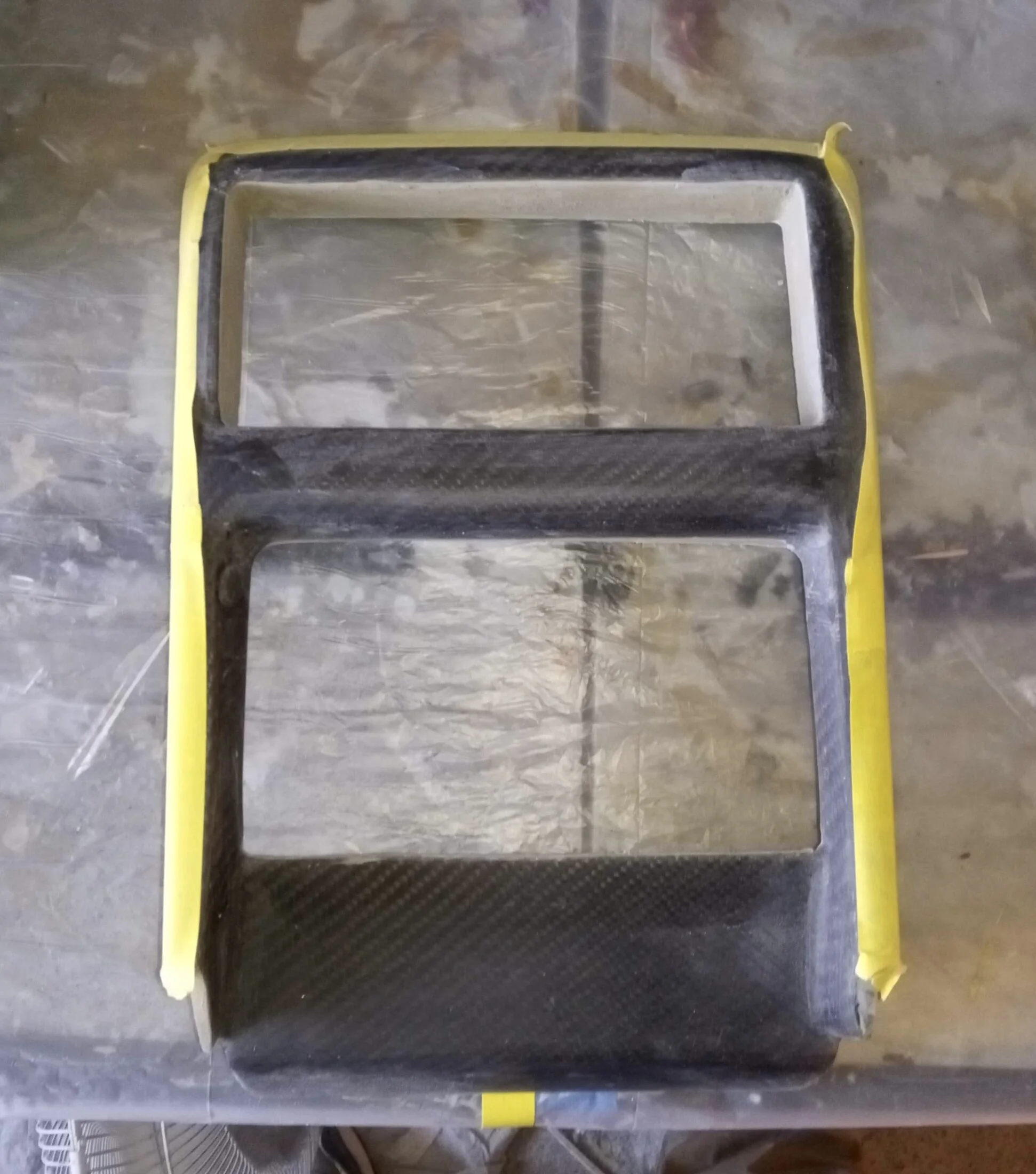

I got the carbon fiber custom center bezel and matching shifter bezel made.
Just sanding and clearing at this point until its perfection. Dont know if I’ll be done with by show time and Im not rushing.

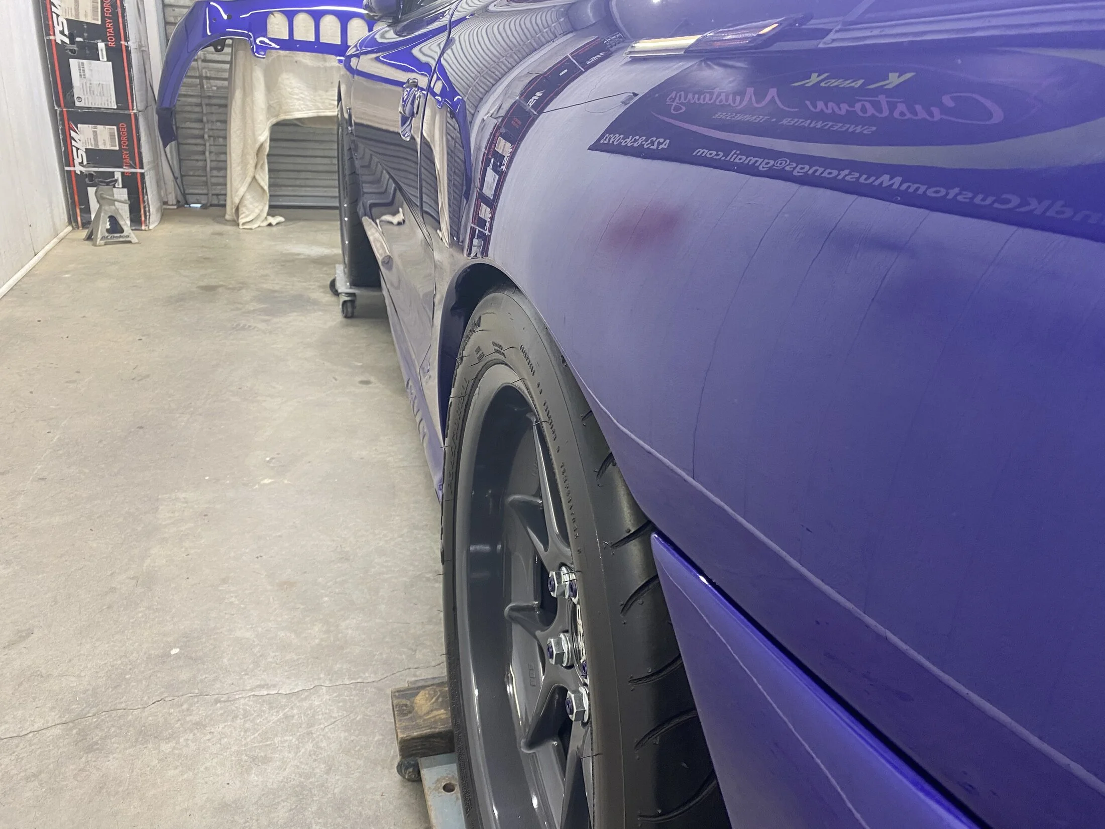

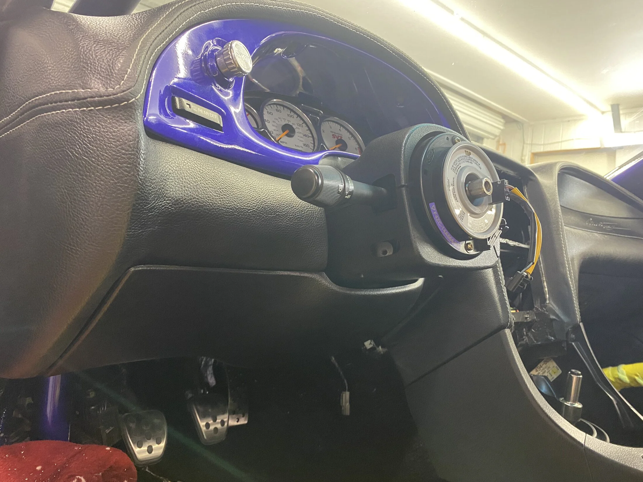

Steering setup is done. All connected. Steering wheel will go back on after seats are back in
Initial Alignment and bumpsteer is set. Caster/camber set to -1.5 as usual.

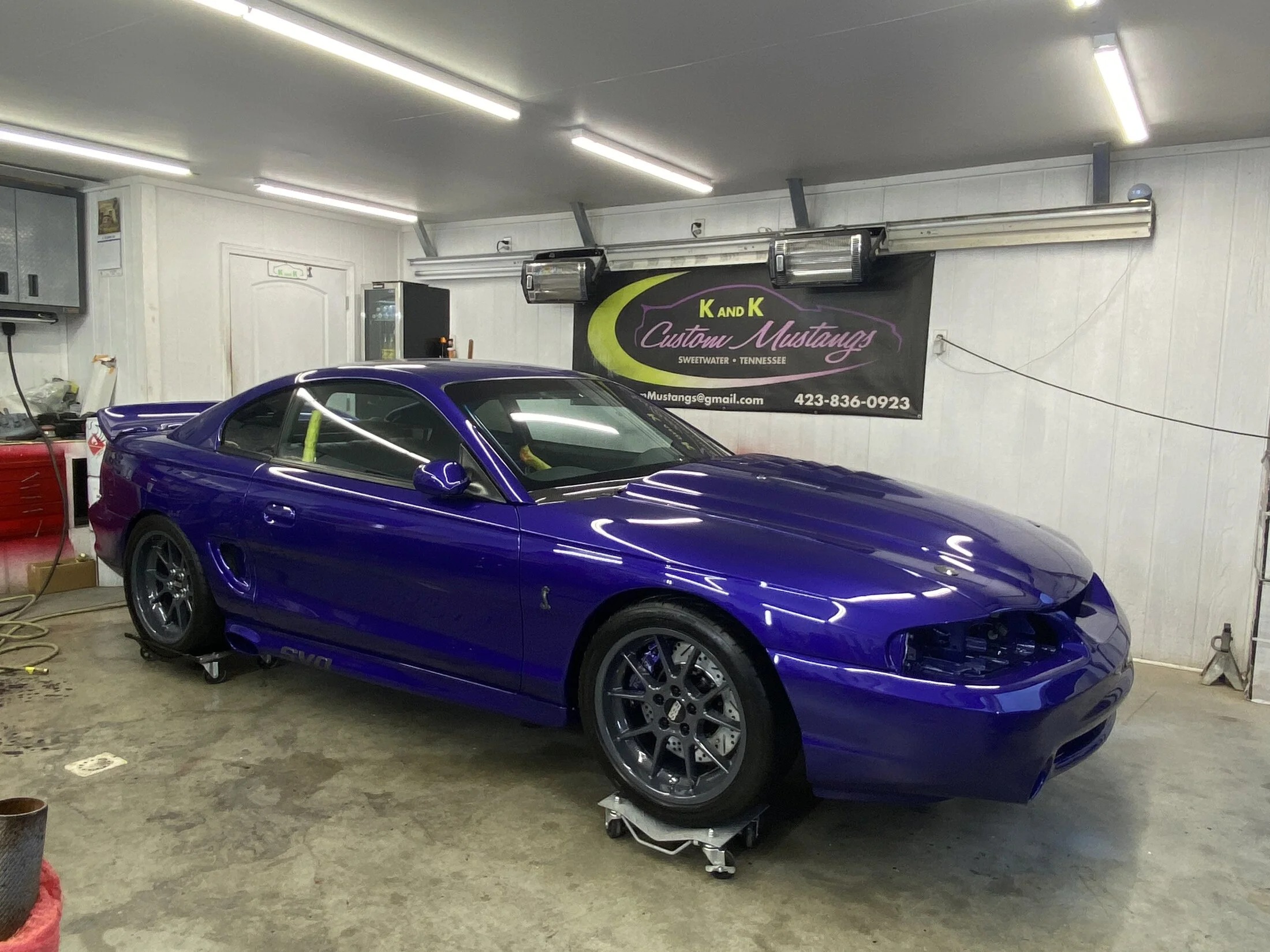

Checking more off the list. 2 days left

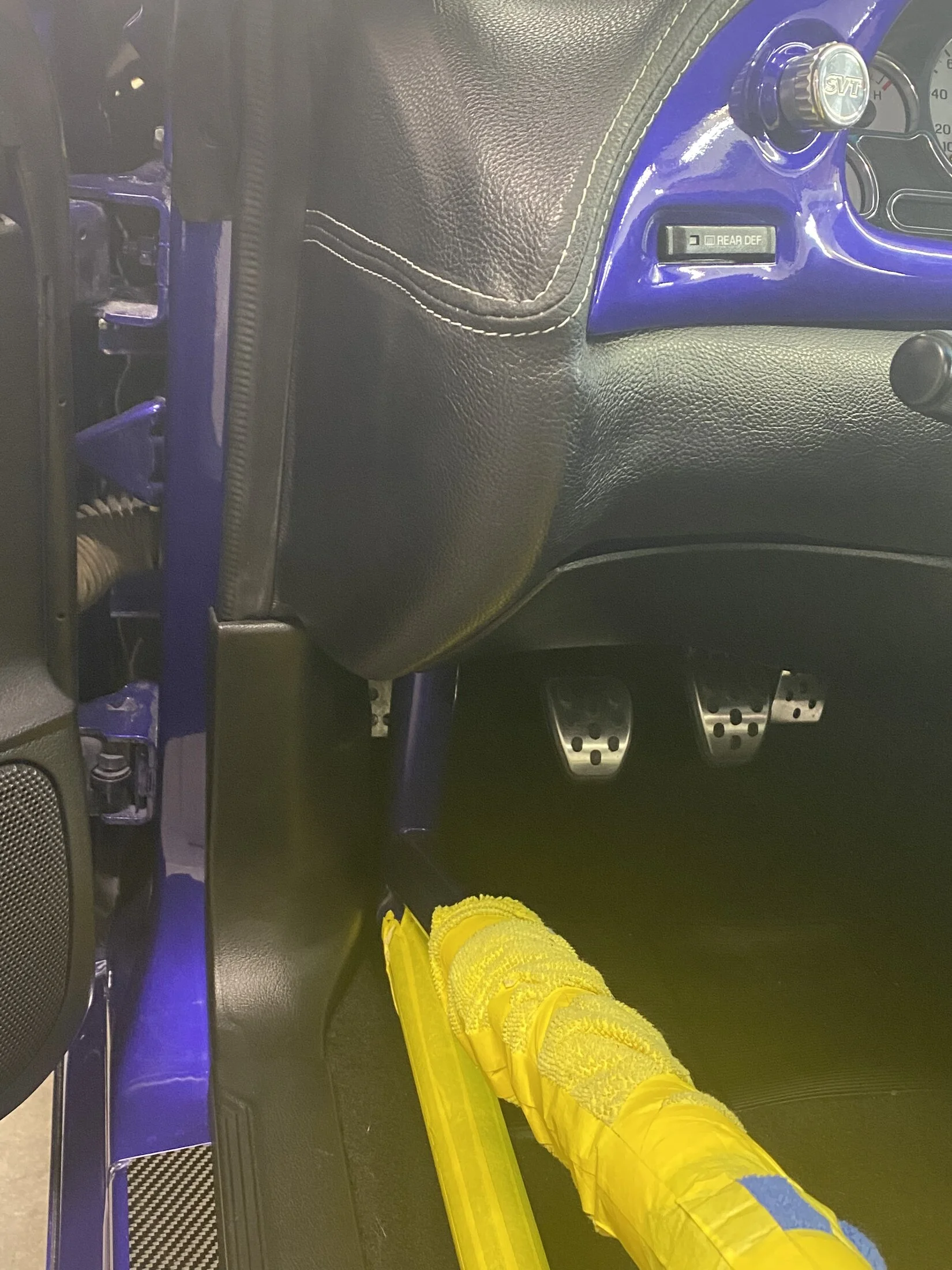

Ah man, no custom stitched leather on the column surround???
Now ya did it!!!!

He still has to make the leather covers for the rollbar
Either that or you'll have to enter/exit wearing a bunny suit

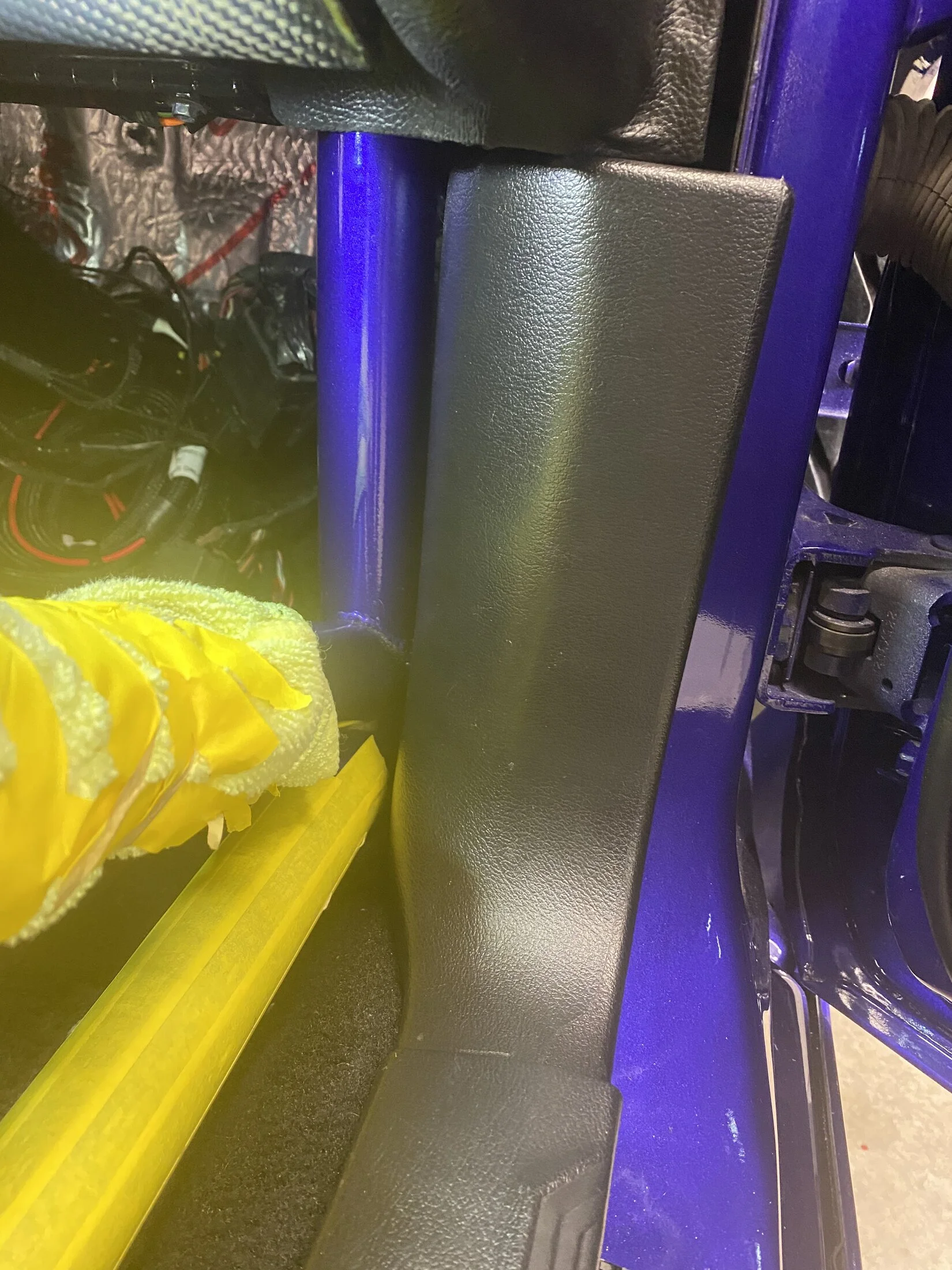

Already there. No bunny suit needed

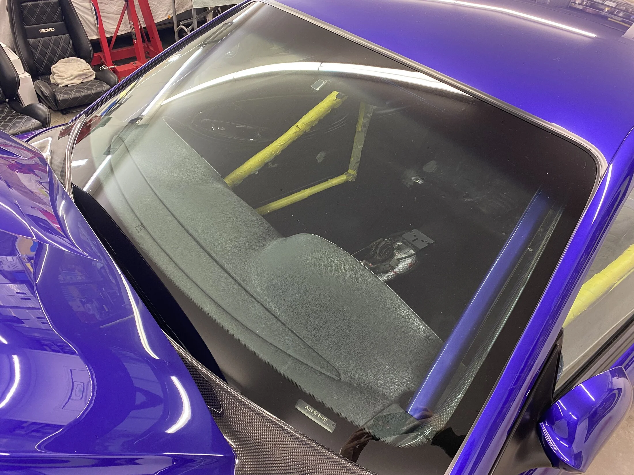

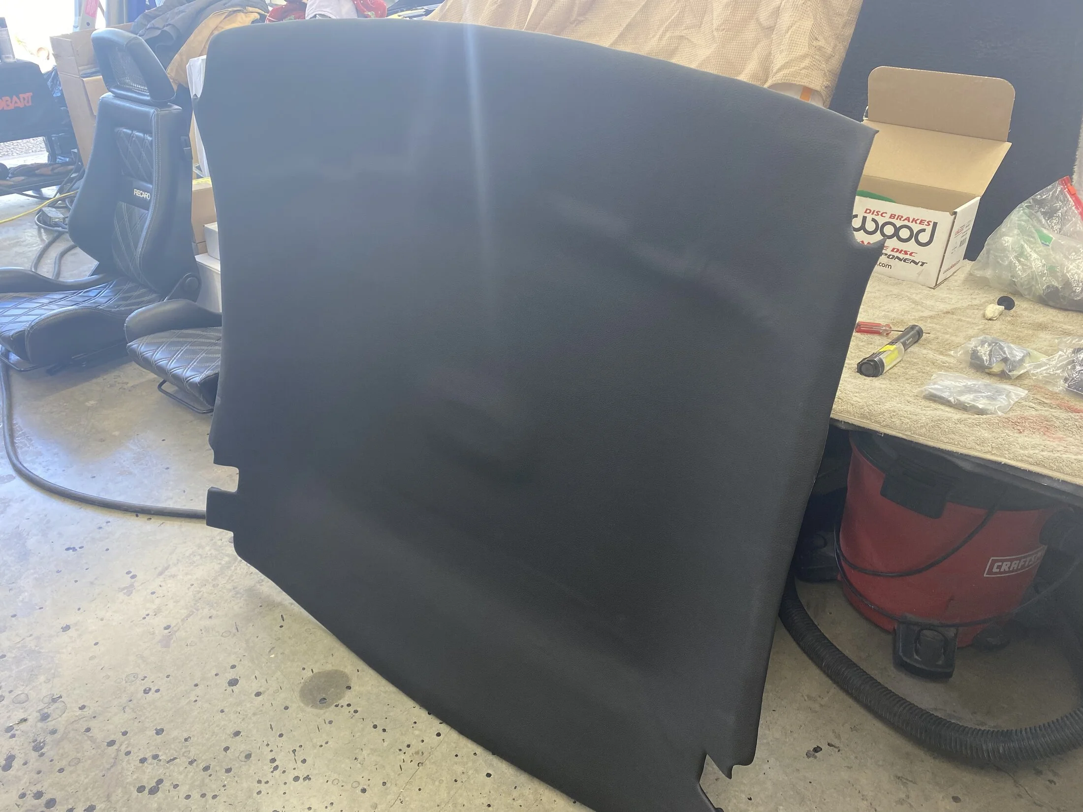

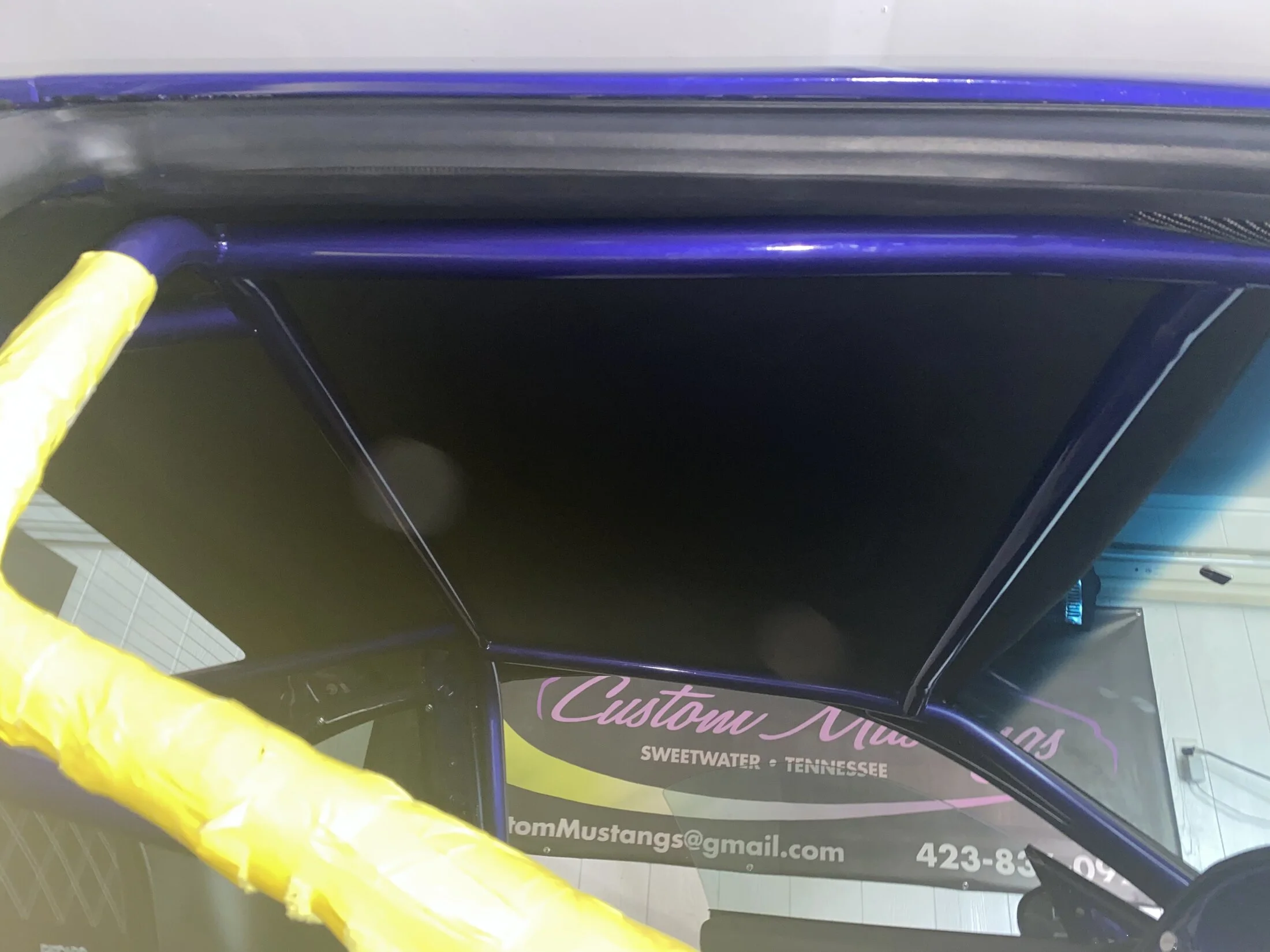

Nice and tight fit. Getting that headliner in around a 10 pt cage was really fun. Lol!
