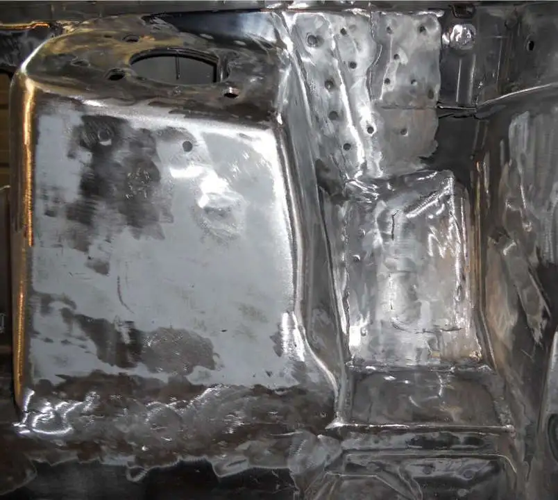

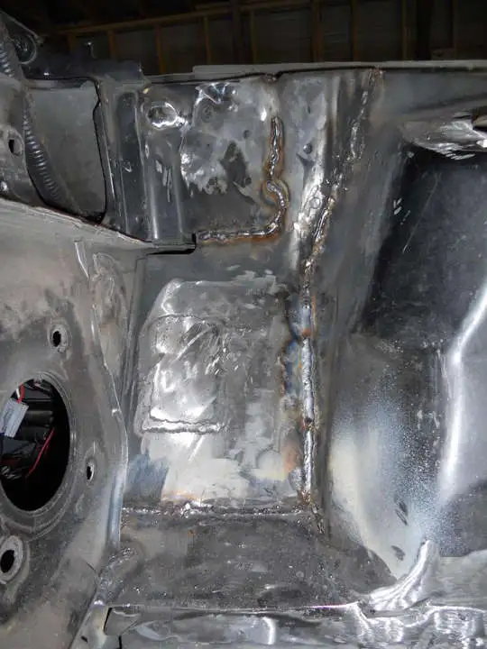

More smoothing of welds.
I'm going with the more metal work equals less mud work.

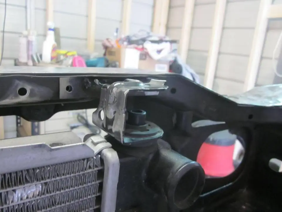

Modified radiator bracket to close up a couple extra holes. Now it matches the other radiator hold down.

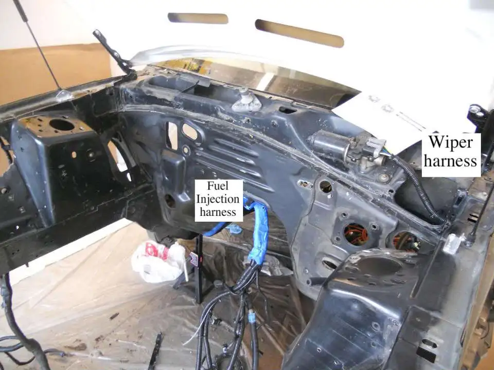

95steedamustang said:
You've sealed up the holes the engine harness goes through the sheet metal. Don't know if I missed it, but are you going carb or going to run the harness differently?

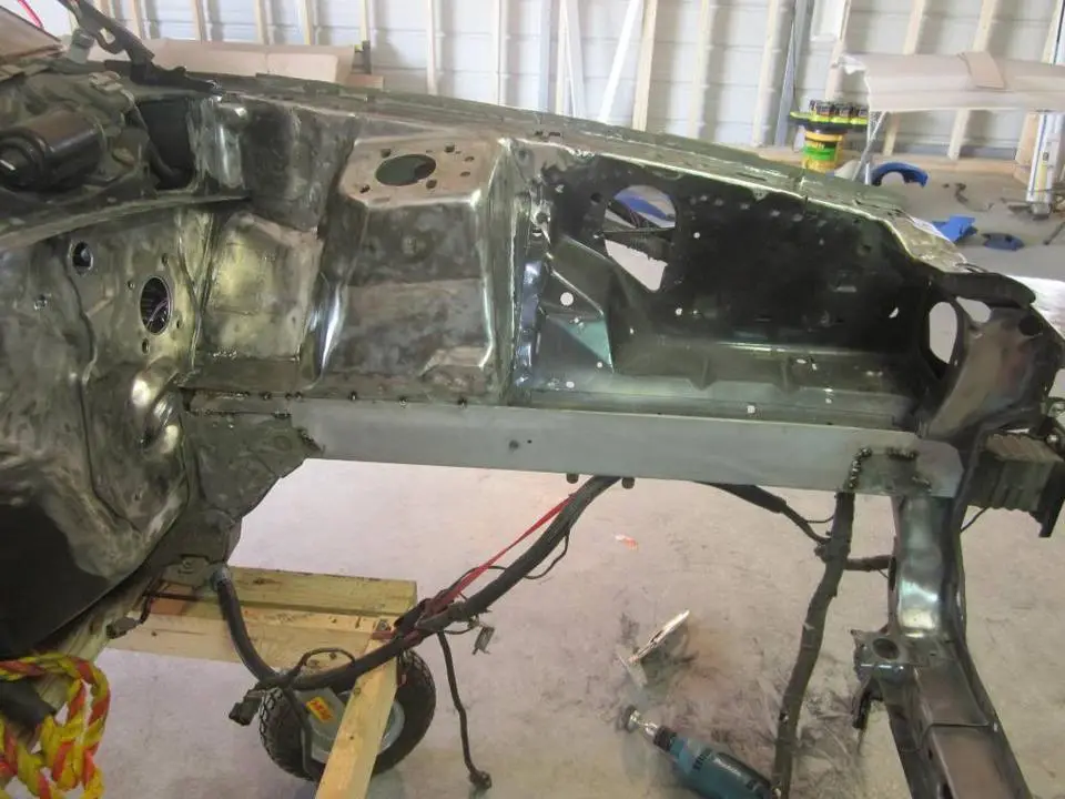

I'm running fuel injection and my harness is run behind the dash and out the transmission tunnel. The wiper motor harness is ran up through the fenderwell.
I did have to extend the wiper wires.
I do still need to punch a new hole for the fuel lines to come through.

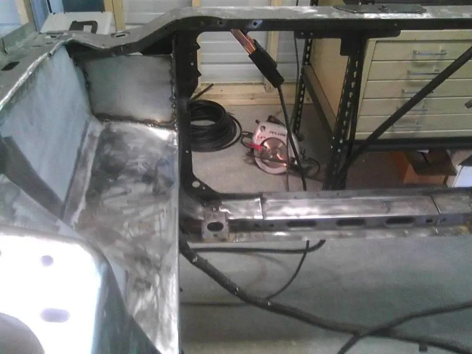

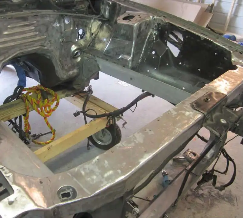

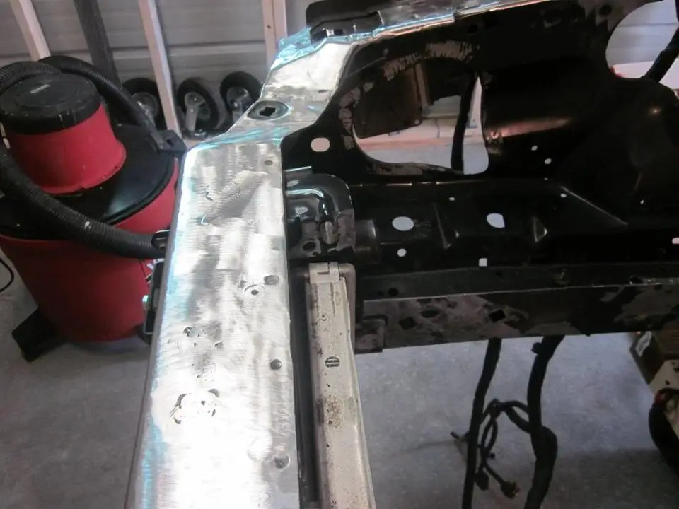

I got some more work done yesterday. Stripped and clean the firewall and made some panels to further smooth the frame rails and got them tacked in.

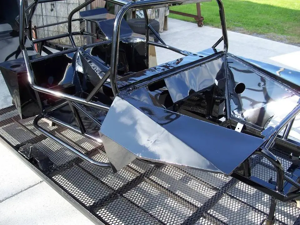

Dirt car chassis?
95steedamustang
I tend to be on the ocd side…
SN Certified Technician
Apr 22, 2009
3,219
6,503
174
East TN
Apr 25, 2011
#232
  • Apr 25, 2011
  • #232
jdl95stang said:
Dirt car chassis?
Rockcrawler

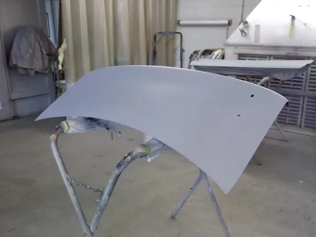

Thanks man, I just work on it when I can. Having a good shop and tools makes things go a lot faster. I'm sure my neighbors wonder why I have the Matco and Snap On truck visit my house every week.

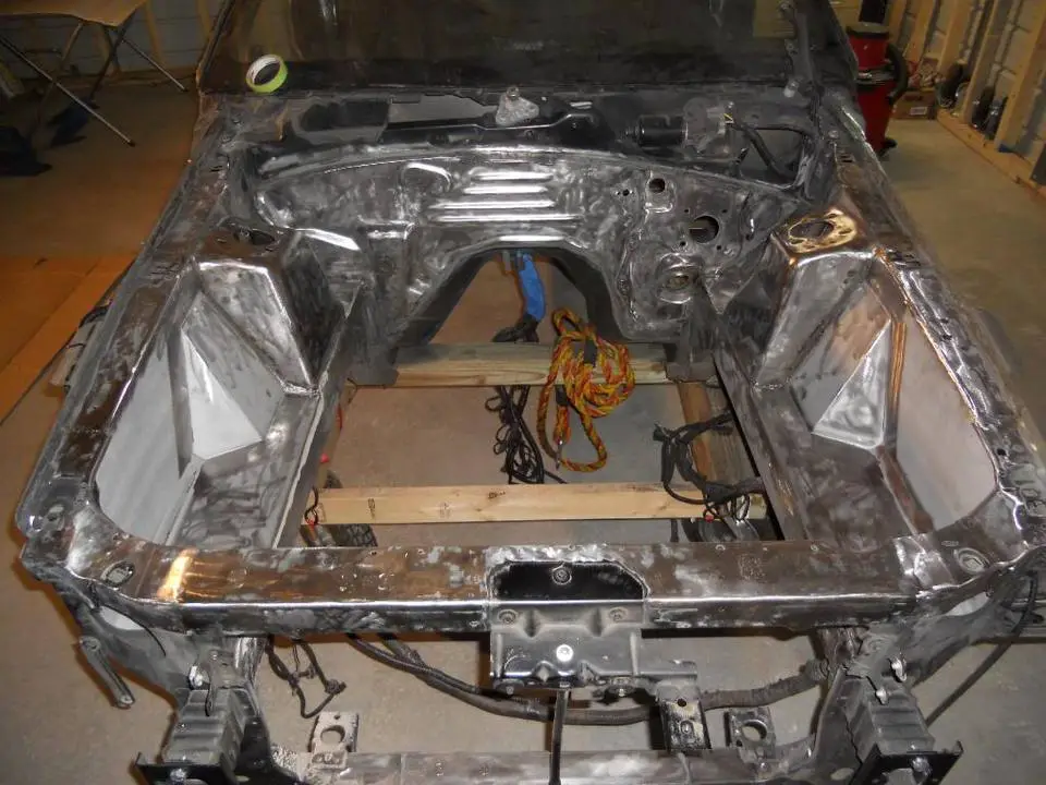

Progress on engine bay
Body work done on trunk lid and 2K applied

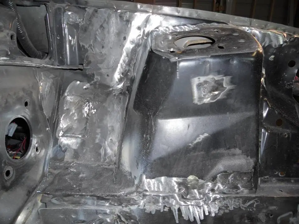

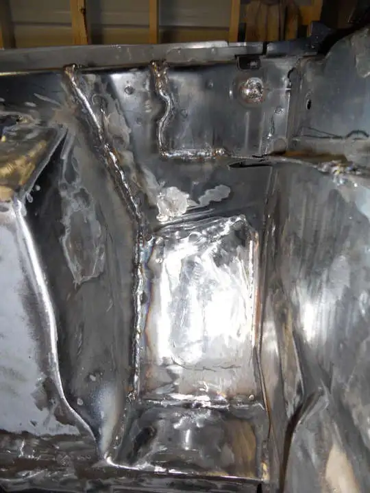

Still closing up holes, nearly finished with metal work and ready for epoxy primer
