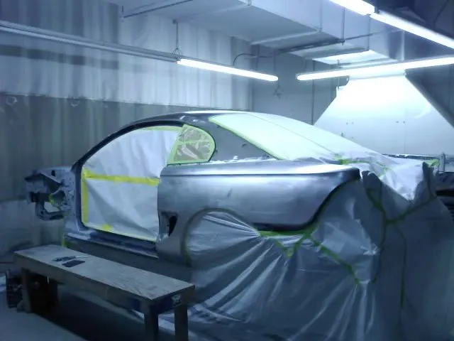

Build Thread "Rising from Ashes" 94 Cobra build thread

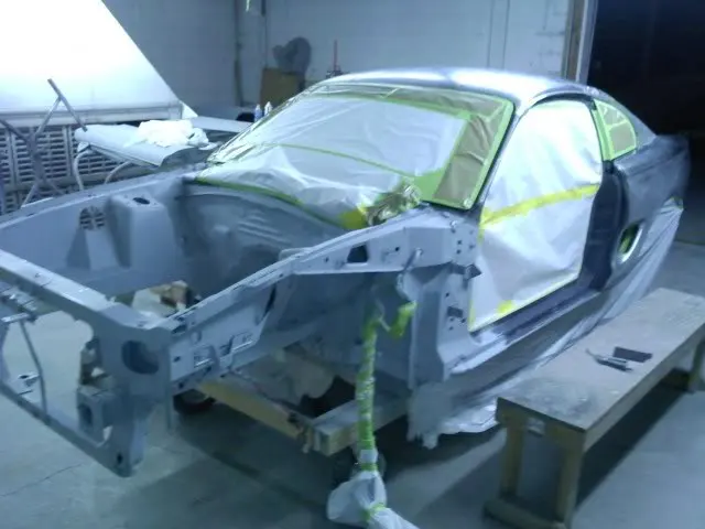

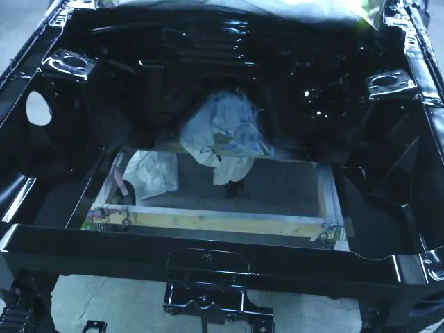

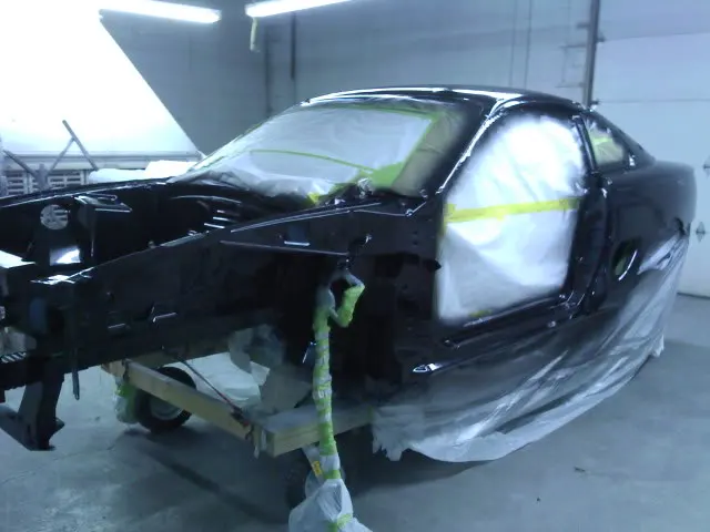

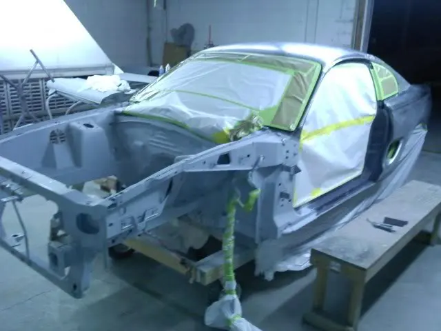

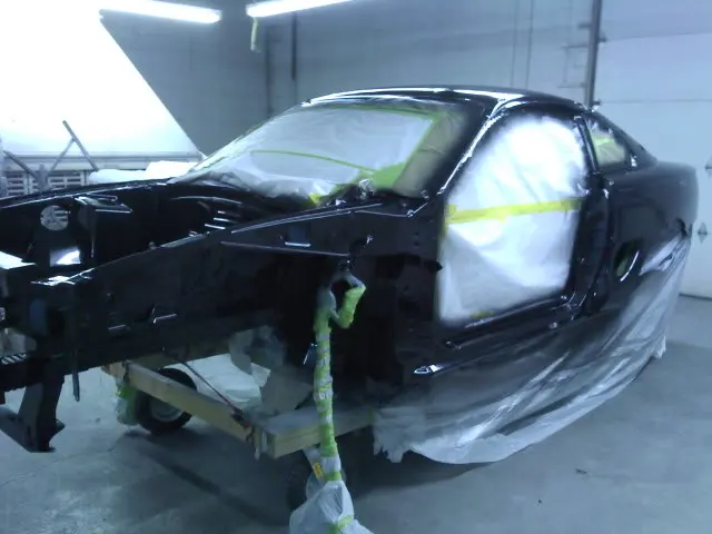

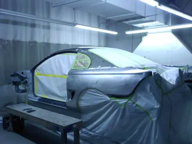

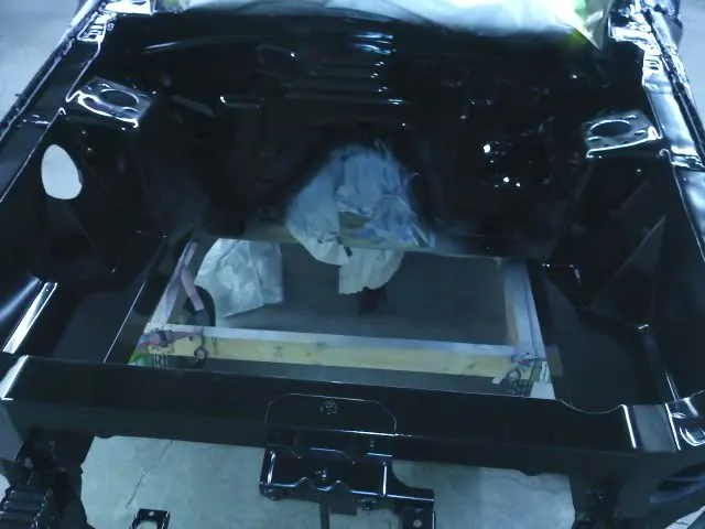

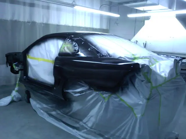

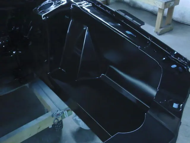

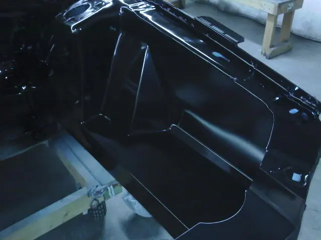

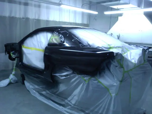

Latest update..all I have are cell phone pics
SPI epoxy primer.

:nice: Been waiting to see this thing in paint for awhile now. Looks really clean, keep the pics coming. Nice work Kevin!
Mark
Thanks Mark! Its good to be out of the bare metal stage.
I'm soooooo jealous! Wish I had the space and know how to do his to my car! Keep the pics coming! Amazing build! Best one of all time!
Thanks...It will get there slowly but surely.
Been waiting to see the body for many pages of this thread. Congrats man, looks sweet. You did everything right. Now that its painted you have to be excited for assembly. How could you not. Are you doing everything by yourself? Wanted to ask that before.
Well... unfortunately thats just the first round of primer. Its an epoxy primer meant to seal the bare metal and give a base to start doing filler and blocking work. The body will probably see 5 to 6 rounds of primer and blocking. The engine bay has already seen 6 coats with sanding between each coat of epoxy primer. It will get there one day.

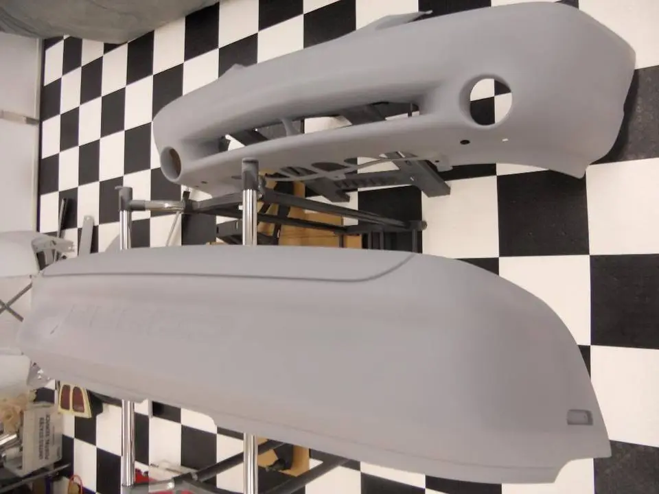

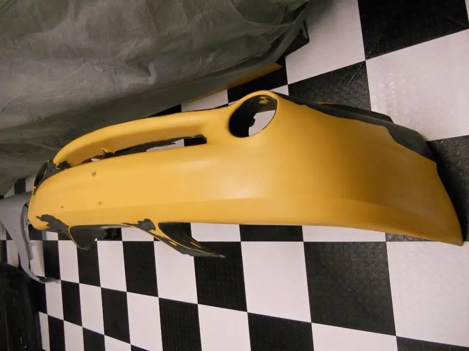

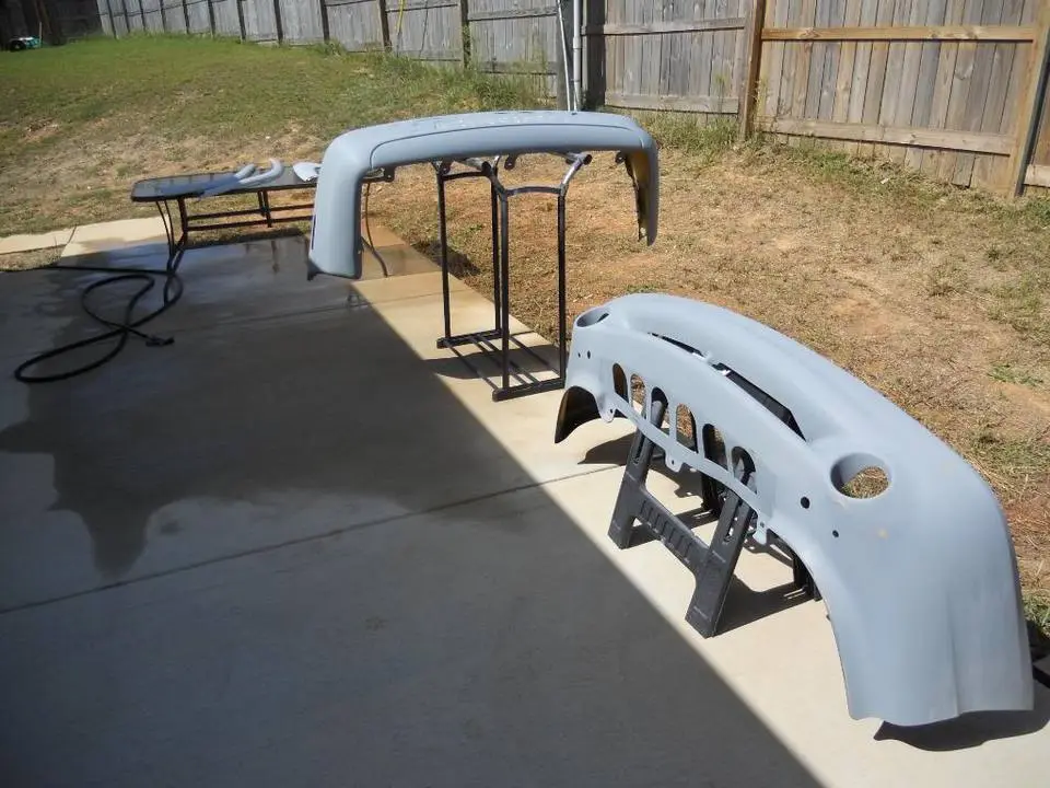

Finished stripping the bumper and got them in 2K primer. Now every piece on the car is at least in the primer stage.... little bit at a time.

Looks brand new :nice:. How did you strip it, looks super smooth!
Thanks Mark! Stripped it with 180 wet by hand. Lot of hours:mad:

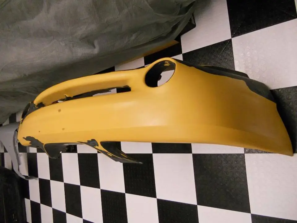

Why is the bumper yellow, is that the color of the plastic underneath?
Yes the raw factory bumper is a yellow underneath. I had spidercracking paint on the bumper so the only way to do a proper fix is strip it all off.

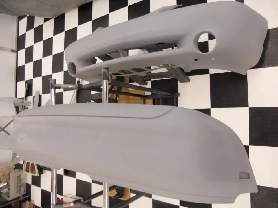

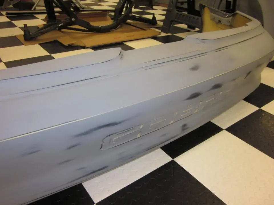

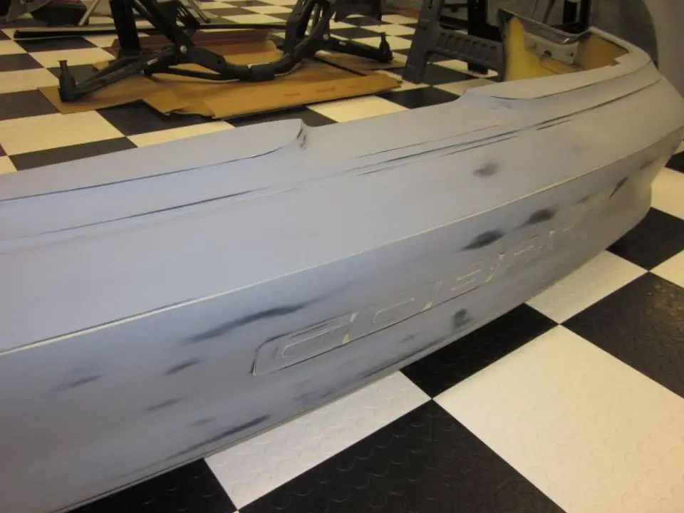

Got the rear bumper sanded with 220 today and is now ready for another round of primer
