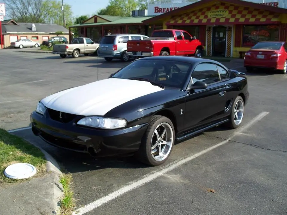

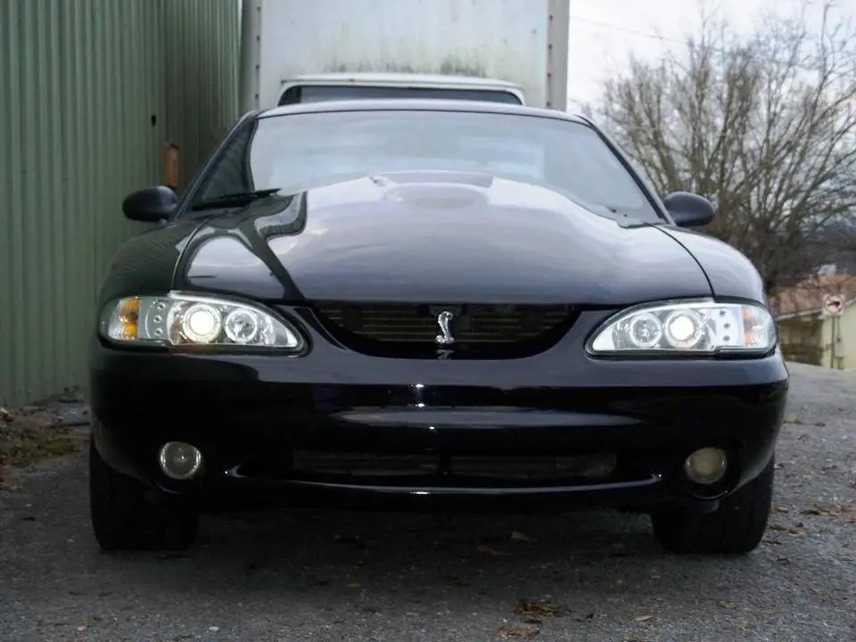

Well in the month of November 09 I found temporary housing and mainly played with the car but the first thing I had to do was get rid of the JUNK hood. I have painted one from this company before and swore I would never touch one again. I don't want to bad mouth anybody, so I'll just say it came from Ohio. It had numerous stress cracks around the hood latch area. It was ready to fly at any time. So I put it on CL and it sold in two hours.
I also got new hood hinges because the old ones had been bent back from the first hood flying on this car. I was then able to better line up the hood to the fenders.

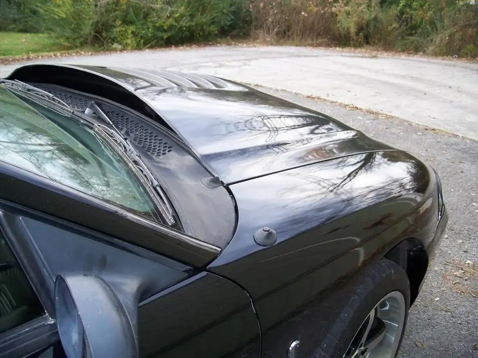

Always thought about changing hoods, so I decided to try a Boss Cobra r hood.
The fit and finish on this hood was very good. Also got a new to me cowl cover.
While it was a very good quality hood, I ultimately decided it was just too much for the car. I had a hard time even seeing over it.
Next thing Im getting rid of is the headlights...not my style
Boss uses much too high of a cowl for the 2000 cobra r style hood. It really loses the shape and sexy lines.
Check out cervinis 2000 cobra r. That's the best looking hood IMO for our cars. Perfect blend of curves that we need. Only the saleen extractor comes close.
Crazy how so many different 2000 cobra r hood styles are out there. The cowls need to be rounded off lines where as some are like a regular cobra r cowl like u had on the car initially.

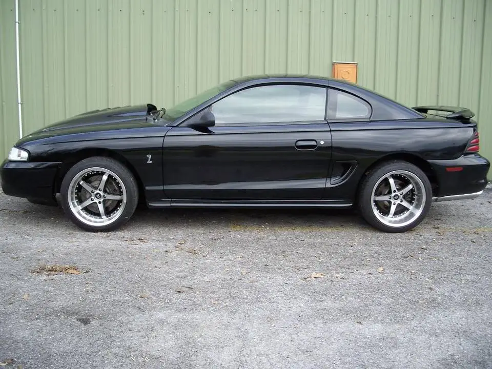

March-2010 I went back with my original and ordered a Cervini Cobra R hood again. I just think its the best looking hood for the 94-98s. The quality and finished underside make it a clear choice to go with again.
April-2010 I wetsanded and buffed the car, lined the hood up and took it to the Spring Rod Run for a last ride before tearing it down.

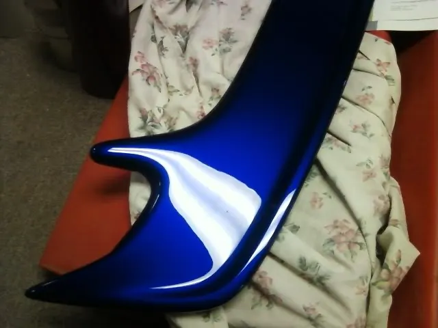

I almost forgot, I have one more piece from my old car that will be going on the new one. The 281 Kaneen spoiler. Luckily I had pulled it off the car to fix a chip and it missed the fire.

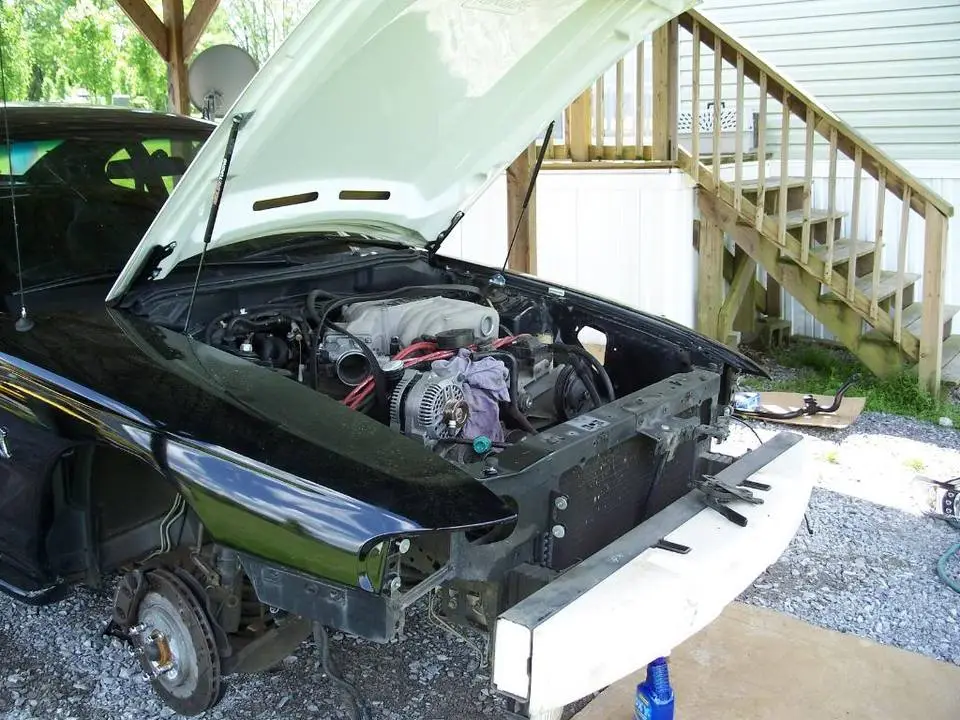

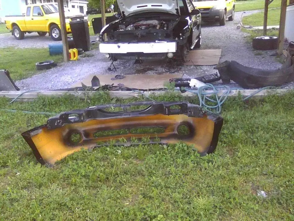

We also had to move to different housing, so we rented a 2 bedroom trailer until we could rebuild. But it happened to have a little carport. Which meant it was time to start tearing into the 94.

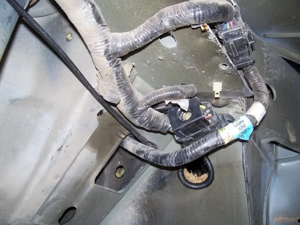

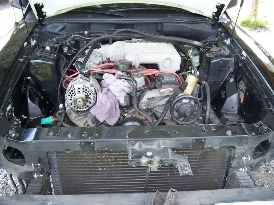

First thing I wanted to get out of the way was the wiring. This car had some splices,melted plugs, lights that didn't work and a drain that would run the battery down if it sat. So I wanted to get that fixed and go ahead and hide all my engine bay wires, relocate my battery, and put in my kill switch. Plus I could eliminate any wires I won't be needing with the setup Im going to be running.
First needed to disconnect the wires and install a hood lift kit.

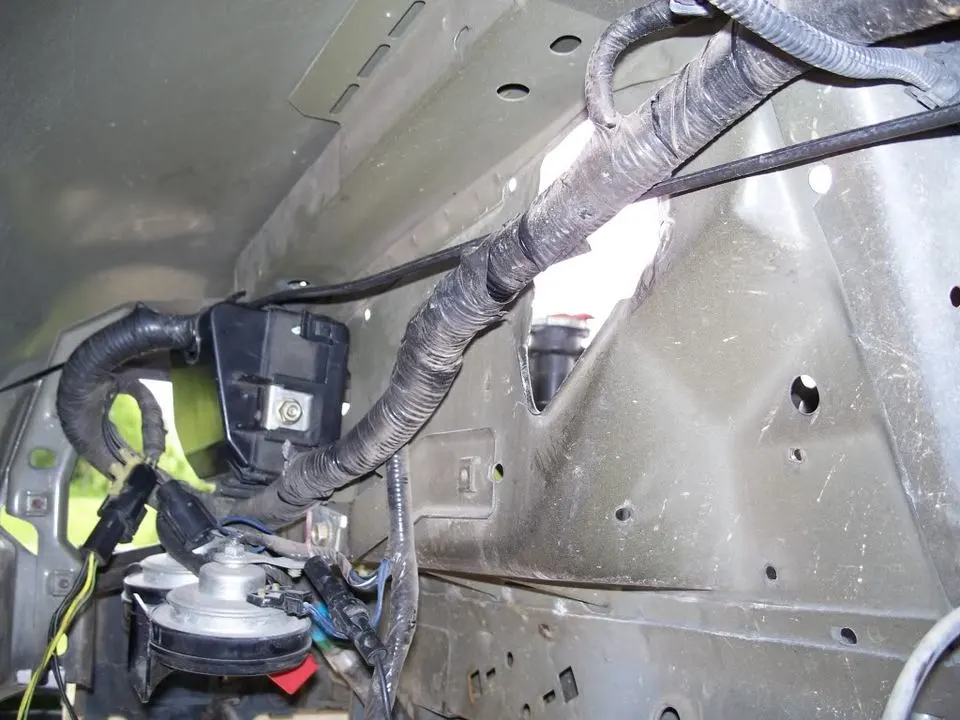

Moved the fuse box and hood latch cable inside the fenderwell.
Need a bigger hole to run the 1/0 welding cable through

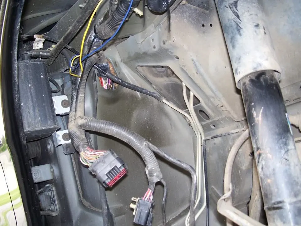

Onto passenger side...time to pull all this through a tight hole into the interior.

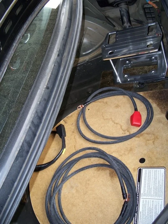

Onto the trunk with new battery box.
