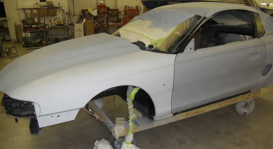

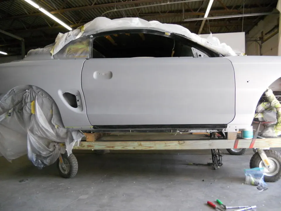

Started mocking up doors and fenders and setting gaps. This is a tedious process and can take a couple of days or a couple of hours. This one actually went pretty well.

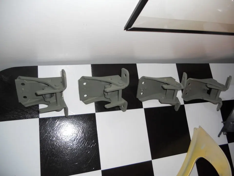

Started with new Ford hinges, then I coated them with metal etching primer.
Passenger side went good. Still need to tweak in places but that will wait until the hood is on.
Driver side needed some cussing but got there eventually.
Hinges are on the body for good....doors will come back off for paint.

Can you explain what would make the door be off like that driver side?
If the hinge is in place what would cause that gap.
Banger
Unlike a lot of newer cars, these have a ton of adjustment on the hinges. You have 1-2 inches of adjustment at the door posts and the same at the actual doors where the hinges bolt to. Passenger side...got lucky, driver side...took adjusting 15 times to get it right. Should be bolting on the hood and header panel and setting final gaps before paint-soon

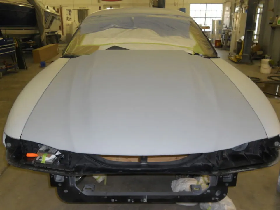

Some progress...

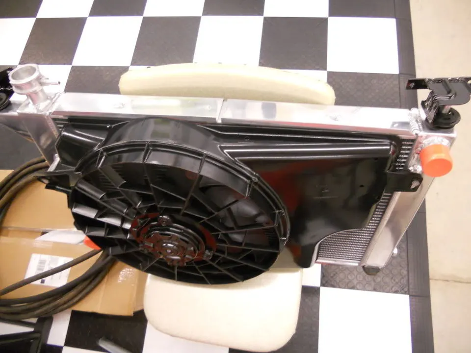

Got my cooling setup ready
Got the hood back on and all the gaps pretty well set. So now the final blocking and body work can be completed. This car already lines up better than my old one.

Car lines are straight razor.
How many rows on that radiator?
Thanks man! Its a 3 row.

I didn't know they made a 3 row aluminum radiator. All the ones I've seen were two 1" rows.
Kurt
Griffin will build you a custom 3 or 4 row radiator. Although they don't recommend the 4 row for street use because of air restriction.
Or if your more budget friendly
http://www.ebay.com/itm/Mishimoto-P...Parts_Accessories&vxp=mtr&hash=item35b4a0f655
Although I'm not sure the specs or durability of that one.
I can set the engine back 1 inch with the MM K member and still clear the blower pulley if I run into a space problem.
