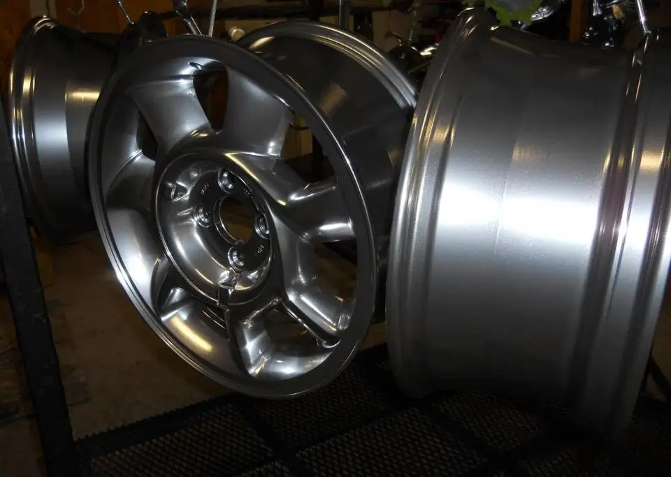

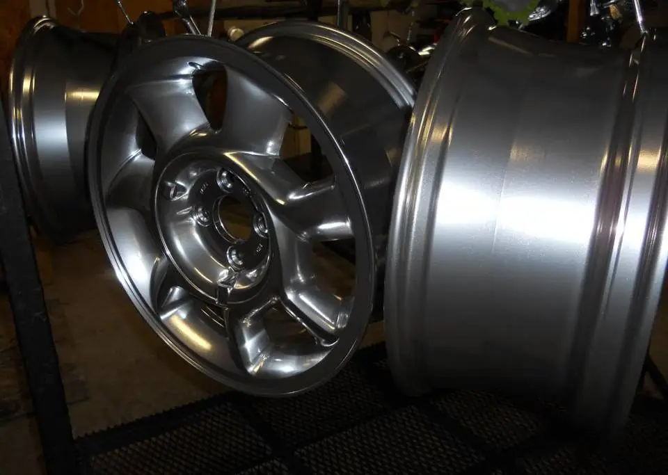

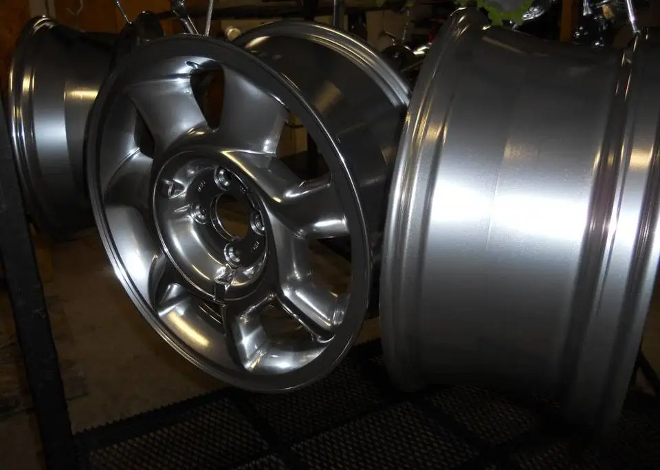

I did just get these done...93 Cobra's in chrome/clear powder.

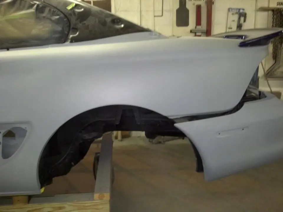

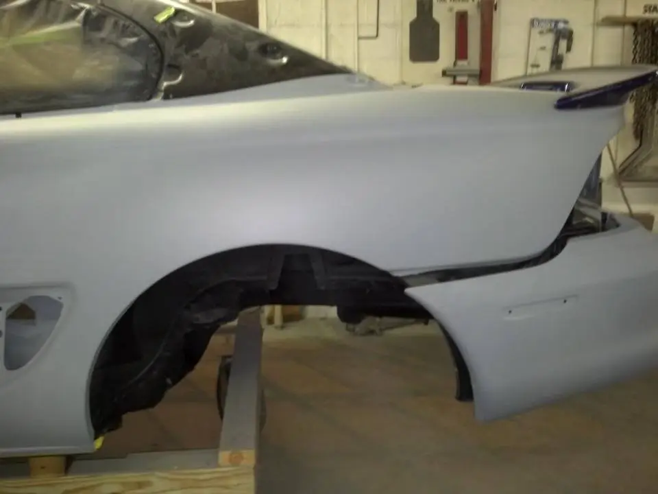

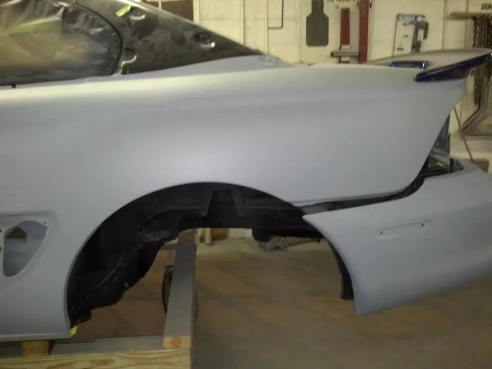

I had a spot (as you can see in the pic) that took a really thin coat.. It had a very slight low spot due to the late in the stage quarter to trunklid adjustment that I just wasn't happy with. Got it back in primer Tuesday evening so I'll give it a quick go over with a block & some 220 again & call it !! This just leaves some primer blocking on the 2 fenders, a slight touch of wrestling with primer blocking on the back of the pass door, and this thing is headed to a paint booth.

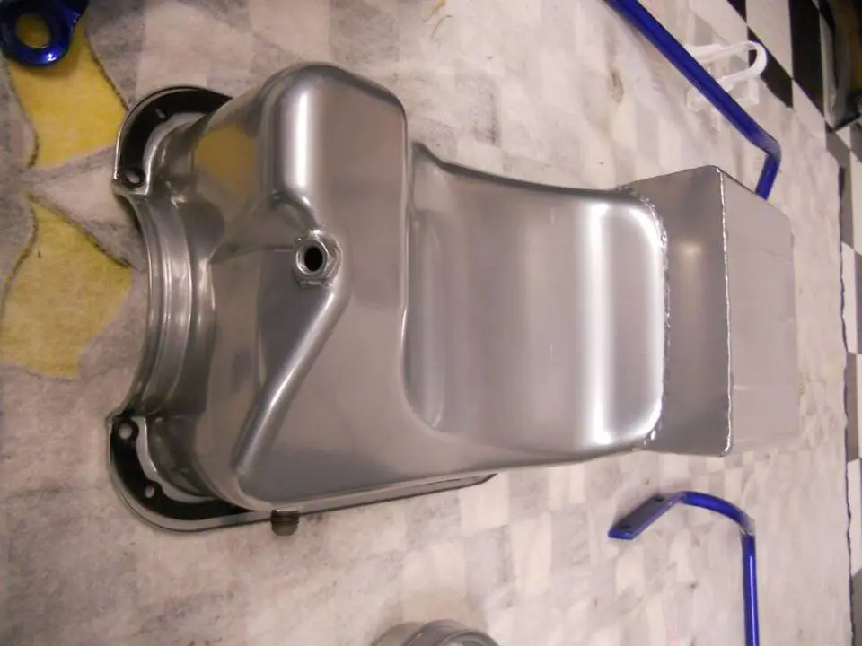

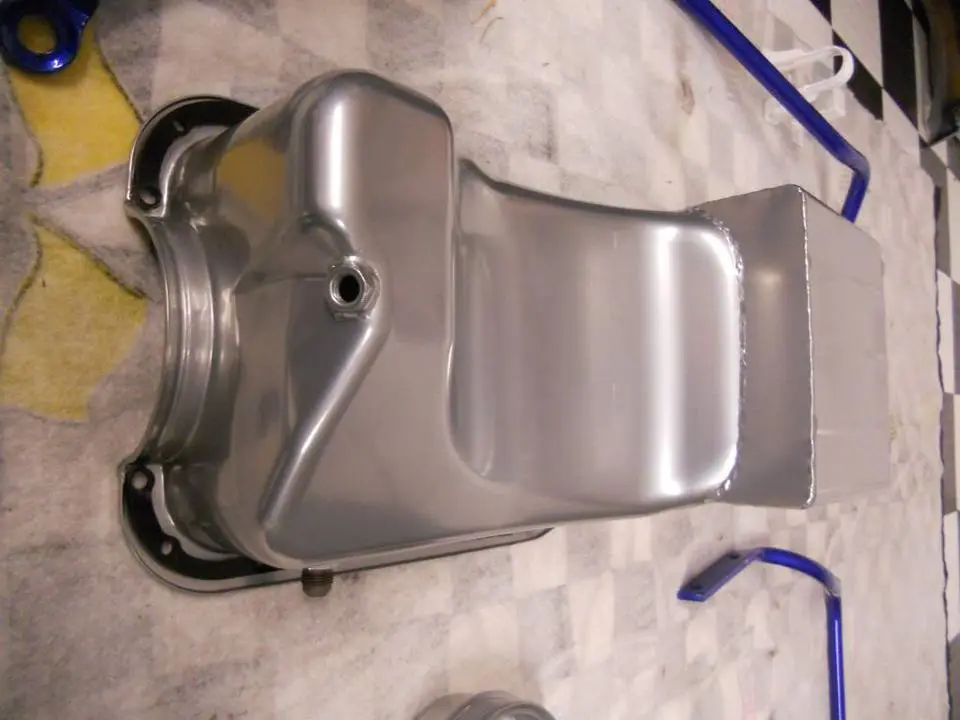

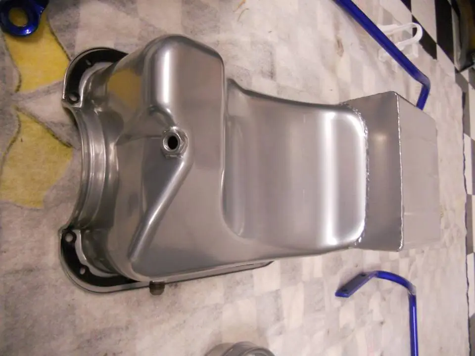

Also had to modify my oil pan to work with my new engine, so I stripped it and went back with the chrome powder coat this time. I left the rail spreaders gloss black to give it a little detail.

Off topic: How difficult do you think it would be to delete the quarter panel scoops on a 1994-1998 Mustang? I saw this done on a new edge Mustang a while back and wanted to get it done on my '02 (probably easier since there's much less curve to their scoops). Has anyone ever asked you do to something like that?

It would be easy to do. Just cut a patch panel out of sheet metal and shape it, weld it in, then do the filler and body work. primer paint and done. But I am getting older, so I like the factory look better.

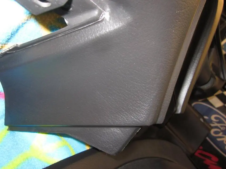

1) The interior panel prep/paint on page 29: what's your experience with its durability? Surely nothing can be done about gouges, but with the right prep/paint is it your experience the paint is resilient?

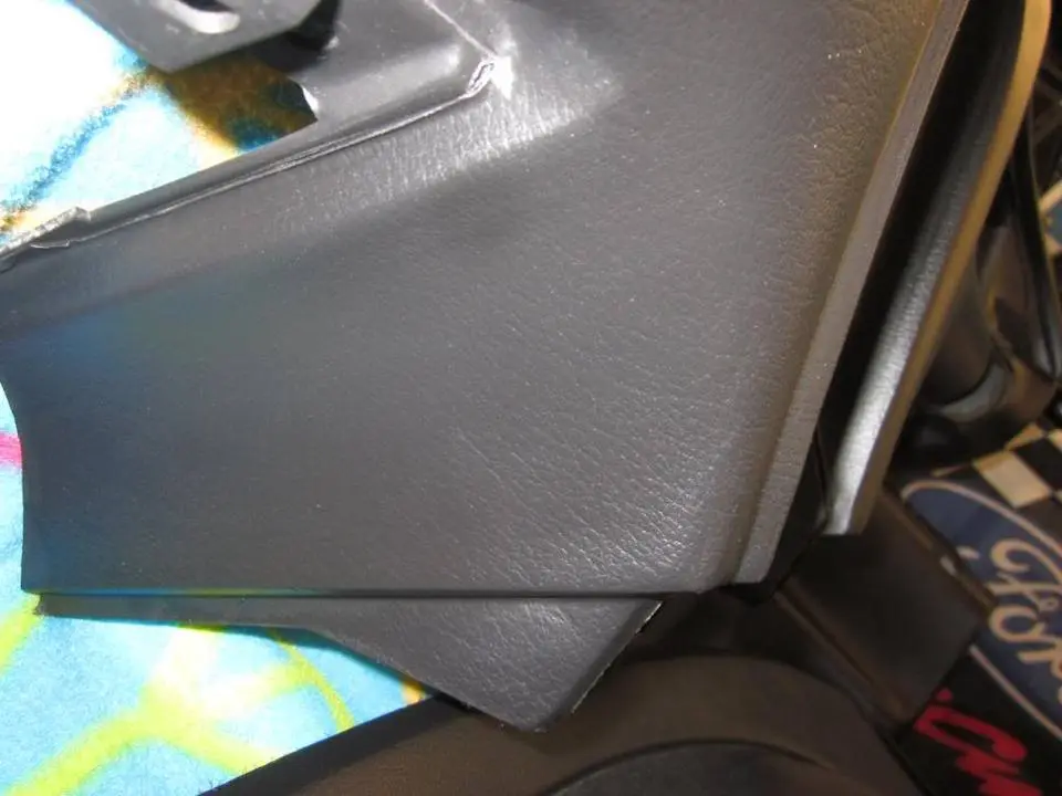

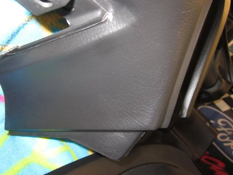

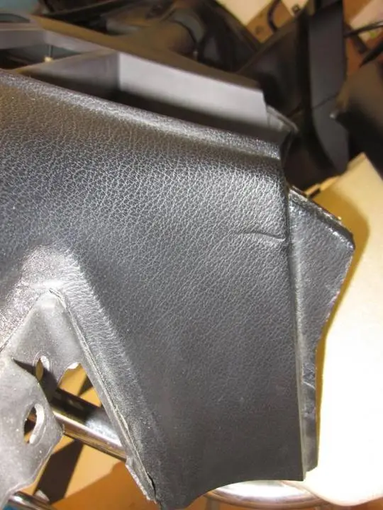

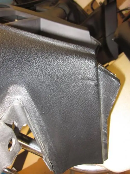

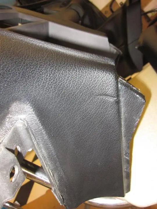

The interior panels...I've never had any panel I did scrape off. My method works on the hard plastic textures. As for gouges...you mean like this?
I mix my own formula to create the light, medium or dark smoked lights. I use house of color products. The key to making it look good and last...like anything else is in the prep. I will spend 2-3 hours per light to sand and scuff them so the material will bond and not ever come off.
