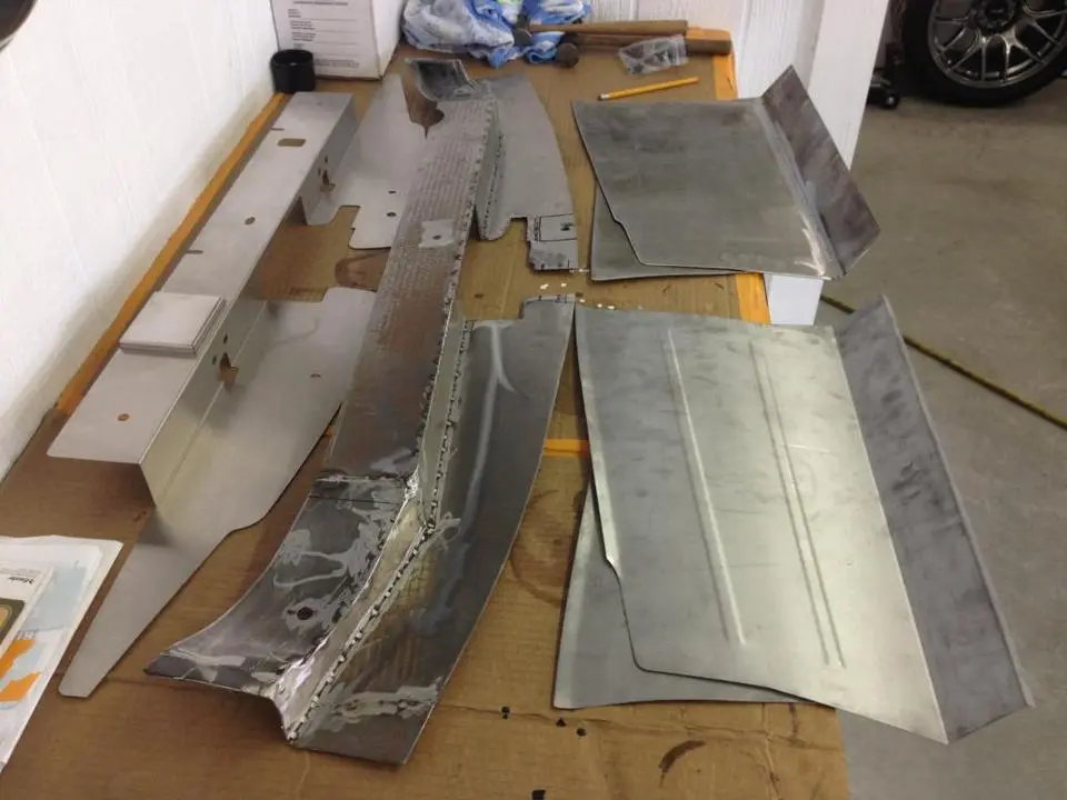

I've also been busy making weld in engine bay panels and getting them in epoxy.

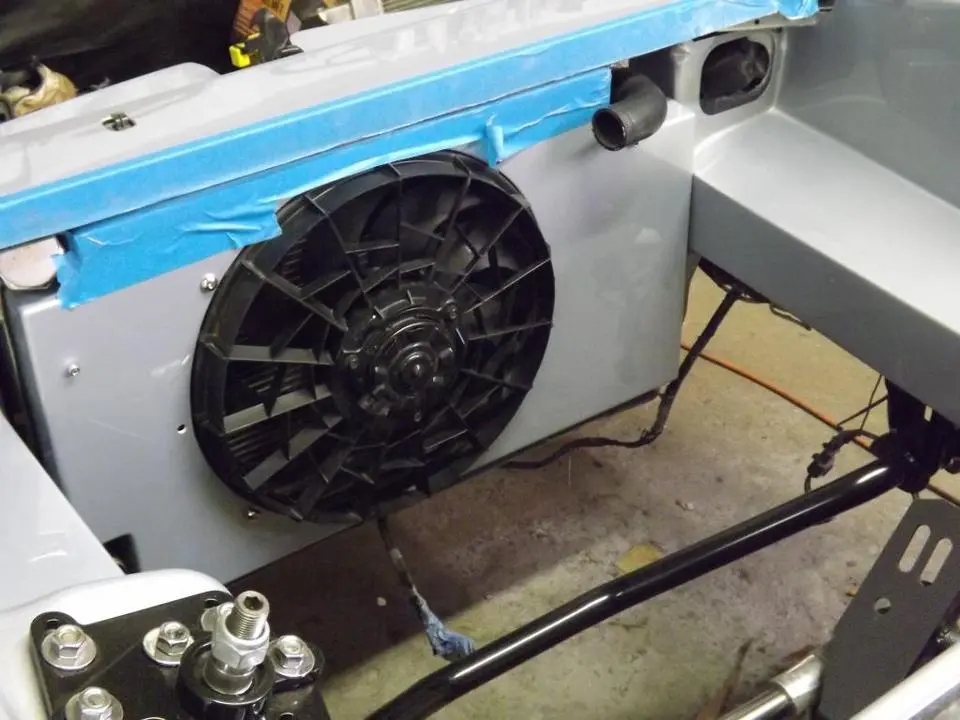

Yeah..my radiator is in the same spot. Good ole turbo guy's trick. I moved a fan to the front though to try and hide the thing behind the bumper and get a little more room

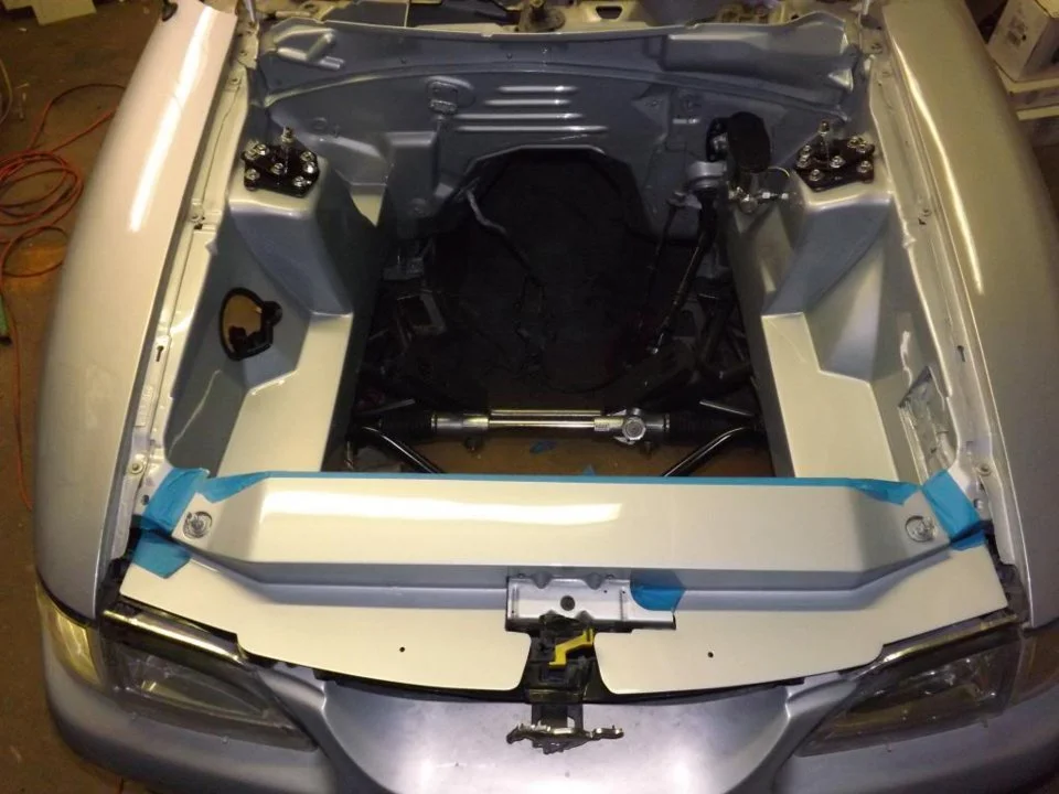

I've patterned out what my fox radiator cover will look like. Should get one made by next week and I'll drill the hood bumper holes. You could also drill the holes for the stock radiator hold downs if you got bling there already.
This is just a mesh of some already out
I'll probably make a few at once and then move onto something else. So if interested... Let me know on the next week. Should have a finished metal one n
ext week if I get some time.

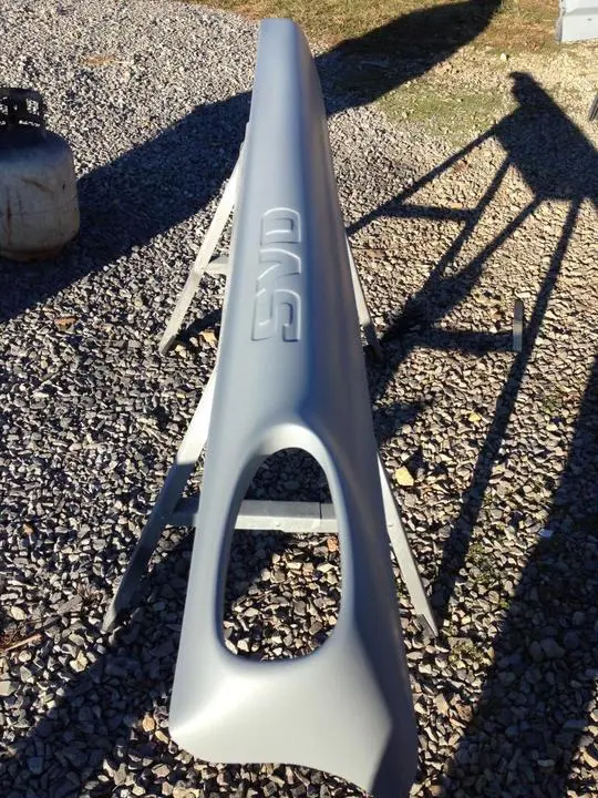

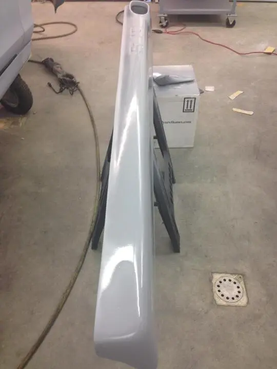

Few coats of 2k make the side skirts look a little better.

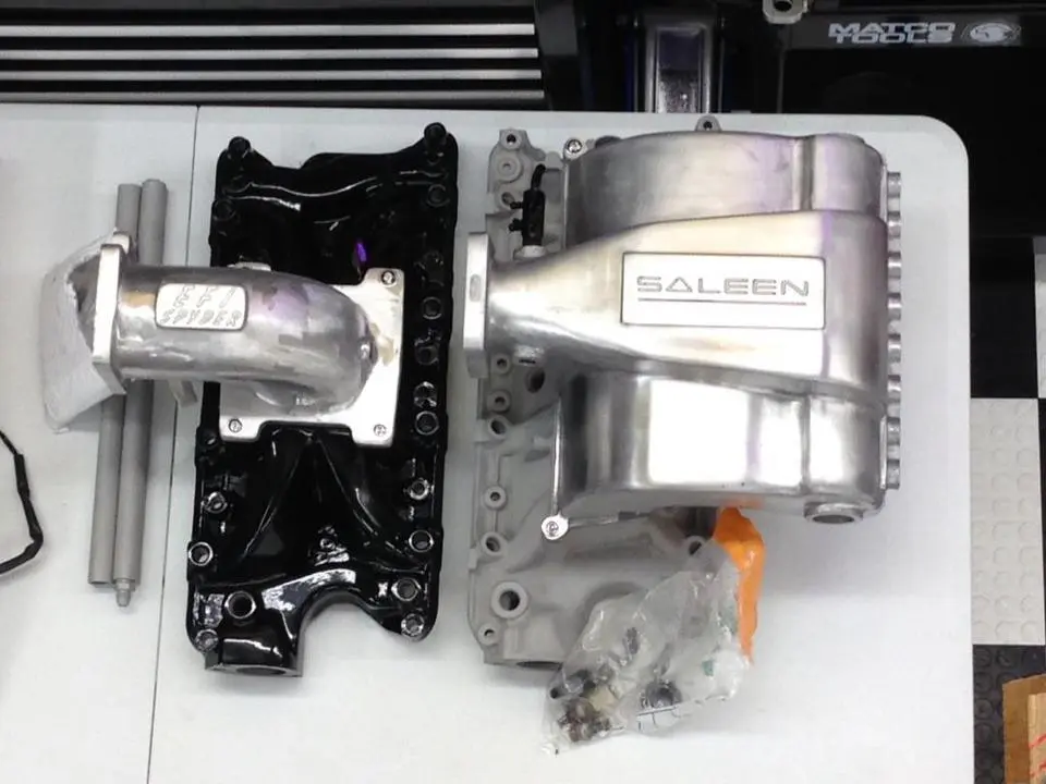

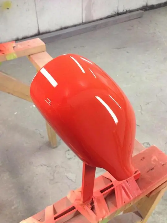

Then got some smoothing done on a couple intakes I'm working on. The Saleen intake is going on the engine I'm building for it and the Spyder is going on the 408 I'm building for my 88 T-Top.

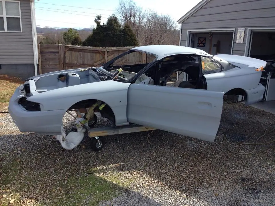

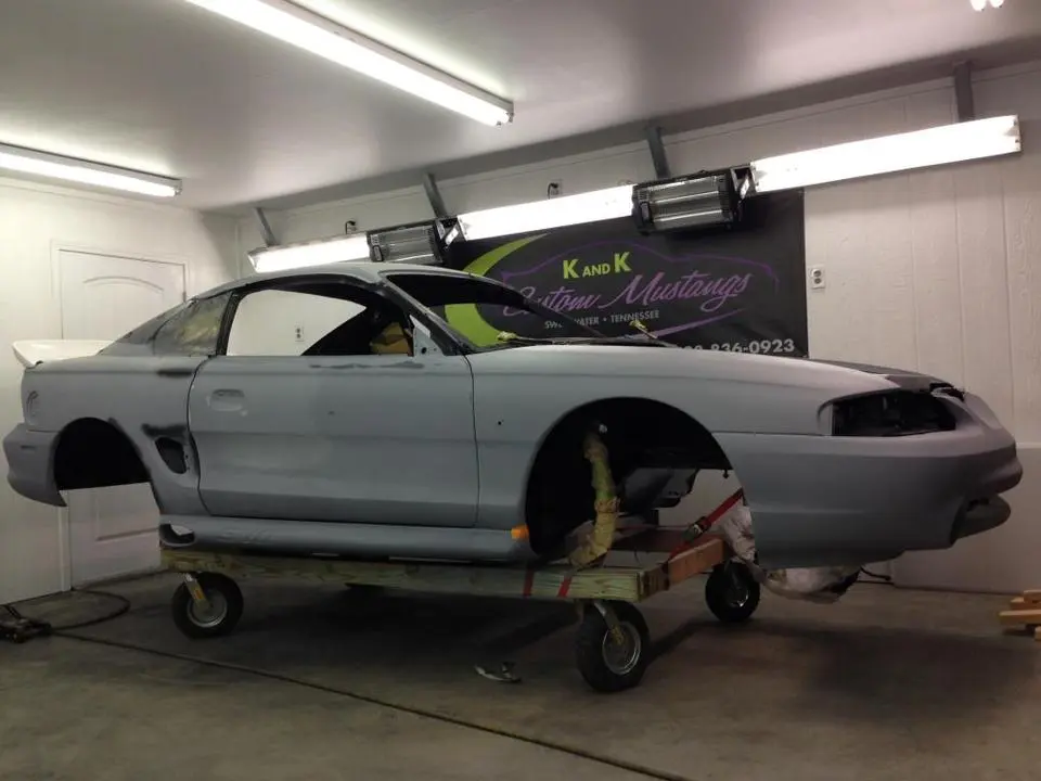

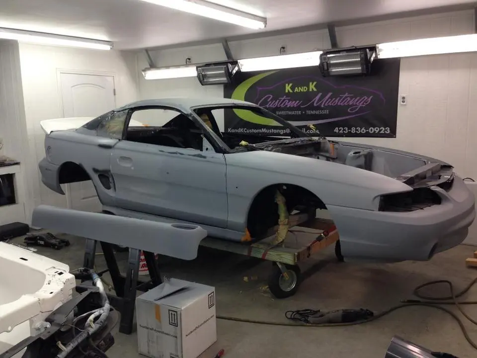

I actually went and got my 94 out of its tomb/hibernation last week, blew the dust off and got it back in the shop.

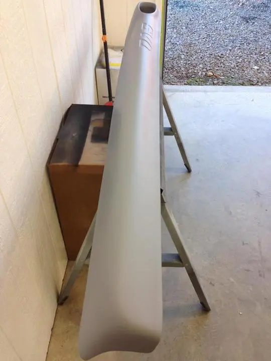

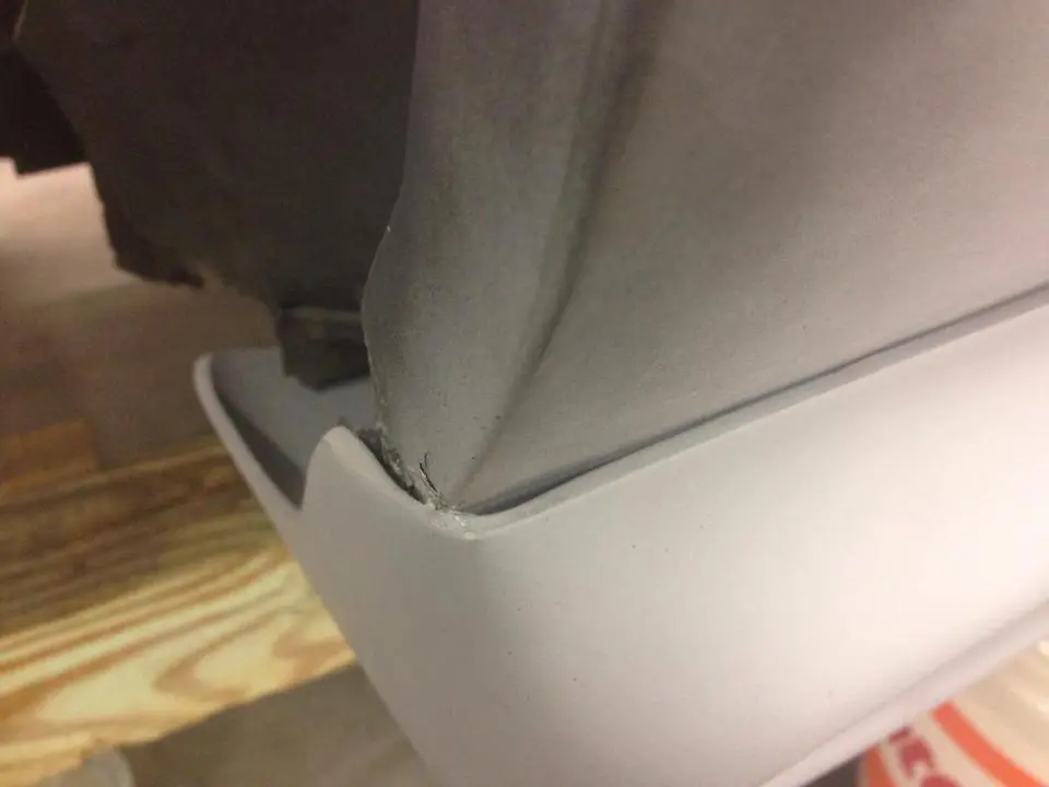

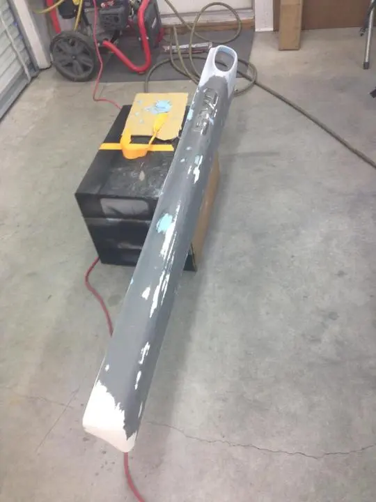

Got one side skirt mocked up. These SVO side skirts seem to hook out a hair on the ends so I'm going to fiberglass in some more material and then shave it down to flush fit the car better.
Also got the other side in primer and fitted as well..it needs a little more fiberglass here and there for a clean tight fit as well. I'll get that done before the next primer round.
Will also be working on the spoiler and it needs some serious body work as well as a 1/4 inch taken off one side.
