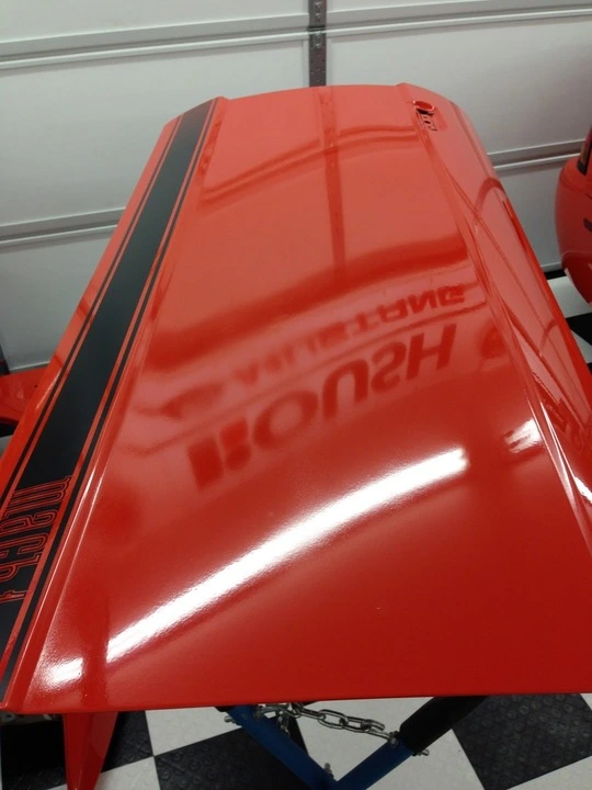

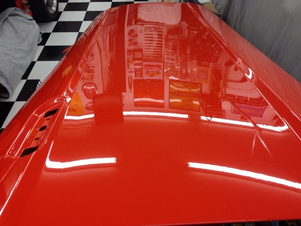

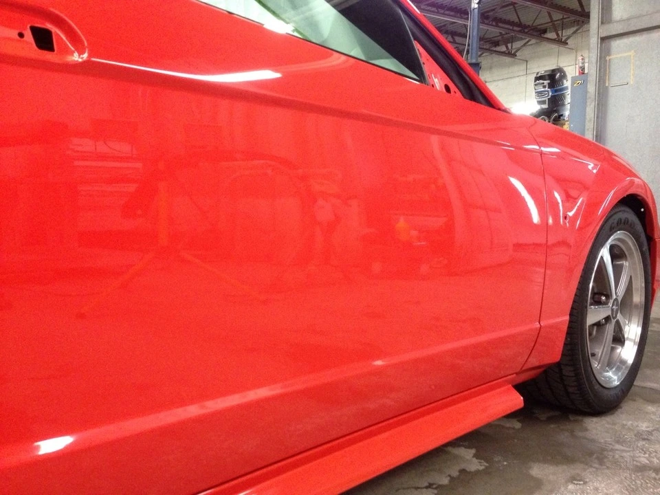

Found a pic from when I took the door off for a good before and after comparison.
Before
After
Reactions: Boosted92LX, 02 281 GT and hoopty5.0

Amazing how much orange peel takes away from a paint job.
Yeah and what's funny is that the door was hung and sprayed like the factory would with another round of clear to give it just a touch of orange peel so it would still retain a slightly factory look. The first round the door was layed flat and came out too slick...if that makes any sense.
hoopty5.0
mechanicus terribilis
Dec 14, 2010
7,854
6,994
214
SW Houston
Mar 20, 2015
#1,104
  • Mar 20, 2015
  • #1,104
ehhh.... nope, can't say I've heard that before. Anytime I did wetsanding at my buddy's shop, I was told to get all the peel out. But I see what you mean and I can see it in the pic too. That car is going to look fantastic. I wish I could buy a mach, but the oldest car I can get a loan on is '08 model year.

Yeah...since the car has only a few thousand miles, I want it to look somewhat factory...only a lot nicer and slicker but at the same time subtle. Which is why I didn't weld any holes like the antenna....even though I wanted to. Custom paint is a no brainer...load the clear, cut it smooth and buff the crap out of it. The hard part is getting a brand new car that has a bump and not only matching the paint but the factory texture of paint because a completely smooth panel will stick out like a sore thumb if the rest of the car has peel.

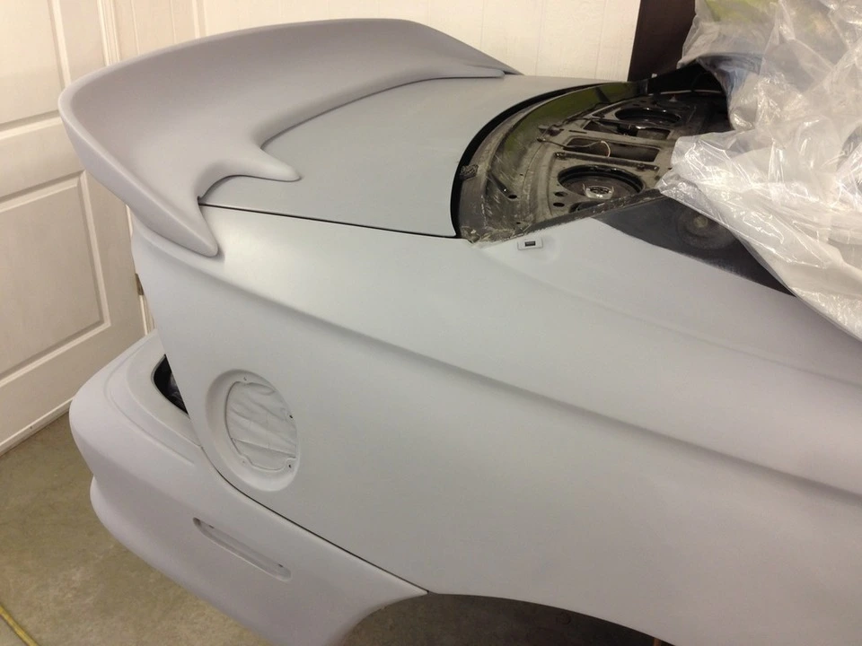

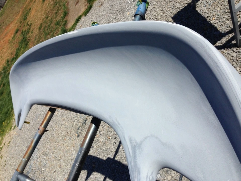

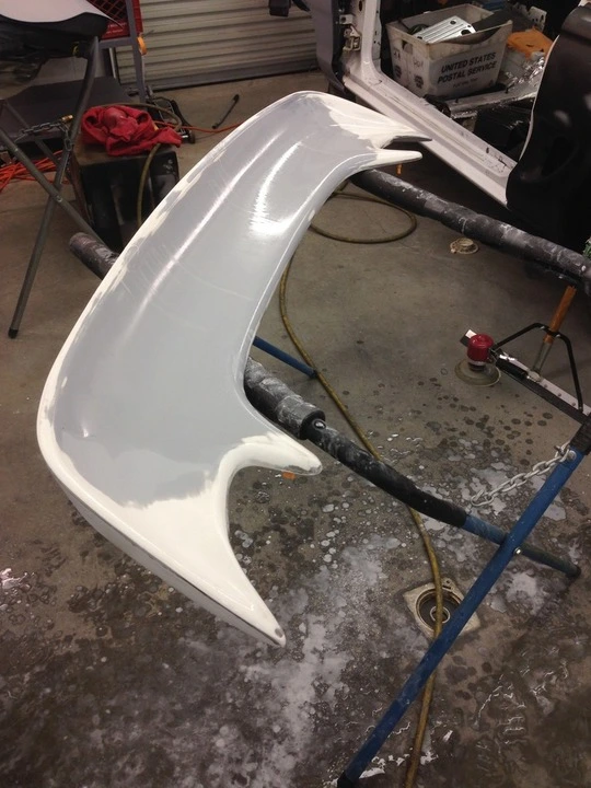

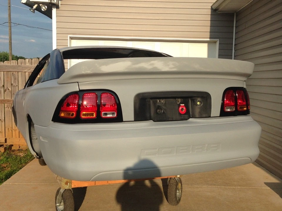

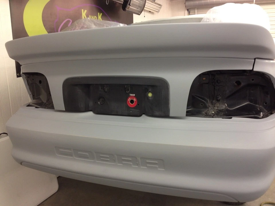

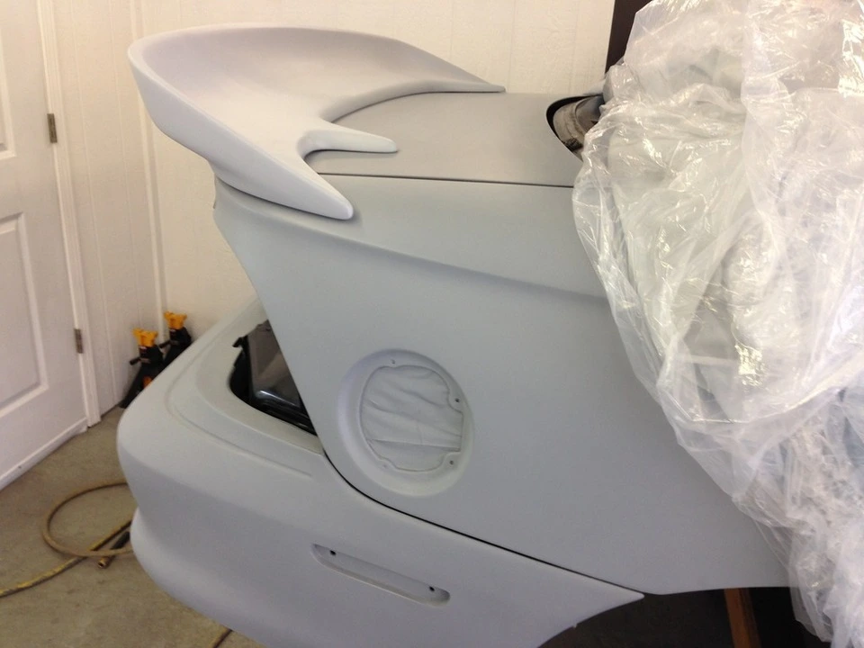

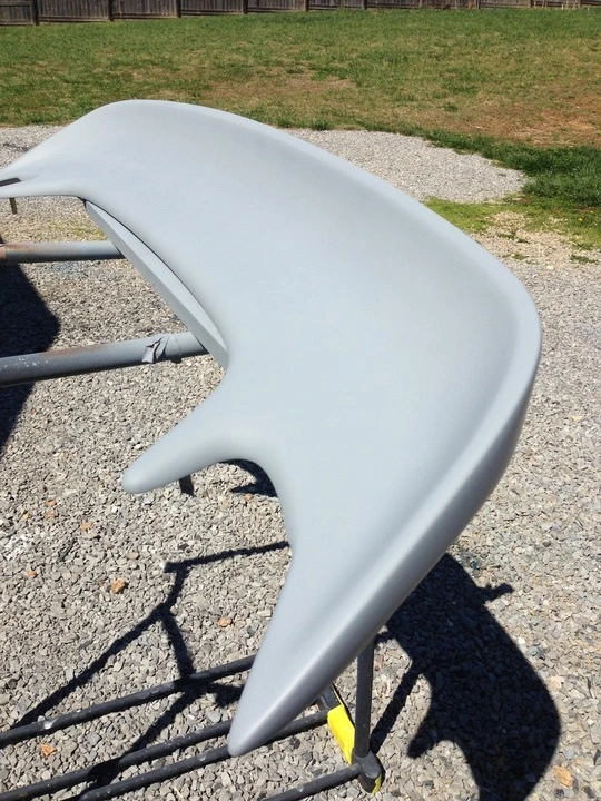

I do have Cobra progress. I got the body work and fit on the ice cream scooper (spoiler) close after blocking it 15 times and getting about 8 coats of primer along the way.
Block prime and fit again.
Another blocking
3 more coats of primer
and current fit without being bolted down

Haha. After 8 coats of primer and 15 rounds of blocking it's "close."

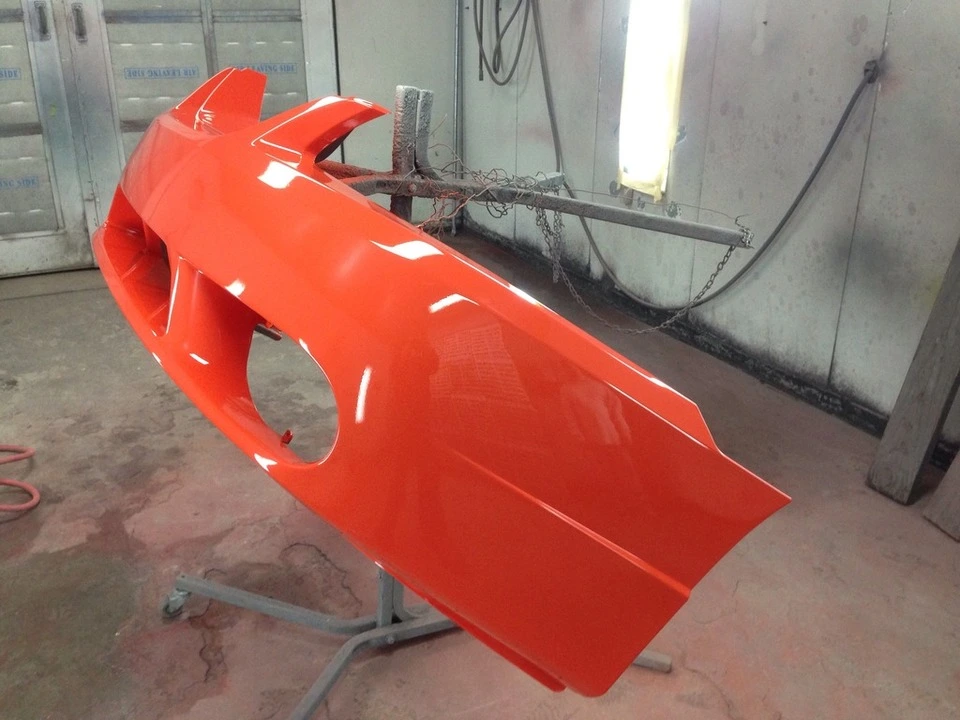

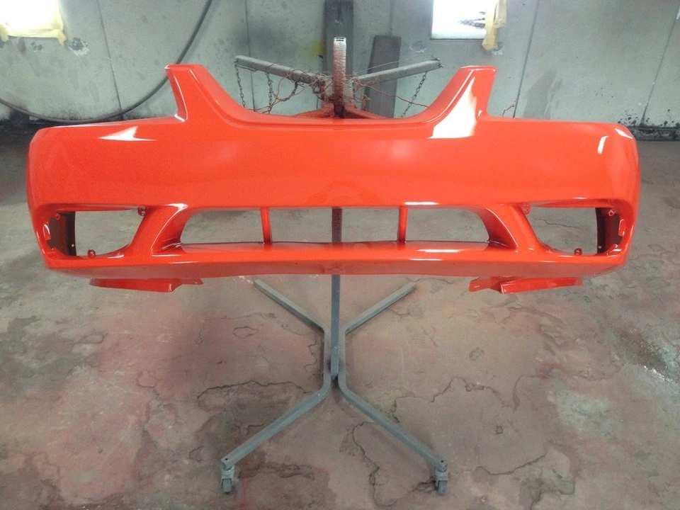

Used epoxy which serves many purposes including as a sealer.
Turned the old front bumper Orange today.

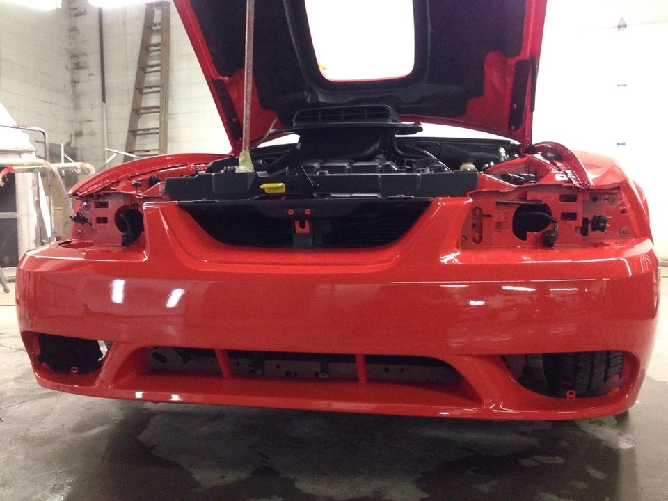

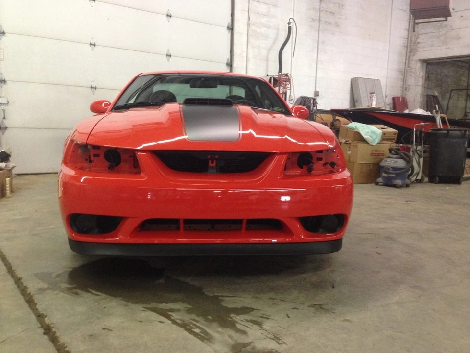

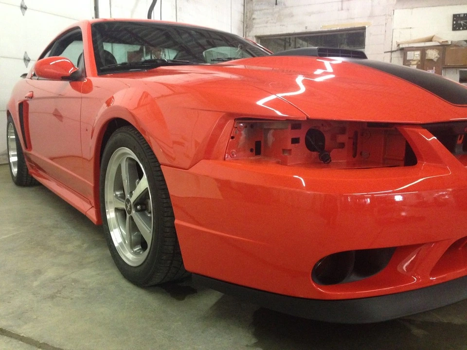

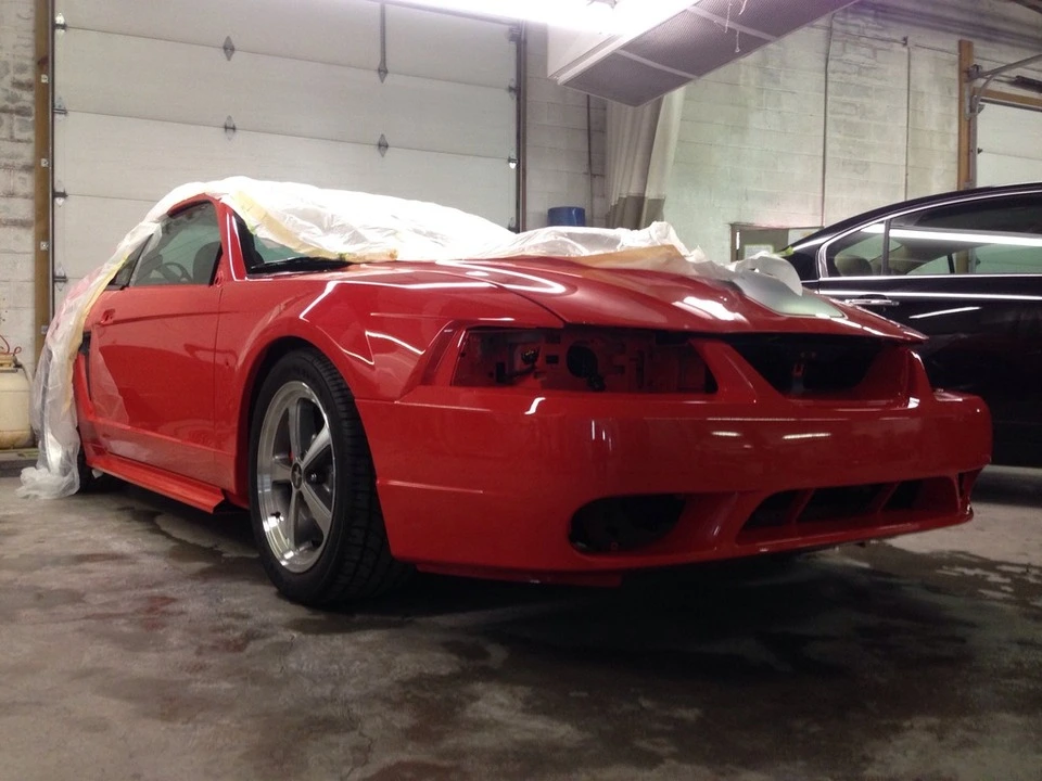

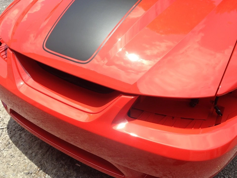

Thanks...progress continues. More parts on and more cut and buffed.
