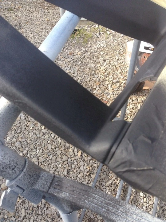

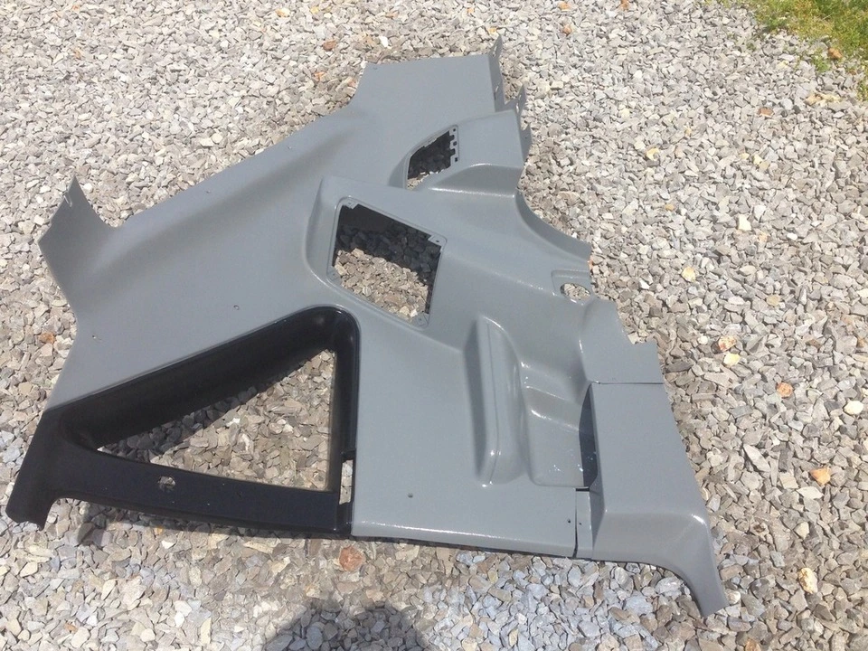

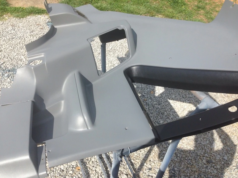

@Aaron...yes...I love t-tops. And yes those panels can be repaired and I have even gotten where I can replicate the factory texture. Just did this on my 89 Saleen project. Hit me up with any questions once you start it.
Here is a spot that was cracked, repaired retuxtured and the finished pieces.

Ok, I'm interested,...where's the part where you talk about what you did to repair the crack(s), what you used, and how you duplicated the factory texture?
I'm also curious (because you are obviously a brilliant body/paint man) what you do to weld in a patch and how you keep the warpage under control. I dread that I have so much sheet metal welding in front of me on my project, and any advice would be great.

@madmike1157
I use Fasco 2 part epoxy mixed 1:1 to repair a crack or split. Sanding the backside with 80 grit so it will bite. Small scratches I will just use some glazing putty to fill then sand smooth (320 grit works great here). Then I will use some pieces Ive cut out from bad panels that are textured and as the epoxy starts to tack up...I will just stick it on there and imprint the epoxy so it will set to match. I use SEM texture spray on the small little places and then just sand and recoat as needed to match it perfectly.

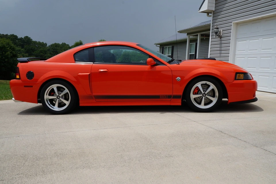

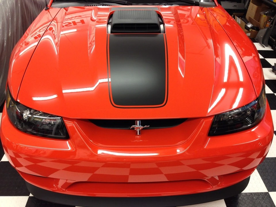

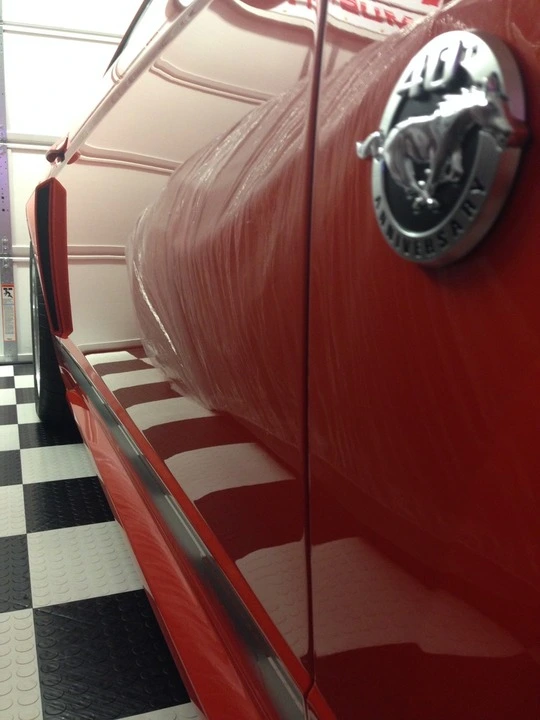

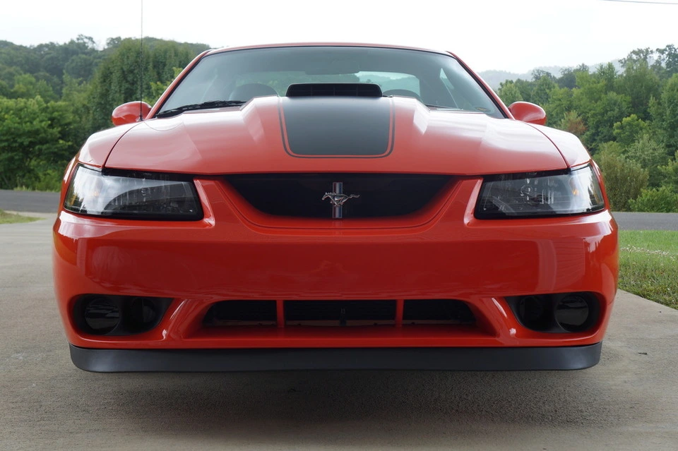

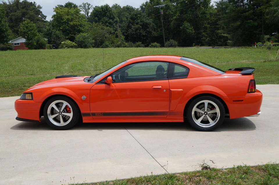

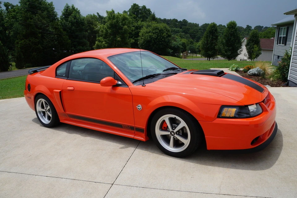

The Mach 1 Paint phase is officially complete. Next year will be engine details, upgrades etc. But for now...its just drive and enjoy.

One of my dream cars. In my color too. Looking good
Thanks man! and I agree. This car and color were on my list since it came out new. Thanks for following the progress too.

The Mach looks great! So is it going to assume DD status? Almost to pretty now.

I just assumed that that car was a customer car.
Lol! Nope...I only drive a truck daily. I haven't daily driven a mustang in 10 years. That Mach 1 has only got 3900 miles so I doubt it's ever been a driver.
