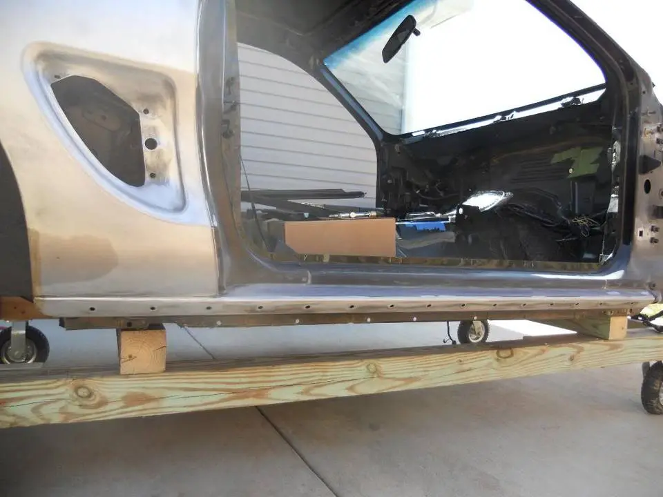

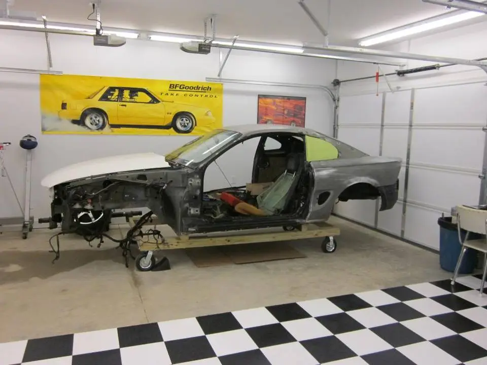

The next step was getting the car mobile, to move it between garages. So I built a cart to set the frame on.
First trip outside in a couple of months.

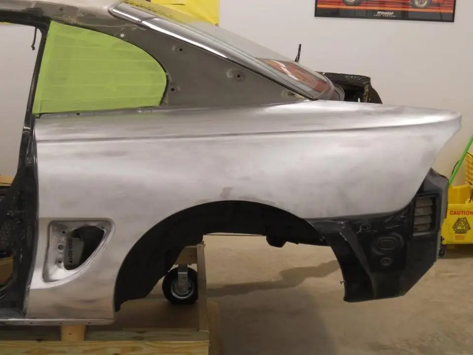

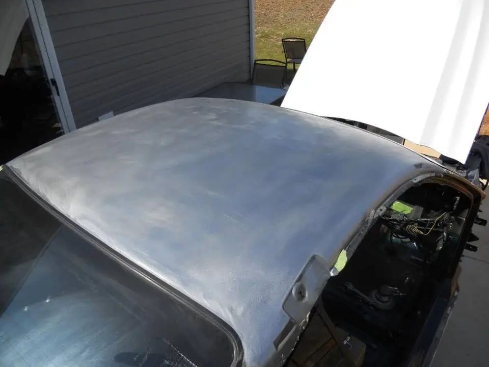

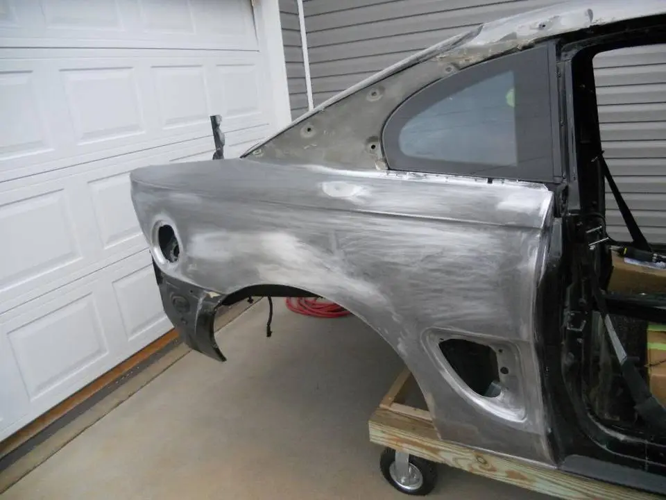

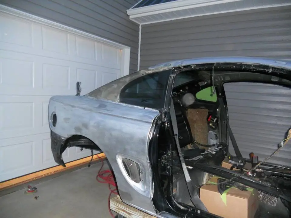

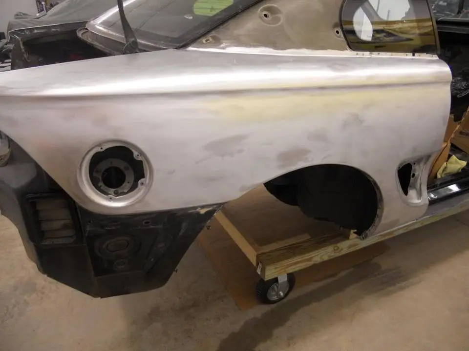

With the car outside I was able to really work the shell with the DA to get the metal good and clean.
Roof metal cleaned and sanded
Nice clean quarter ready to start working

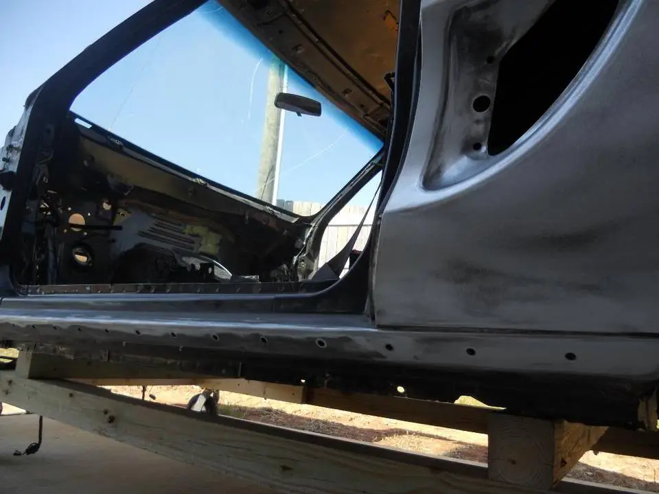

Started striping the door jambs

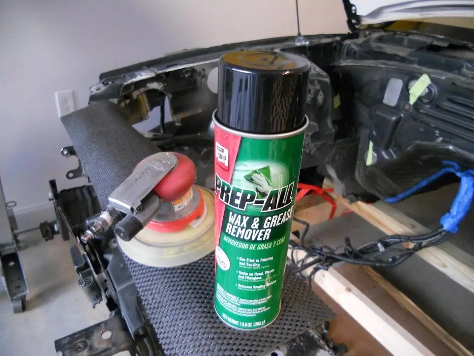

Sorry, what is a "DA"? The answer is probably further down in the thread, but I'm too lazy to search for it.

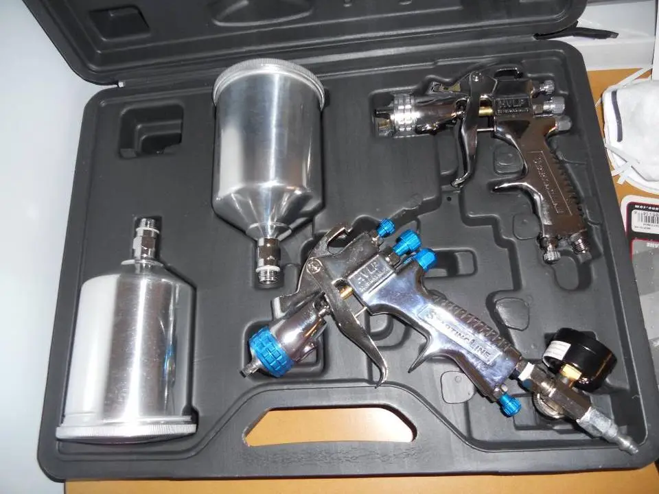

Sure its a dual action sander. It can be your best friend when doing the body and prep work if you know how to use it. The prep sol is also key. I ll probably use gallons by the time this is done. Oh and you also need good primer and paint guns

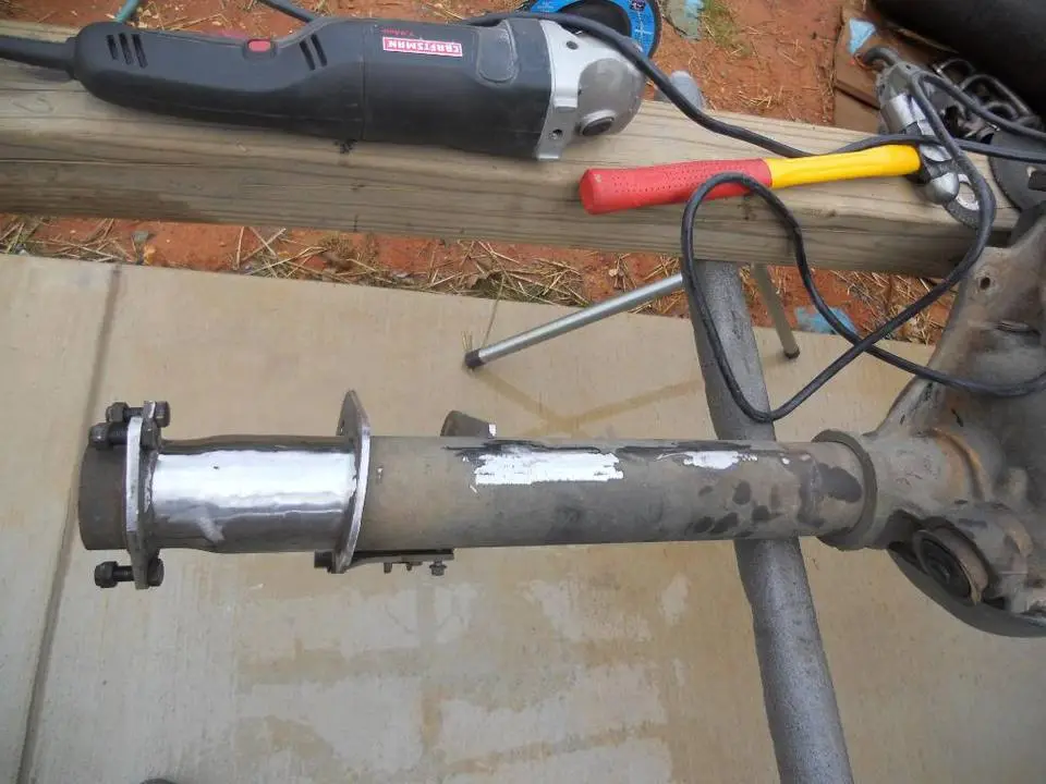

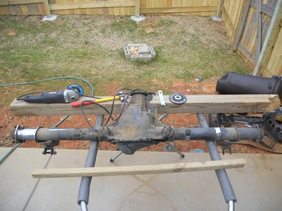

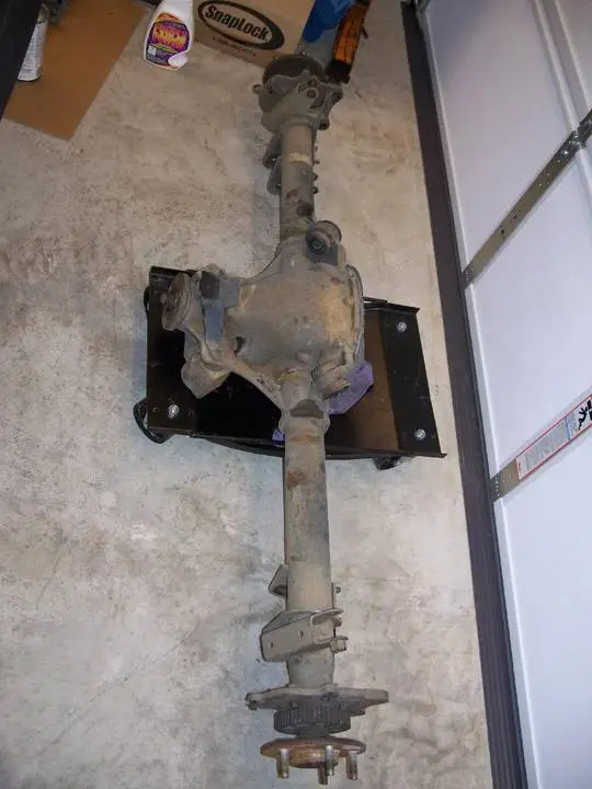

Started working on the rear end. With my suspension set, I will not need quad shocks, and I hate thngs to just hang there with no purpose. So off they go.
Next I'm going to blast and powder coat the rear end followed by a rebuild with 31 splines axles and locker/ 4.10 or 4.30 gears.

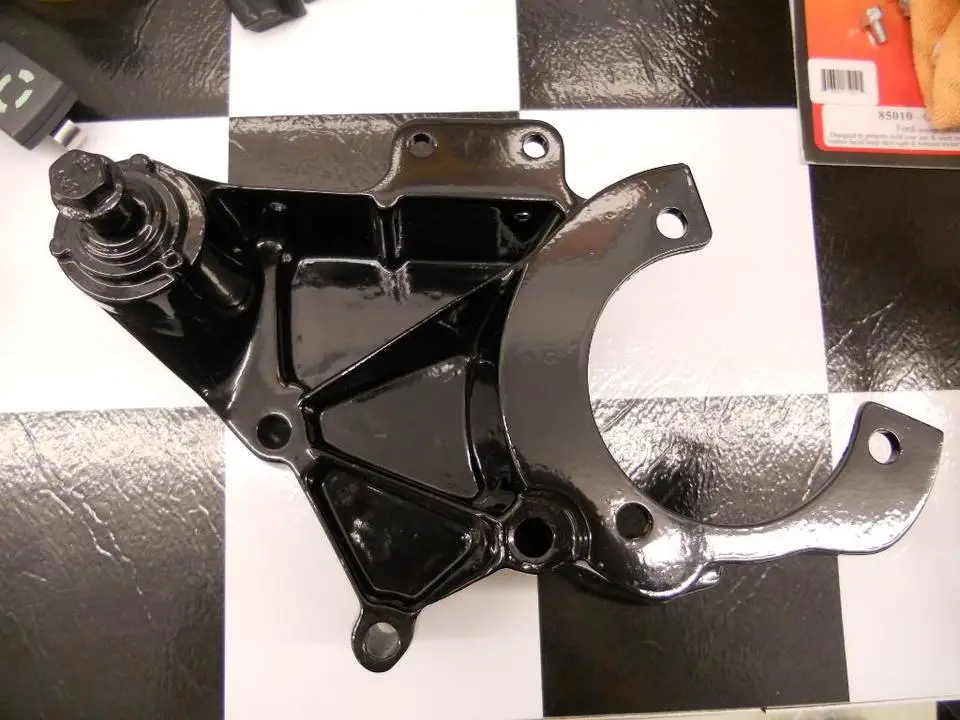

I also did the same cut and chop with the power steering bracket. Since I wont be running A/C. No need for the bracket
Then blasted and powdercoated.
um, the quad shocks generally help minimize wheel hop though.
some people seem to be able to get away without them, others have seen a noticeable difference without them.
:shrug:
:shrug:

I'm using the MM HD torque arm setup in the rear of the car. The MM arm eliminates the upper control arms as well as the quad shocks because one of its purposes is eliminating wheels hop during hard acceleration.
My foxbody has a full Maximum motorsports suspension setup and I absolutely love it.

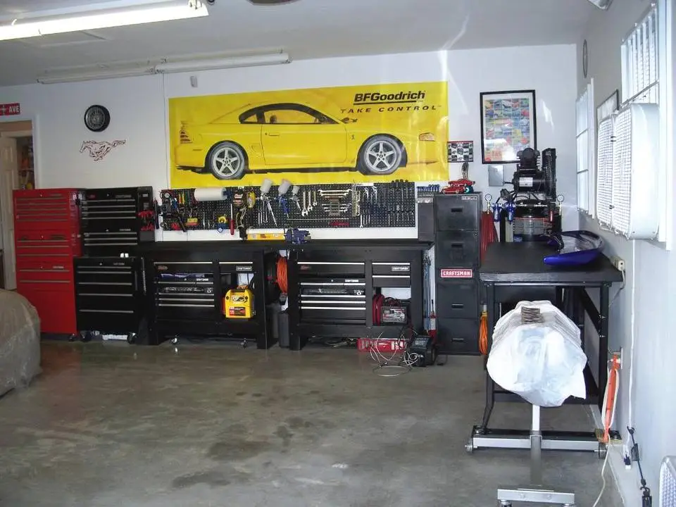

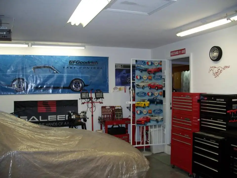

Here are pics of my old banners... At least I still have that much
Both the BF Goodrich banners I had in my old garage were given to me at shows, but that was 8-9 years ago. Since they don't make them anymore, they just go up in value. The BFG coupe banner I paid $40 bucks for.

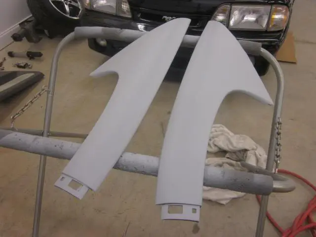

More sanding
More priming
