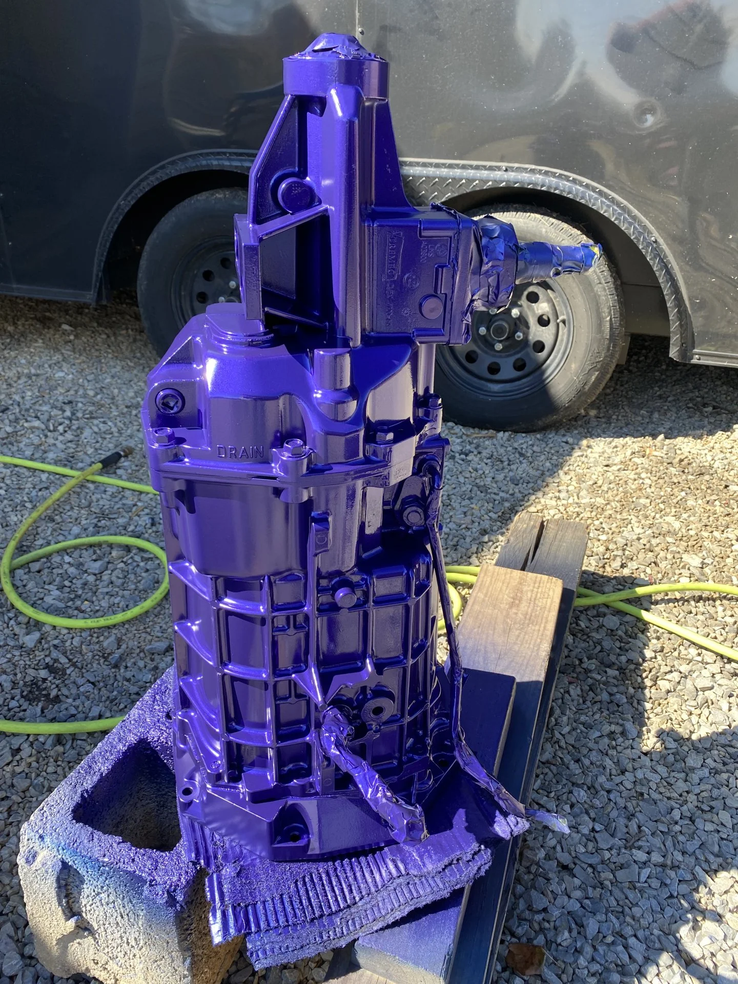

Thought that was supposed to be pink?
Whoops! Forgot to use the pink on this transmission I guess I’ll just have to use it on yours instead.

Damn……. Now I feel like I have to pull my transmission out and paint it.

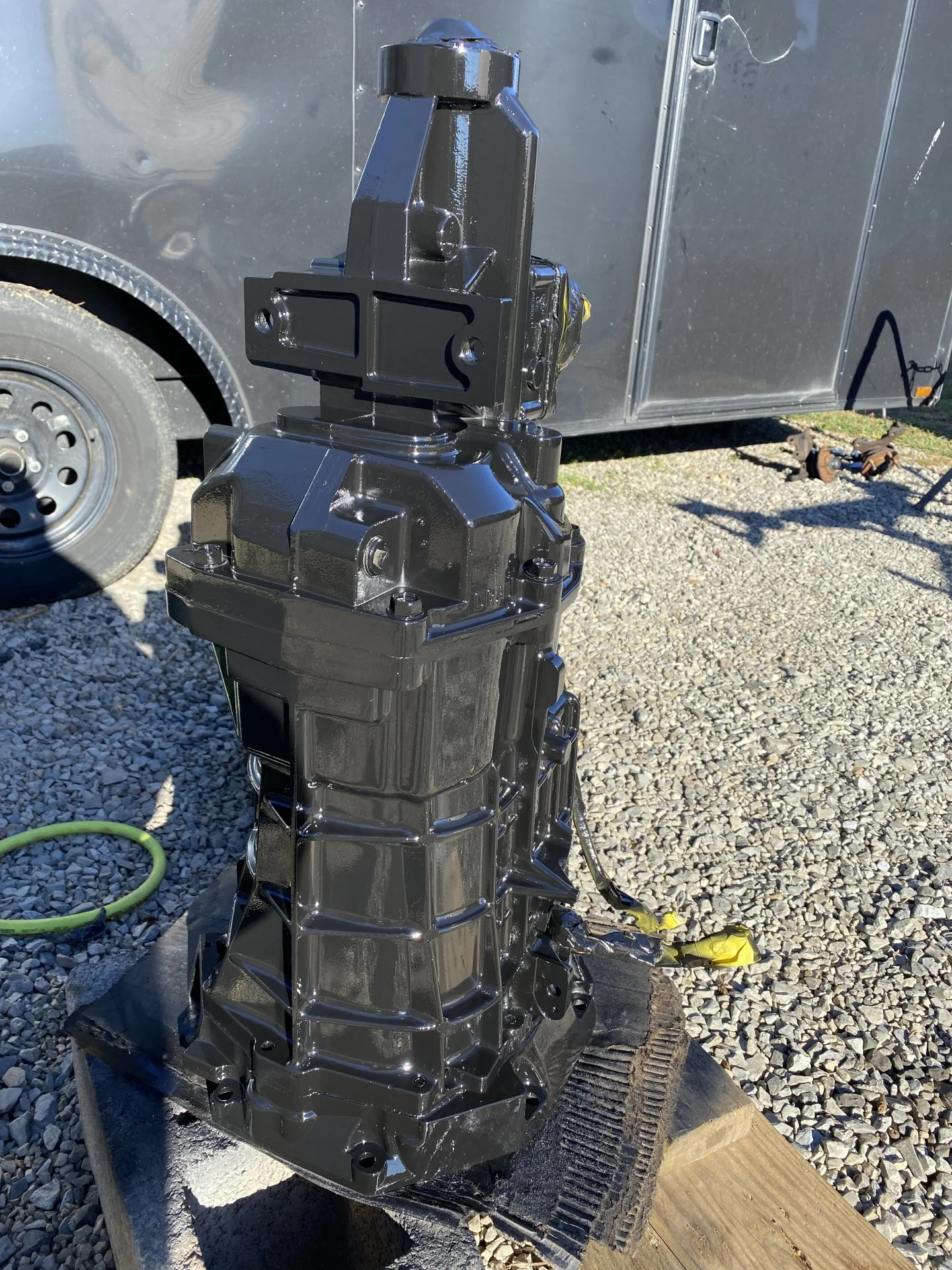

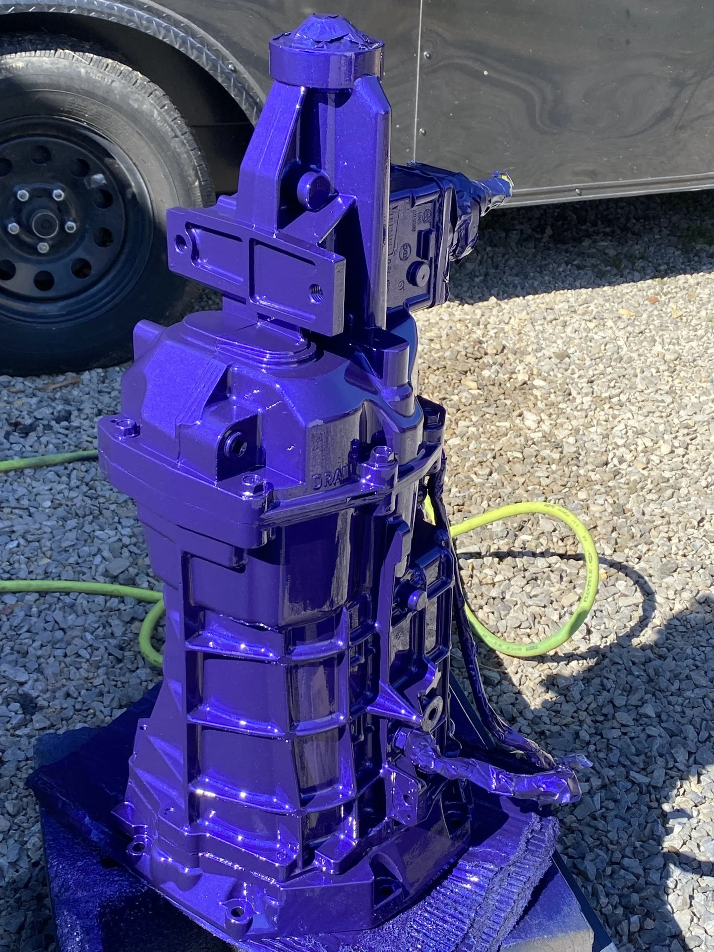

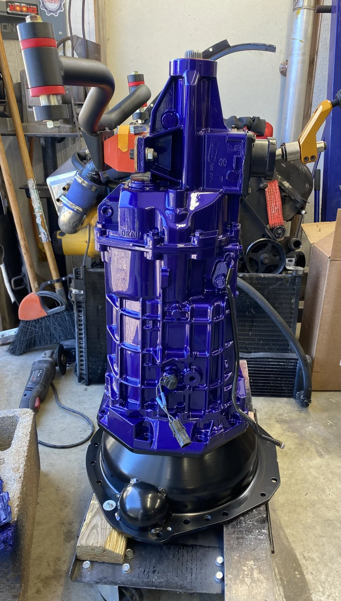

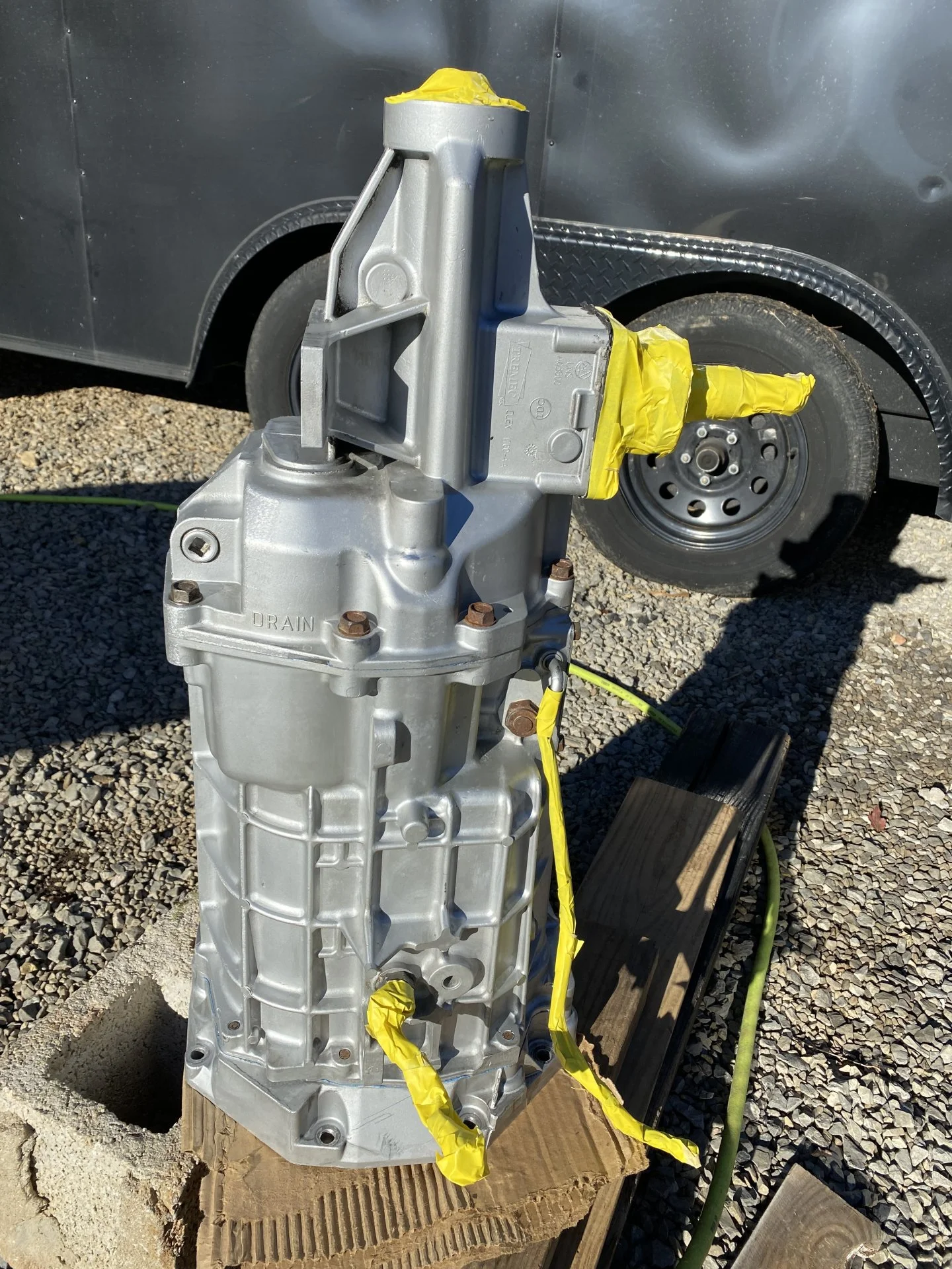

Honestly though, how do you prep all the corners and crevices in the trans to make the paint stick. Wire brushes on a drill?
Reactions: 1 user
95steedamustang
I tend to be on the ocd side…
SN Certified Technician
Apr 22, 2009
2,299
4,005
164
East TN
I glass beaded the whole case then hit it with a red scuff pad by hand to get it prepped.
Then adhesion promoter and epoxy. Not a big deal at all. I work smarter now. Not harder
