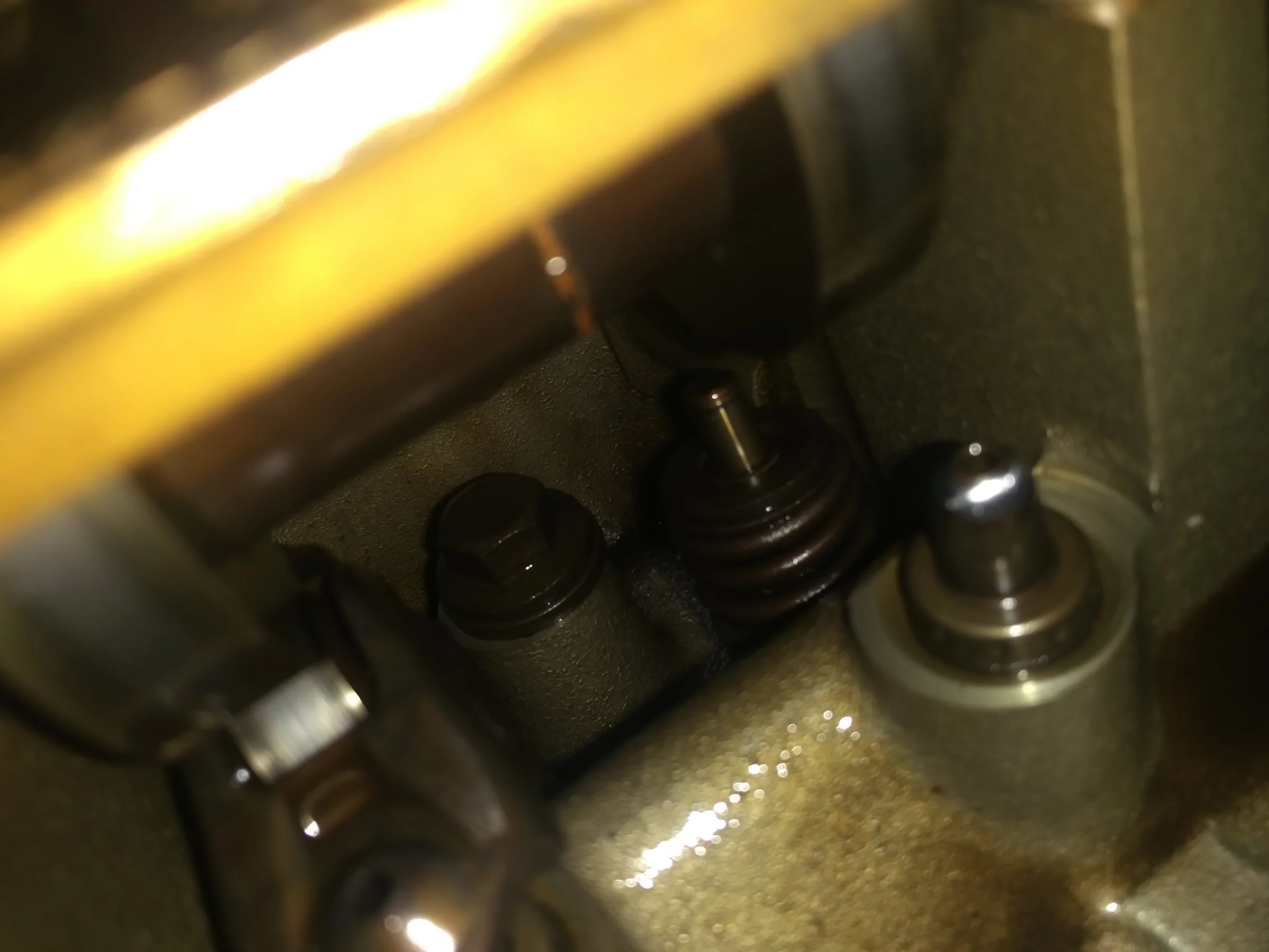

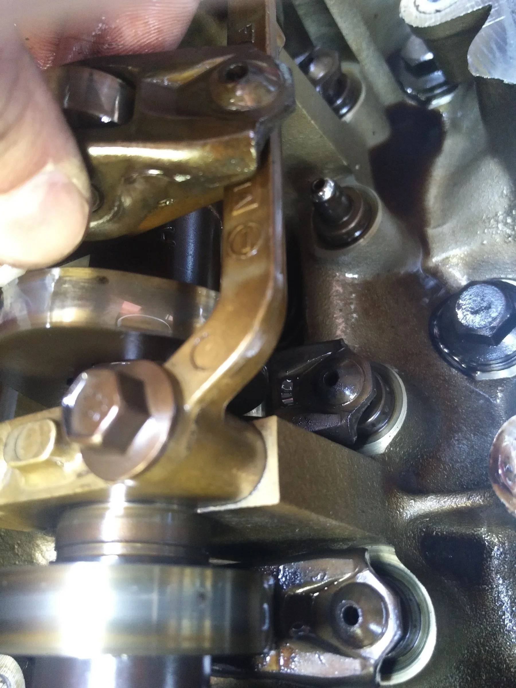

Today I did a compression test and all cylinders except for #4 were between 180-200 psi which seemed great. Bad part is #4 is completely dead; 0 psi. So I pull the valve cover off and low and behold the second rocker arm from the top (not sure if this is correct term for these cars) had fallen off and was sitting on the bottom of the head. I rotated the crankshaft to inspect the camshaft where it mates with that rocker and it appears smooth and unwarped. No damage is evident in the head from it popping off either. What I did notice is that the spring is still compressed and if I set the rocker arm in place it just slips right off easily.
So my question is how are the rocker arms on these engines held in place, is it purely by the tension of the spring or should there be some kind of clip or other method of securing it in place? Also does the stuck spring give a clear indication of what's wrong? Bent valve maybe or something else? Hoping I won't have to pull this motor again so soon but it's not looking good. Thanks in advance for any thoughts or suggestions.

One more thing is I didn't have a dipstick tube attached at the time this happened. Could that possibly cause a drop in oil pressure that would affect this? I know it's a Longshot but can't hurt to mention it. I'll look into the boroscope idea. Also I'll attach a photo so you guys can see exactly what I'm looking at. Thanks for the responses so far.
That valve is done. No matter what caused it to hang open, when the piston came up they tried to occupy the same space at the same time. More than likely the valve got stuck in the guide. Head needs to come off.
