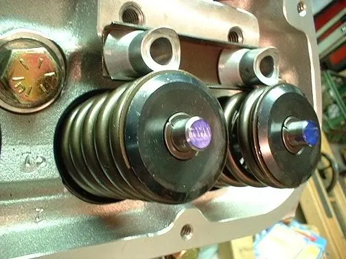

You probably figured this out already, but here is what they look like:
Just updating
The guides are .060" thick, and several of my rockers were shimmed to .060, which was perfect.
However, several of my rockers were also not shimmed or shimmed .030, causing a bit of a problem with lash. My valve geometry was correct before the installation of the guides, so to keep it simple I didn't want to order longer pushrods or anything (using 6.875, need 6.9-6.91 for some of the rockers), I decided to simply mill the required amount of material off the rocker pedestals. This keeps all the pushrods the same length, and while time consuming, a better way to go about it IMO.
Only did 4 cylinders so far, but it works great. When you mill the material off, you need to also do a *45 degree cut on the edges so that it will fit properly in the guides, sort of a bevel. The guides are stamped and bent steel, so the corners are not exactly 90 degree angles, more of a curve. The 45 degree bevel on the corner ensures that the pedestal will properly seat
