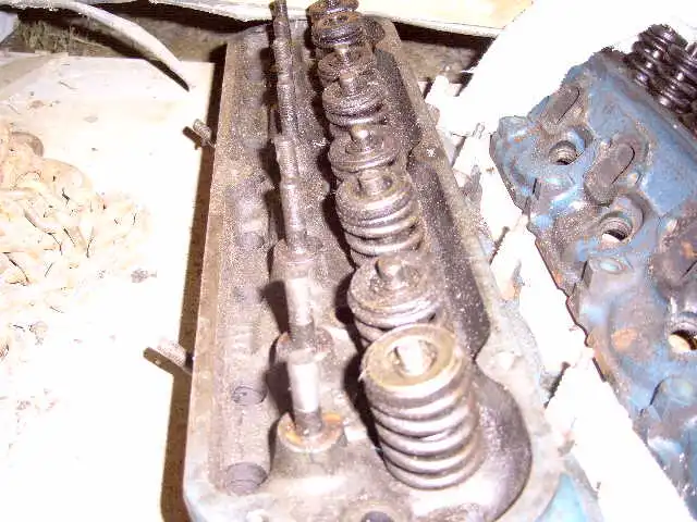

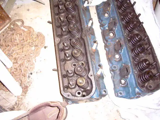

rocker options on 68 302 heads?
I dont think they are rail mounted rockers, they have studs.

you need rail rockers, I think it's comp cams that makes a set of rail rockers with a roller tip..
the reason you need rails is that there is no way to keep the pushrod lined up, the only early heads that dont need rails either have guide plates, or a narrow slot in the head that does the same thing...
