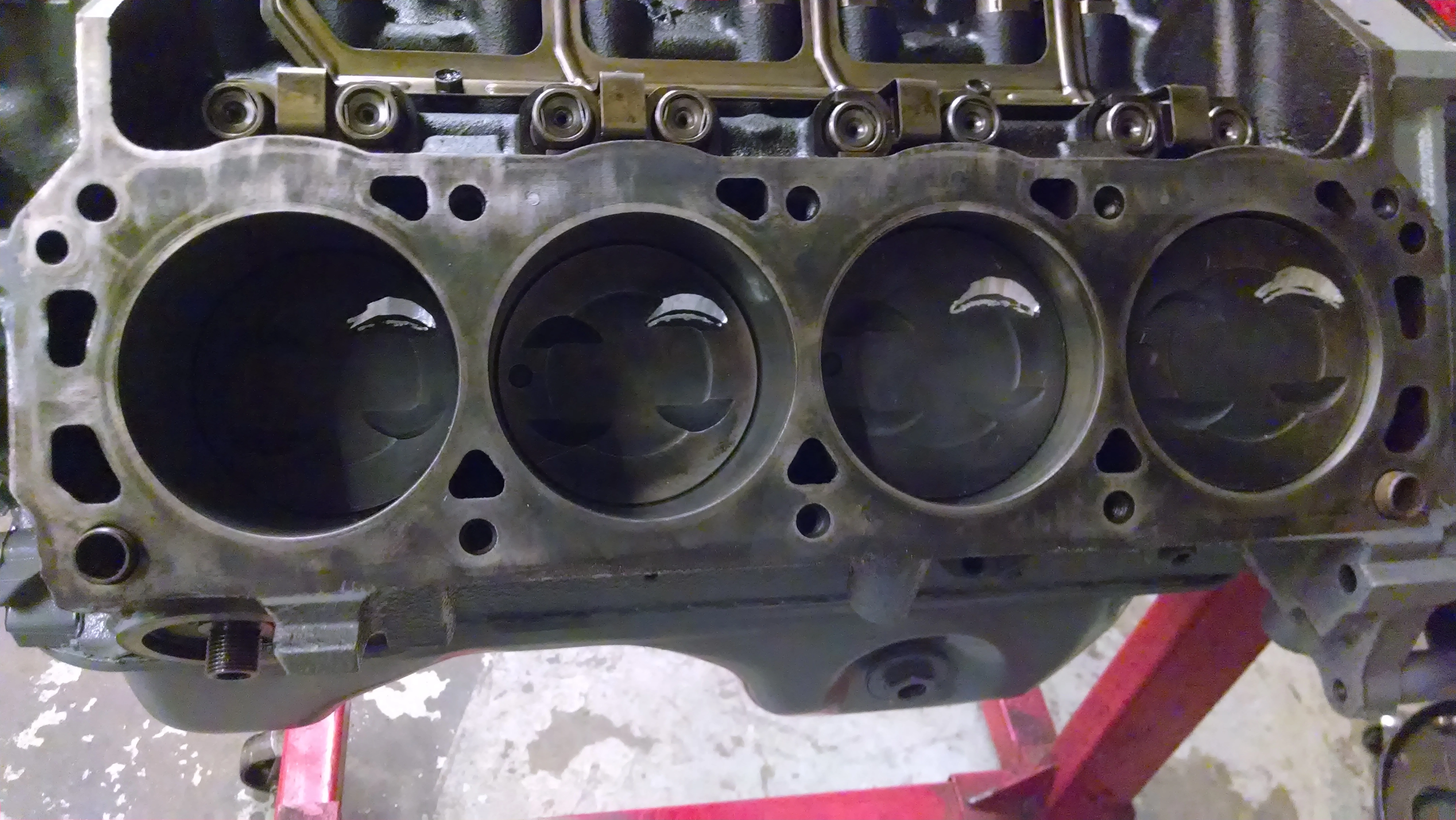

i have 1.72's in my car now... and i wish i didnt. im looking at ditching the B cam (ALL HAIL THE B CAM!) for a more nitrous friendly cam. the ones im looking at the rockers are bending me over due to the stock short block. something about 623 lift and stock pistons aint going to work lol
Want to borrow my die grinder?
