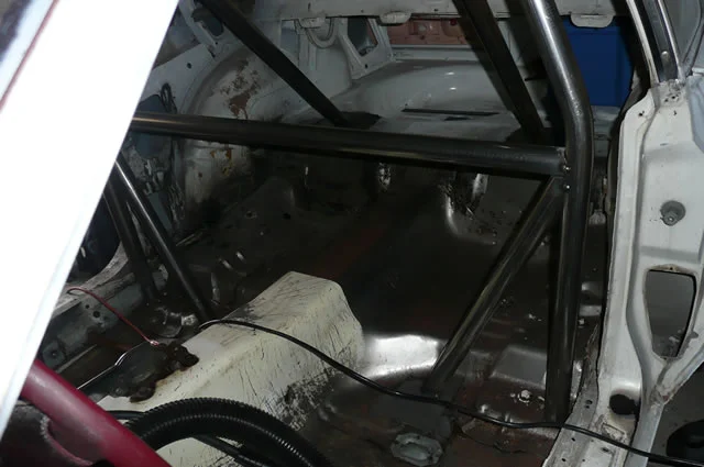

I just started installing a cage. This is where I mounted the strut bars.

Jansen, I think that you would reduce flex most if you attached the bars as near as possible to the leaf spring mounting points. And a big "X" is a good idea, although it could probably do just as much good attached across the rear seat opening. It would probably be simpler and nearly as effective to attach a diagonal to the main hoop.
What reinforcements do you have under the car? Anything done to the "A" pillars?
If I remember correctly, the rear leaf spring shackle is bolted to the bumper shock absorber, which is in turn bolted underneath the trunk floor. I would think that bolting (or welding) the downbar anywhere near the attachment points for the bumper shock would be great.
Did you end up adding any reinforcement to the rocker panel area under the doors or to the windshield pillar? Do you have subframe connectors?
