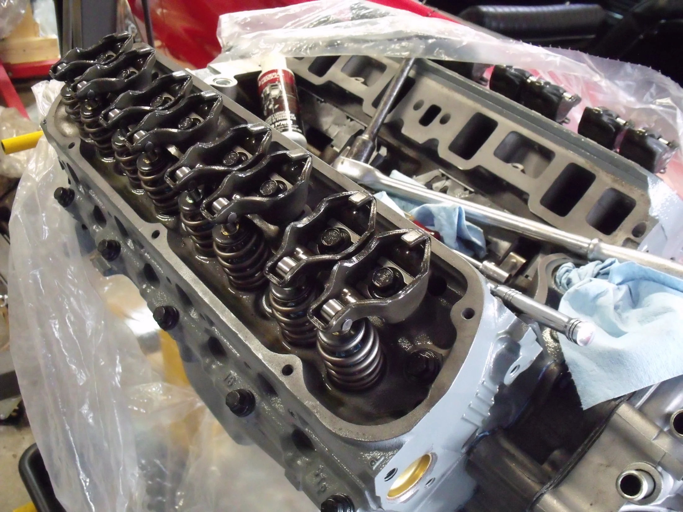

I used some roller tip rockers on my " P " heads as I was going to change out my rockers not knowing how many quadzillion times they had gone up and down in their lives..... My reasoning is the roller tip helps prevent " sideways push" on the valves contributing to bore wear....

You don't have many options for bolt on except pedestal mount without spending alot on machine work " as far as I know"...
If you go down the path of alot of Hi Po parts on your stock P head, you will have more money into your P heads tham a nice set of aftermarket Aluminum heads that will perform better....
You can run full roller rockets, roller tip rockers (not sure they are available anymore), or stock ones. How much wallet do you have and is 10 to 15 hp worth it?

Crane used to make a pedestal to stud mount conversion kit. I had the kit at one time, but never used it and gave it to a friend.
Pretty sure this was it. https://www.summitracing.com/int/parts/crn-35655-16
Just buy a set of for racing or crane 1.6 or 1.7 pedestal rockers on facebook and shim them as necessary.
No chance I'm going past a valve job on gt40 iron anything, the money just doesn't make sense.
I had not seen that article listed above and while informative that's like $800 in parts and that doesn't include labor. Not to mention that is 2014 money.
