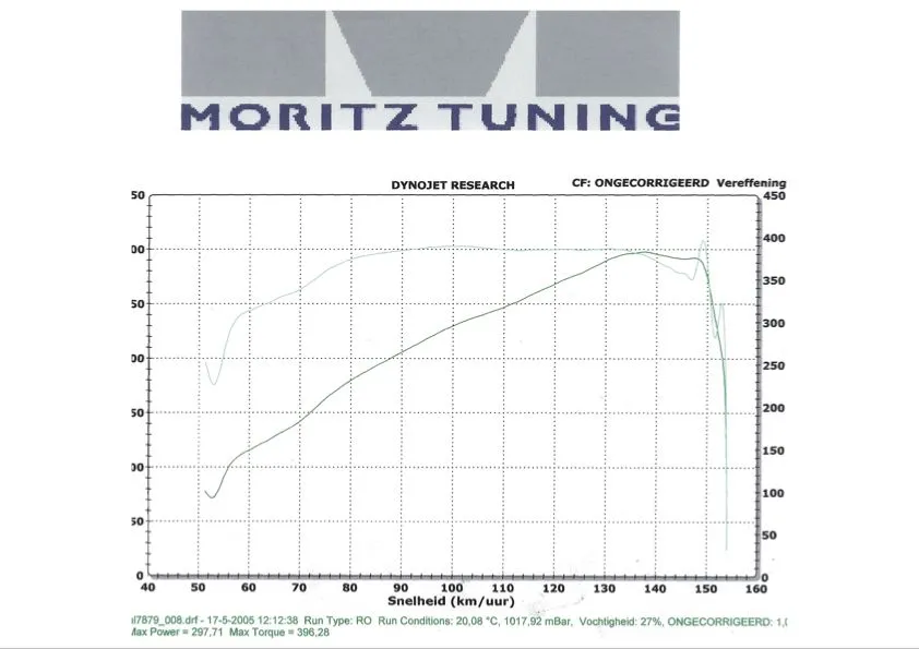

If I convert to a roller and get better valve springs, how much "more" cam could I turn and what kind of gains might I see?
My objectives are to realize more HP and more torque than now. I am stuck with my current heads and pistons but I will upgrade to a 700 cfm double pumper and an RPM Air Gap.

I was right, that is pretty lumpy ;).
If you dont have any more space between your valves and pistons with the current cam, then you wont be able to run "more" cam per se. If you get a roller with the same specs, I would guess a 10-15fwhp gain just by design. A custom cam might net you even more. This is the point where I put the disclaimer saying I'm not a cam expert, but I do know how they work.
Thats a nice dyno chart too.
