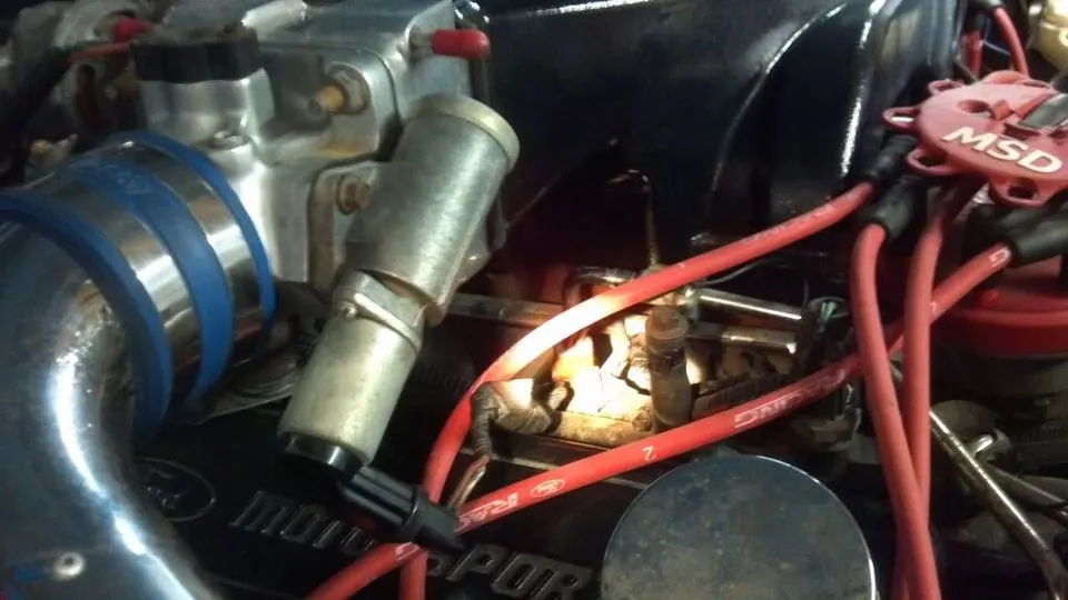

That good and all but i got a bigger problem..car will crank for like 2 mins while backfiring like a wikd banshee. Then with some thottle effort it will start and stop backfiring..

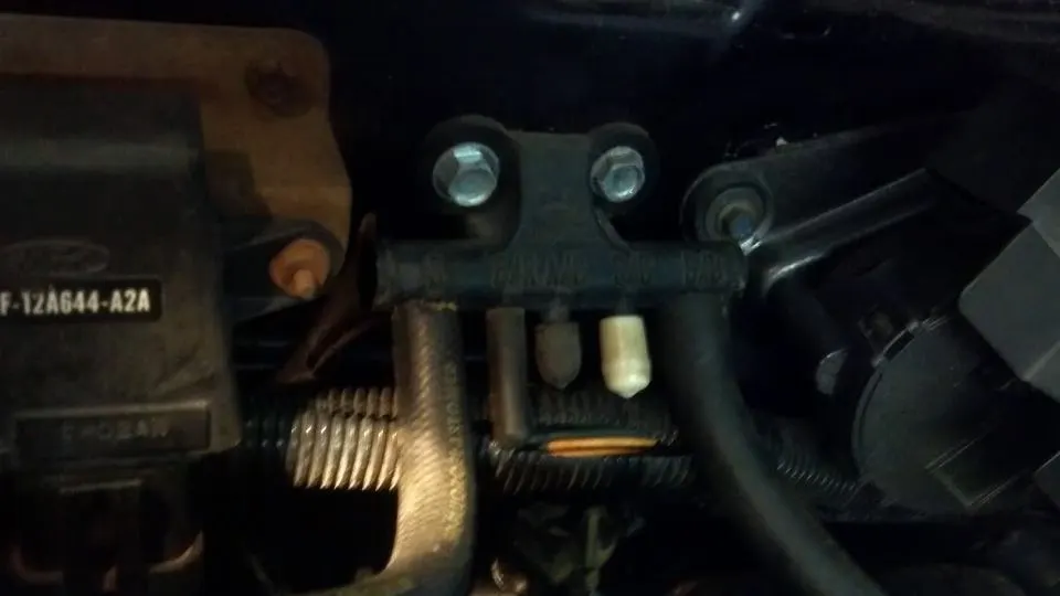

Does anyone see anything missing??

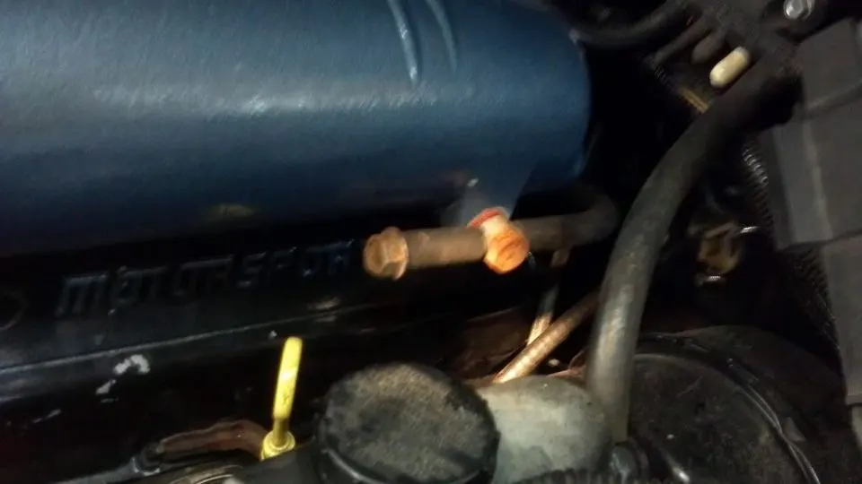

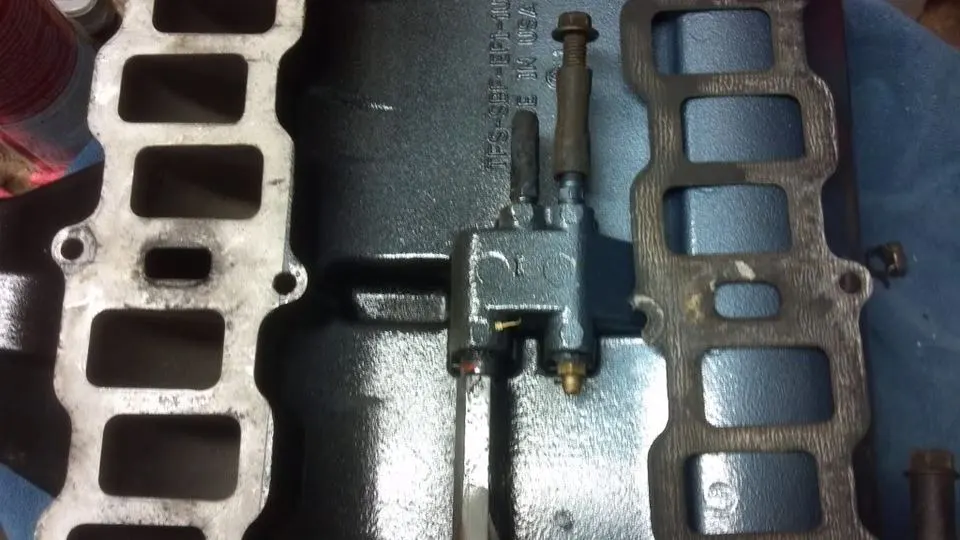

found a chunk missing from the gasket, but idk if its close enough to be a leak? And that port with nothing on it had a piece of hose on it that i knocked off just by gently poking it.

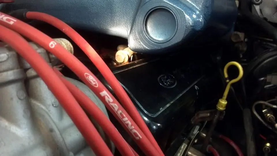

Did it run fine before? Did you change anything? This just started out of the blue? The gasket missing could definitely be the cause or that piece could have ripped when you removed the intake. Try and put a new gasket on it, that's a cheap, easy fix. Also I cant tell what the is in the second to last pic but if that's the upper intake there should be no open holes on it. If if didn't go anywhere then cap it. And use plugs with a clamp, dont use those hoses with a bolt stuck in it.

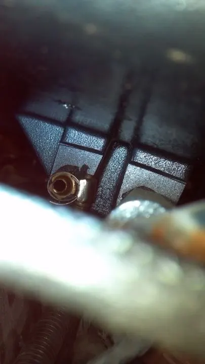

that second to last pic is the port with no plug on it in the last pic. it was plugged but not securely. so im hoping that is what is causing the car to backfire.

Honestly chances are it was doing the job, but if you have it apart I'd put it back together the right way, I'd unscrew that nipple and thread a plug in it. Again did the car always run like this since you got it? Or has it just started? If its always been like this, tracking down someones hack job can be a serious pain, and you shouldnt be intimidated by the surging check list because its gonna be your only hope. Couple things I would check is spray the motor with carb cleaner while its running to check for change in idle, check the timing, and check the wires on the MAF conversion. The VERY VERY first thing you should do though is check the codes.

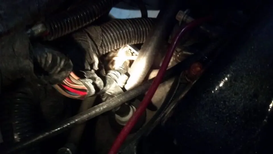

Im not quite understanding how to dump KOEO codes? What do i probe and what am i looking for?

It's the first topic in the checklist..... There are two connectors behind the driver side fender well, one is one wire with a plug at the end of it, and the other is the bigger weird looking one. U connect the small single wire connector to a wire on the bigger connector, turn the key, and you should hear some clicking and the engine light will start flashing. Which wire you connect it to is specified on the diagram posted by Joe. It's really not that difficult at all but if you find yourself having trouble with it find a friend who can look at it and try and explain in to you. Sometimes our eyes can make things more complicated than they really are.
