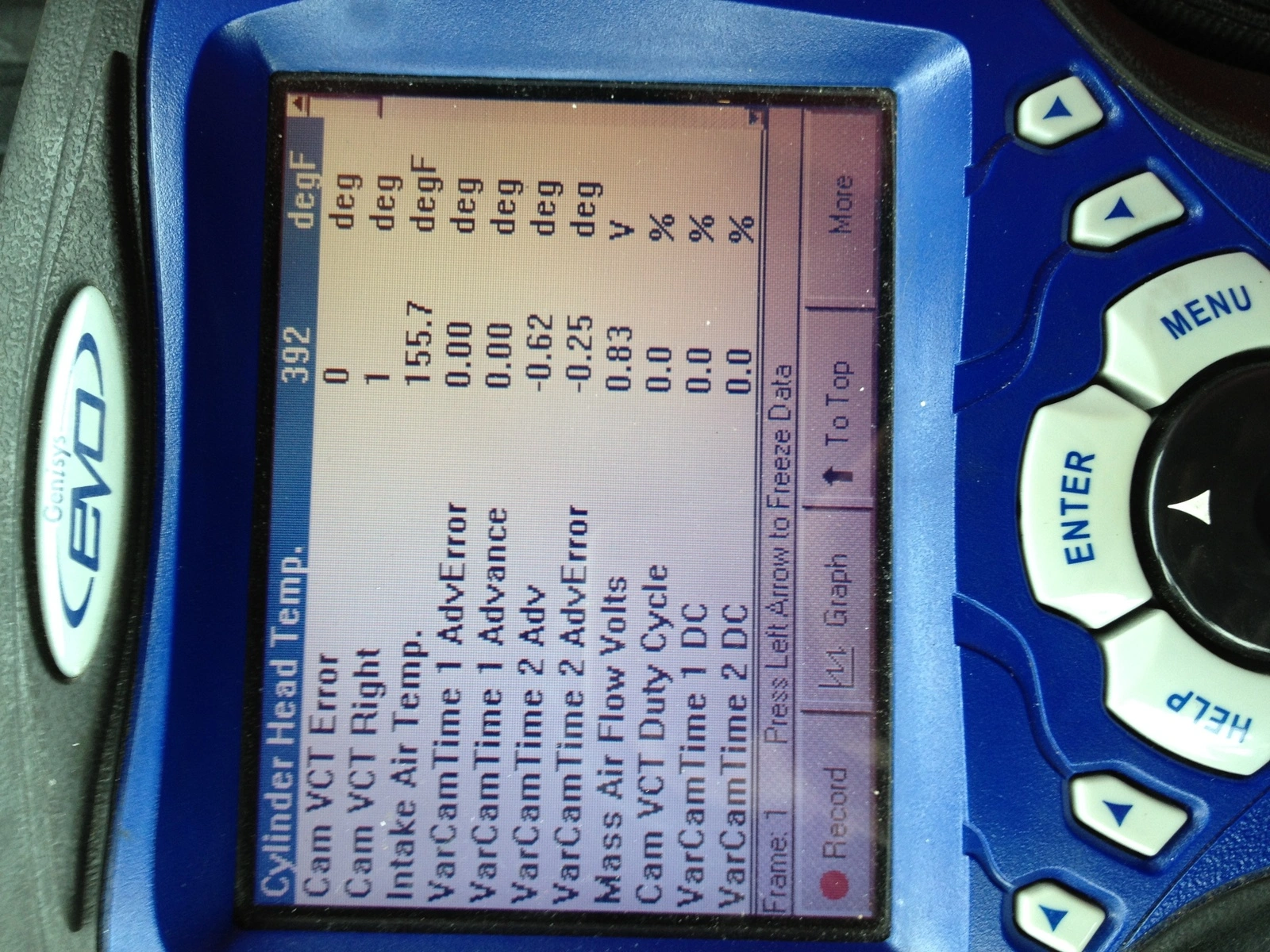

Garrett I have 3 questions for you, 1 about my cars issue, 2 a favor if you will and 3 a trivial question as your the man who knows all the trivia......so your profile says!
1. You said you had to replace a var cam sensor? Was that just the sensor or the phaser as well?
2. Do you have a scantool or do you remember any values? I think I finally found my problem ....not sure but I tested every sensor cleaned all connections ran all the tests I could think of but the problem still remains. With only one bad sensor would the car run a little rough when cold and or under 3000rpm? If you viewed live data on a scantool would u remember some values? Ok that was 2 questions?
3. Without looking it up first are you familiar with the gulp effect??? I'll tell u if you reply!
To me this looks like i have something wrong with one or both sensors, do u see a problem?
Thanks -Mike
Thanks -Mike
Hey Mike:
#1 Just replaced the Cam Position Sensor, didn't mess with the variable cam timing.
#2 Just a code reader. P 0340. no other diagnostic equipment used.
#3 I know nothing about the "gulp effect".
I'd replace the vct sensors, if you're at high mileage, they're relatively cheap, and reread the trouble codes.
Good luck.
Aaaaaaaa.....the gulp effect; it's very interesting knowledge about camshaft and volumetric efficiency....love that phrase....do you know what volumetric efficiency is? I will educate you on both if you would like to know? If your looking for trivia Ill educate you....most techs, even the good ones have not heard of the gulp effect!
As for the cam issue I know the sensor is good, well 90 percent sure. The car would throw a code if it was bad I'm just confused because of the live data readings I'm getting; I may be looking for a problem that does not exist. If you look at the picture of my scan tool you'll see var cam time 1 advance and error and var cam time 2 adv and error. I'm only getting readings from var cam time 2 and vct 1 stays at 0.00. To me this indicated the vct servo is stuck or not working but I get no codes. Also my fuel trim is equal, bank 1 and 2 at any rpm. I'm wondering if my scantool should read a value or not.....silly question I know, why wouldn't it? I'm going to try swapping cam sensors and see if bank 2 goes out and bank 1 starts reading values. If it does cam sensor is bad, if it doesn't then I'm going to focus on the servo. Any input on that? Get back to me and I will tell u about the gulp effect and volumetric efficiency!
Cool:
The vct uses a solenoid to control oil pressure to the sprocket-advance mechanism. Maybe one of the solenoids is sticky.
I agree, I think they share an oil passage so if it was plugged neither would be working. I have not done my research on removal of the solenoid, I hope it comes out through the top and I don't have to remove the valve cover. If I do I will dvom them while driving (long leads and back probe one at a time) I can check at idle.....I believe it's 5-7 % or hz for the cam sensor not the var cam timing solenoid which I'm not exactly sure but I believe it's a voltage change batt volt at idle and will decrease as u increase speed. I will have to double check that but I will probably just compair the 2 since I know one is working. I will reply again with volumetric efficiency and gulp effect....too hard and too much to do on my phone.
