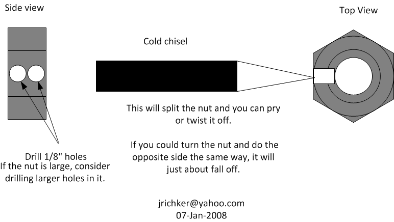

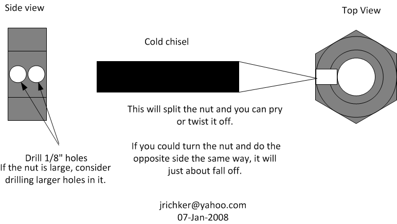

Here's the trick with rusted nuts - no brute force, just finesse...
Thank you for the tip, but the nut im talking about is the passenger exhaust pipe nut. Its all one piece now which is about as fun to work with as anything that was two pieces but is now one so im just going to my mechanic because he's probably more well suited to handle the issue.
