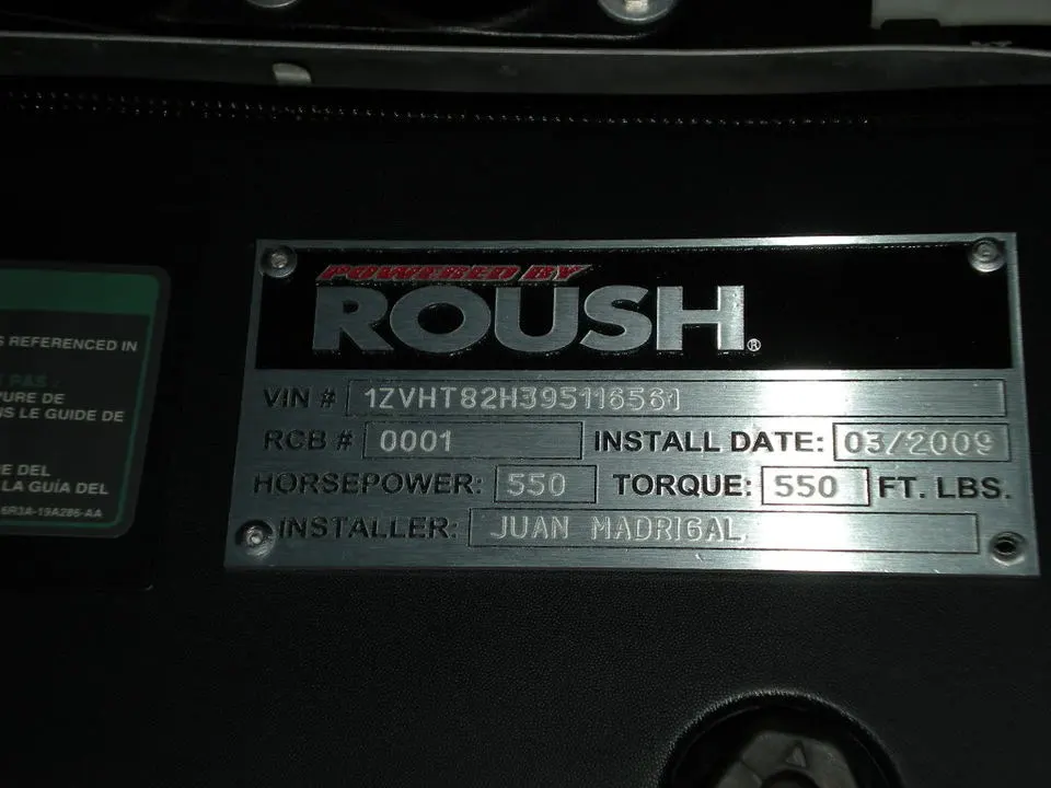

For installations that include a ROUSHcharger®, you will receive an engine bay plaque with a serialized ROUSH Install job number and a letter listing the parts installed.

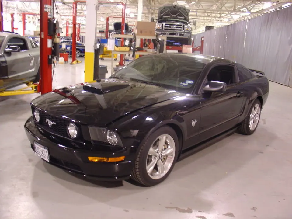

Here's a couple of pictures from our first install:
Before:

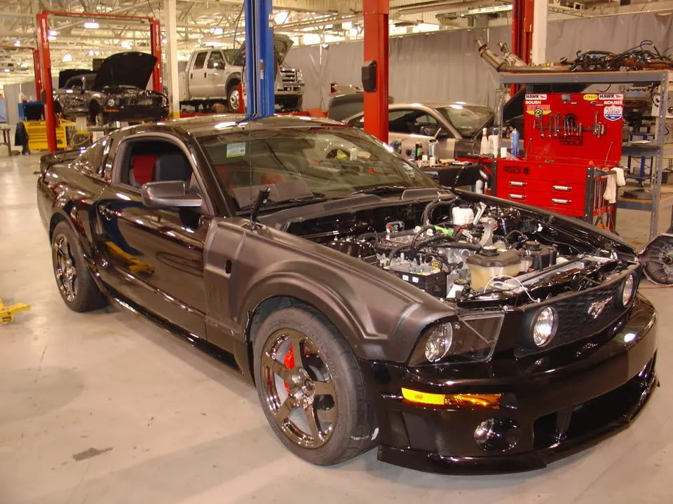

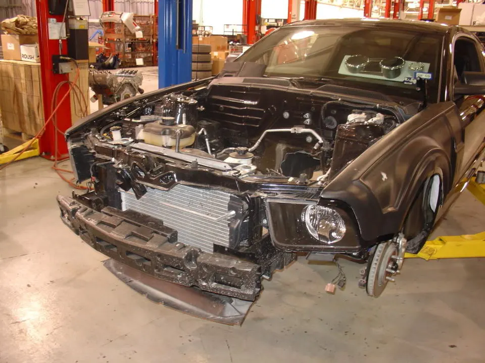

During:

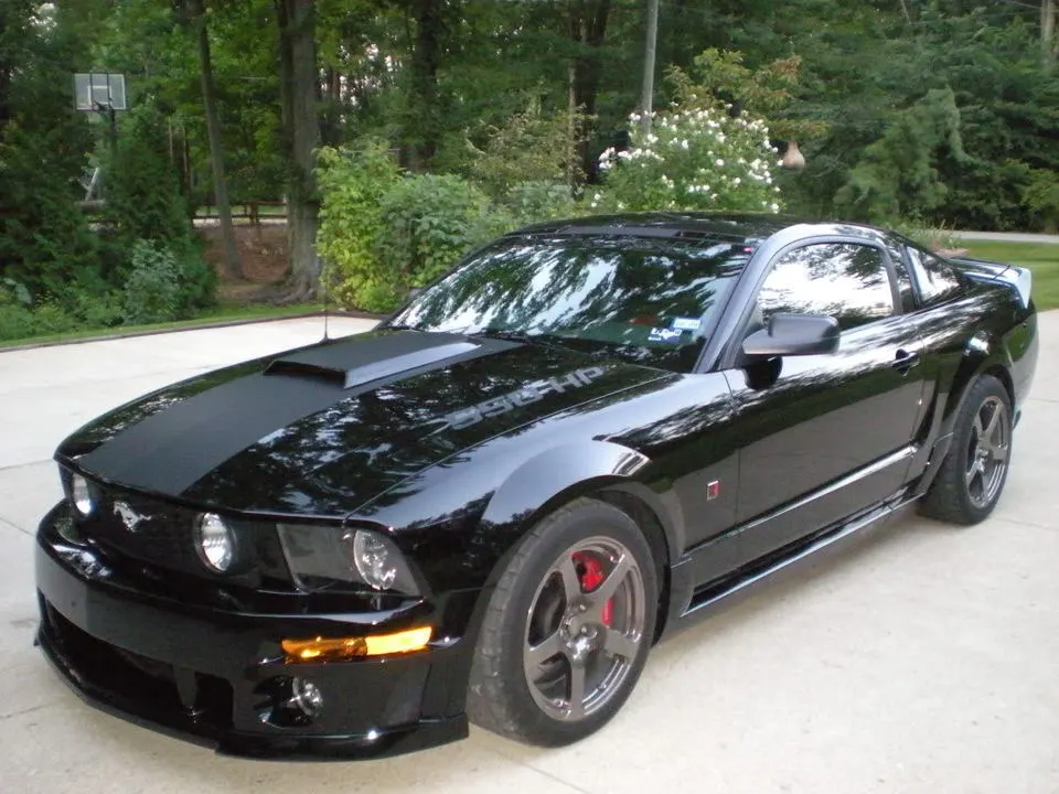

After:

What's this 550HP? I thought you guys went up to 510HP with the P51.
Did the car also had the internals done?
Yes, pulled the motor and replaced the internals with forged pistons, h-beam rods and a forged crank. He also went with an upgraded clutch, driveshaft and rear end.
The 510 hp on our P-51 was very under-rated. Most of the customers I've talked to said theirs dyno'd out around 500 whp, closer to 560 or so crank hp.
This customer actually called me up a few weeks back. Best out of 3 pulls, he made 540 whp and 511 lb ft on 91 octane, conditions were 81 degrees at 43% humidity. Not saying that every car will break in this well. But this is with our standard R2300 and a full 3 year 36k warranty.
