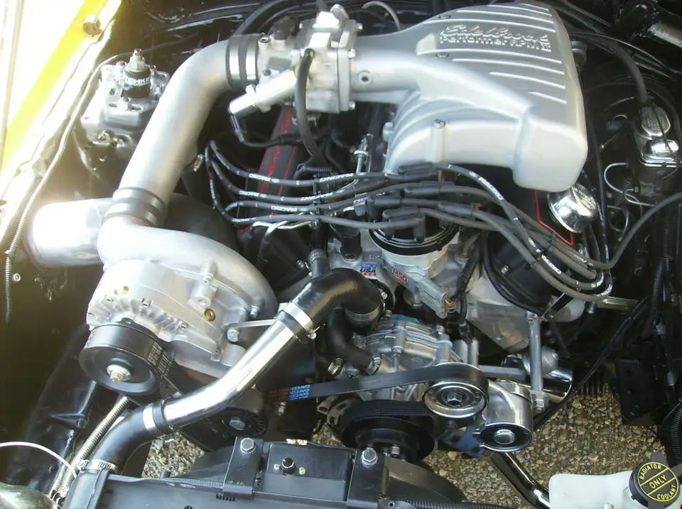

It's changed a bit since I put my blower on but this is what it looks like:
That still looks real clean with the march pulley.
