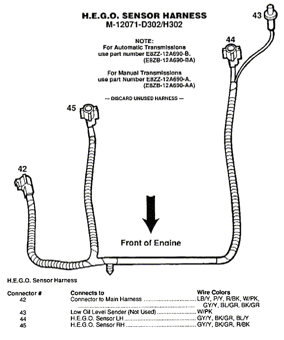

The O2's are the feedback mechanism for the air-fuel trim. Generally but not always, an aero fox will run rich in FMEM, such as you are. This is not always the case however.

i need to find this harness maybe ebay then i can hook up the o2's going to start looking
