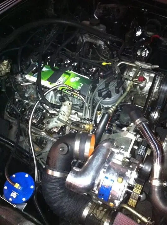

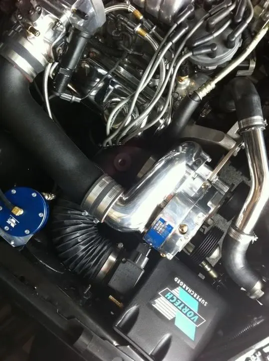

I'm thinking MAF too. Was just told we added MAF voltage 0-4.999 on the twEECer. Obviously I'm not doing the tweaking, Rog may chime in. We have a Lightning MAF and if AFM would answer the phone I'm trying to buy the MAF adaptor so we can run it on the car. Right now this stock MAF needs to go.
*Note-don't say the MAF is backwards in this picture, it has been corrected, just laying in fender for pictures.

why play with the mass air curve at all in the tweecer if you have the stock maf? just set the injector slopes and breakpoints for the 30lb injectors and it should be fine. also make sure the FMU isn't hooked up backwards

ur also missing a vac cap on the throttle body in the pic

Those were just pictures. The belts weren't on, etc.
The MAF is currently set up as such. When you say FMU on backwards, how is the possible?

If you look in the picture I posted above you will notice the FMU is installed from the top fuel lines. The book says install from the bottom rubber lines (bottom passenger side). Will having these line up top by the intake fuel rails cause a rich condition. We will reroute the lines correctly this weekend. It's kinda the same thing just maybe a foot away. Don't know it that would cause it.

Any ides if the fuel lines are installed up high in the fuel rails rather than down low would cause a rich issue? We are going to install those correctly this weekend.

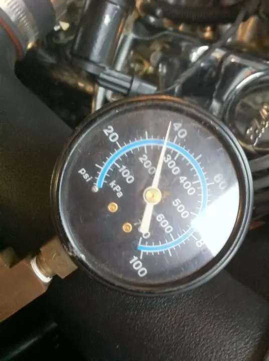

Here os the fuel pressure with the vacuum on.

Oops, here it is.

Your pressure is better than mine. But, it is not a pressure problem form what i read. Its the sizing of the injectors and then the added amount of fuel due to the FMU which is only activated at low vaccuum in the transition to boost. The 30#'s might be enough w/o the FMU ... if it detonates under boost, get out of it immediatley and re-install the FMU would be the only way to check manually. Have you had any contact with Vortech ... what size injectors do they recommend with your setup? Or, do the calculation. Three good options to follow.
