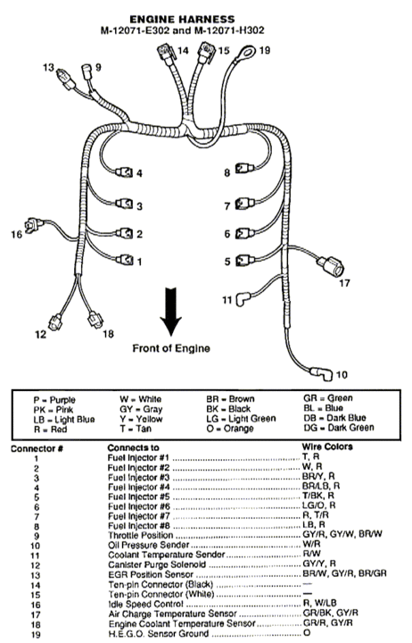

O2 ground hooked to the Back of the Heads or Intake?
#19 in the Picture

The O2 sensor ground (orange wire with a ring terminal on it) is in the wiring harness for the fuel injection wiring. I grounded mine to one of the intake manifold bolts
