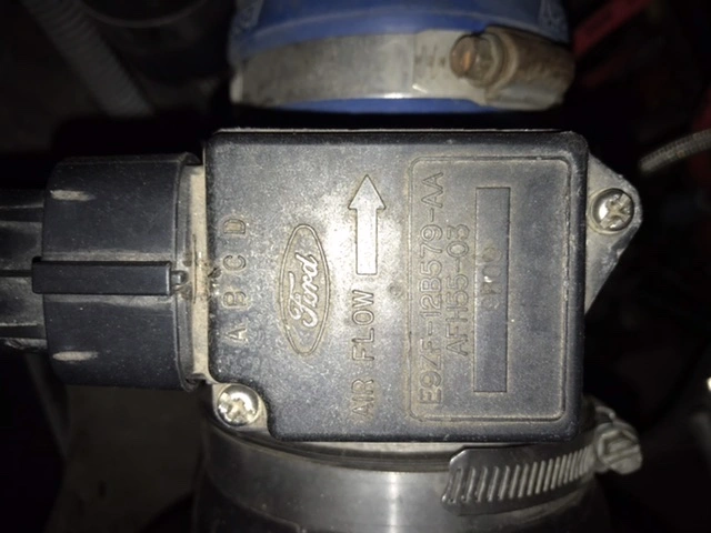

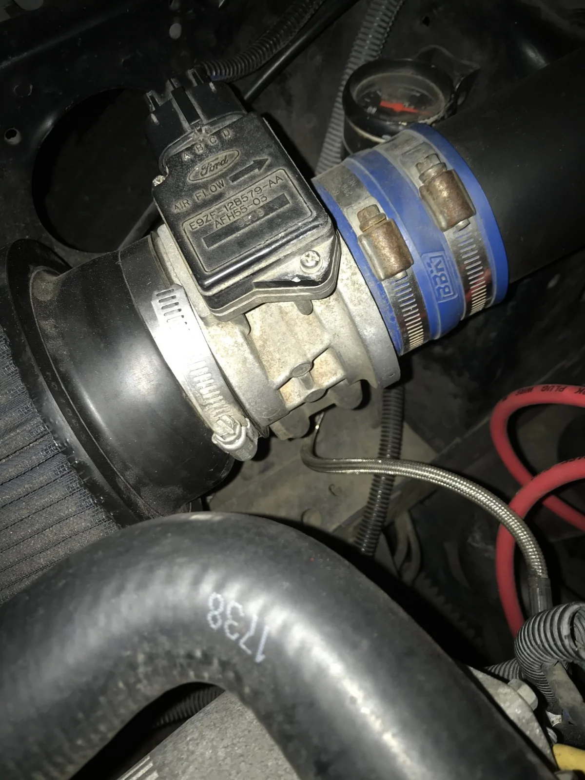

Pictures of the MAF sensor and housing would help. There are numbers on the sensor that may help identify it.

I’ve been reading that this is for a cobra, but the cobras come with 24lb injectors so it can’t be calibrated for my 19.
D
Deleted member 215073
Looks like a stock housing with the correct sensor.
