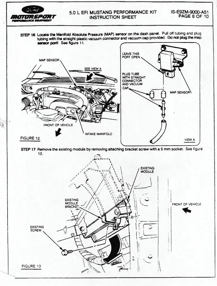

MAP sensor must be reconfigured.

I tried pulling the codes while the engine was running but never got any readings, not even a code 11, I’ll try it again. The MAP sensor is already left open to atmosphere. I do have a new intake ordered to move the filter to the inner fender well.
