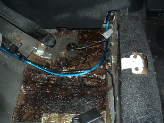

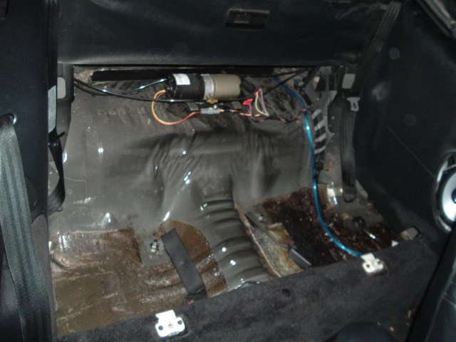

i just went through redoing all the wiring for my stereo because the guy who installed it before i got the car made a mockery of it. you should have seen the rat's nest.
like mo said, it's easy to take the rear seat out.
in these pics, the blue is the power feed for the subwoofwer amp. the speaker feed is on the other side but you can't see it.
the white things in the front are where you push to release the bottom part.
there is a bracket in the upper seat that rests in that rectangular opening in the middle (above the pump for the top).
the little brown spot between the blue power line and the seat belt are where the bolts mo was talking about are.
btw, i took out the padding under the seat because the top leaks a little and it smelled really musty under there.

Are the B-pillars the panels that hide the rear speakers? Mo, could you give me a little more detail as to taking the seat out? The two screws, are those for the top or bottom section? Black96, thanks for the pics, that was really helpful. Now if only I can get the seat out.
