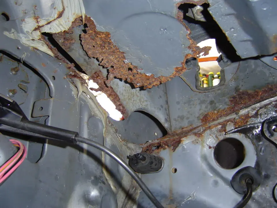

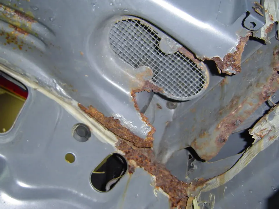

They also like to rust around the deck lid, where the weatherstripping is. I know my hatch is showing signs, so i guess they all would eventually. They hold alot of debris, dirt, and moisture in this area. And the same goes for the bottom of the fenders as well. And around your moulding.
Check the cowl!!
