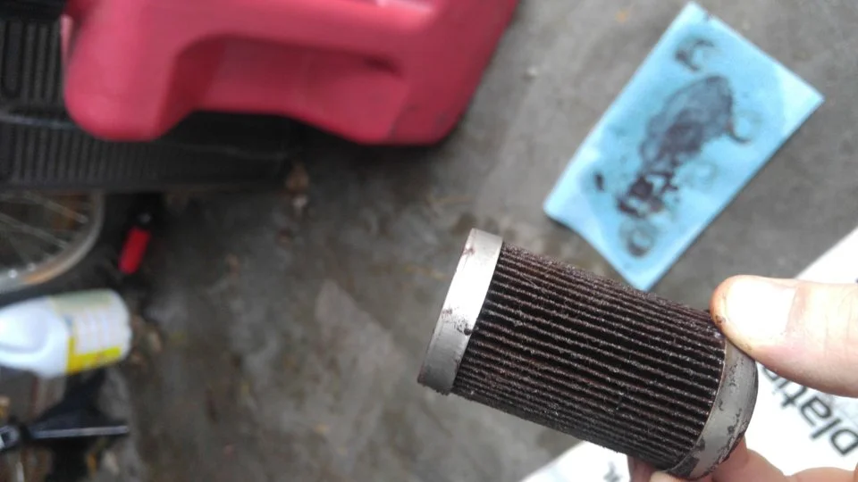

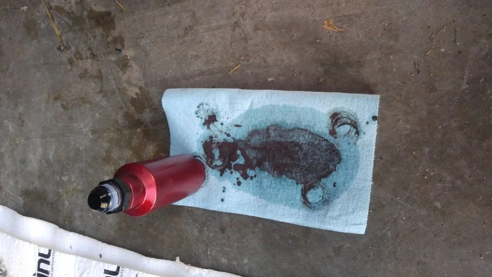

It's finally starting to become nice out, so I was able to unhook my old aeromotive a1000 fuel filter and to change the fuel filters. My fuel pump was slowly dying and finally was on her last breath before I put the car away for the winter. After draining 10 gallons of fuel (that was fun), I unhooked all the line and found this on the intake filter! Is this dirt or rust?

The ethanol in the gas causes a moisture layer that will cause all sorts of problems if allowed to sit. It's even worse for 2 cycle engines.
Would moisture from the garage floor do any damage? When it gets humid Here in northern Illinois my garage floor sweats something fierce. When the concrete was poured decades ago they must not have put a moisture barrier down? Nothing in the garage is rusty, so never was too concerned about it.
Dropped the tank, found out Its aeromotive, and took a peek inside. There's rust spots along the weld where a sump was installed. So at least I know what caused my fuel pump failure, but what do I do now about the rust? Its not a ton but enough to wreak havoc.
