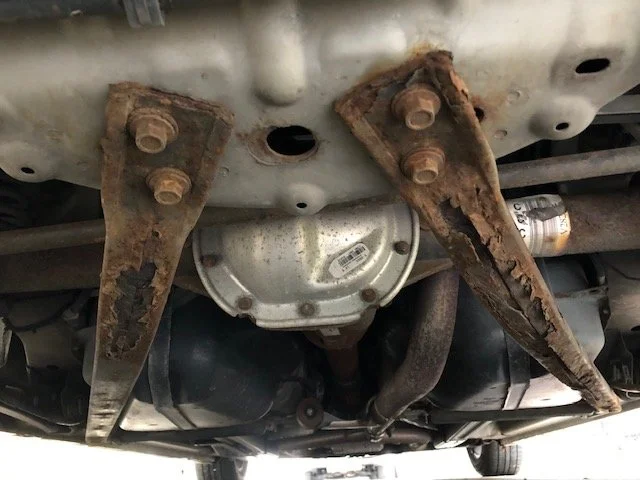

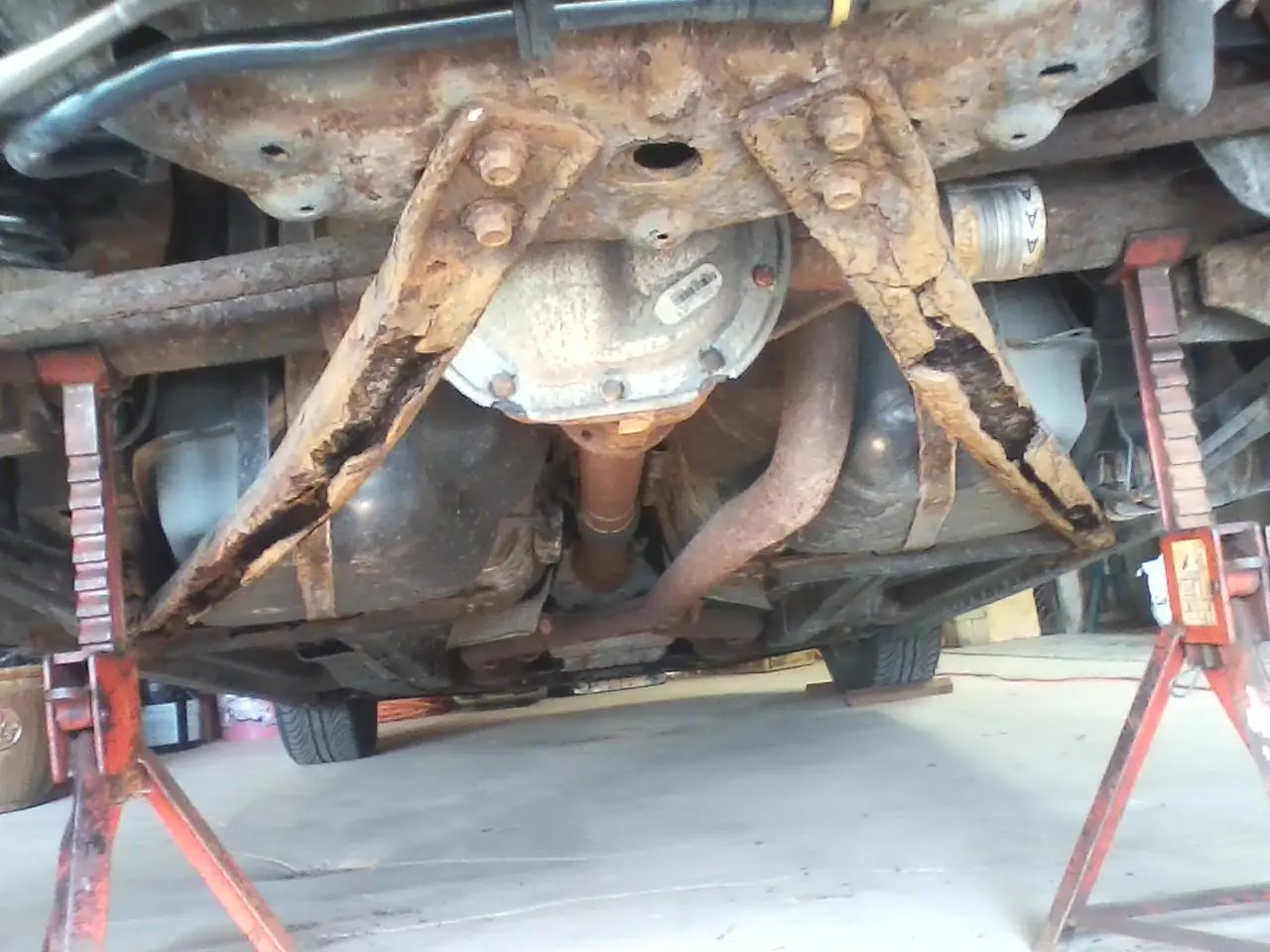

All Mustang convertible owners should check out the rear support bars on any 05-09 V6 or GT for a premature rust condition. The motor company designed this component out of square stock that retains moisture promoting a corrosion friendly environment. View attachment 613657
This is pics from an '08 V6 in Ohio

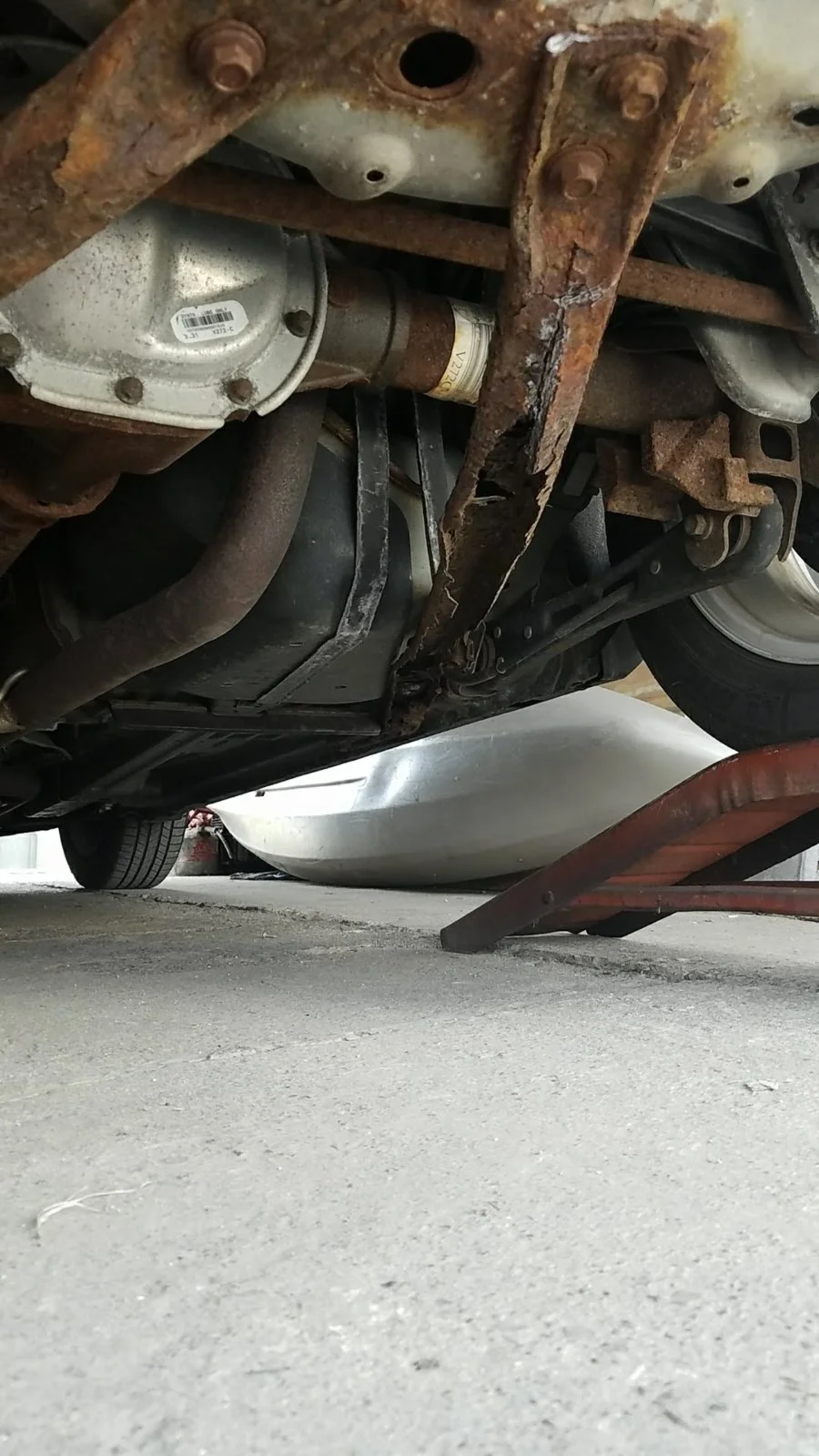

'06 V6 low miles Illinois ragtop

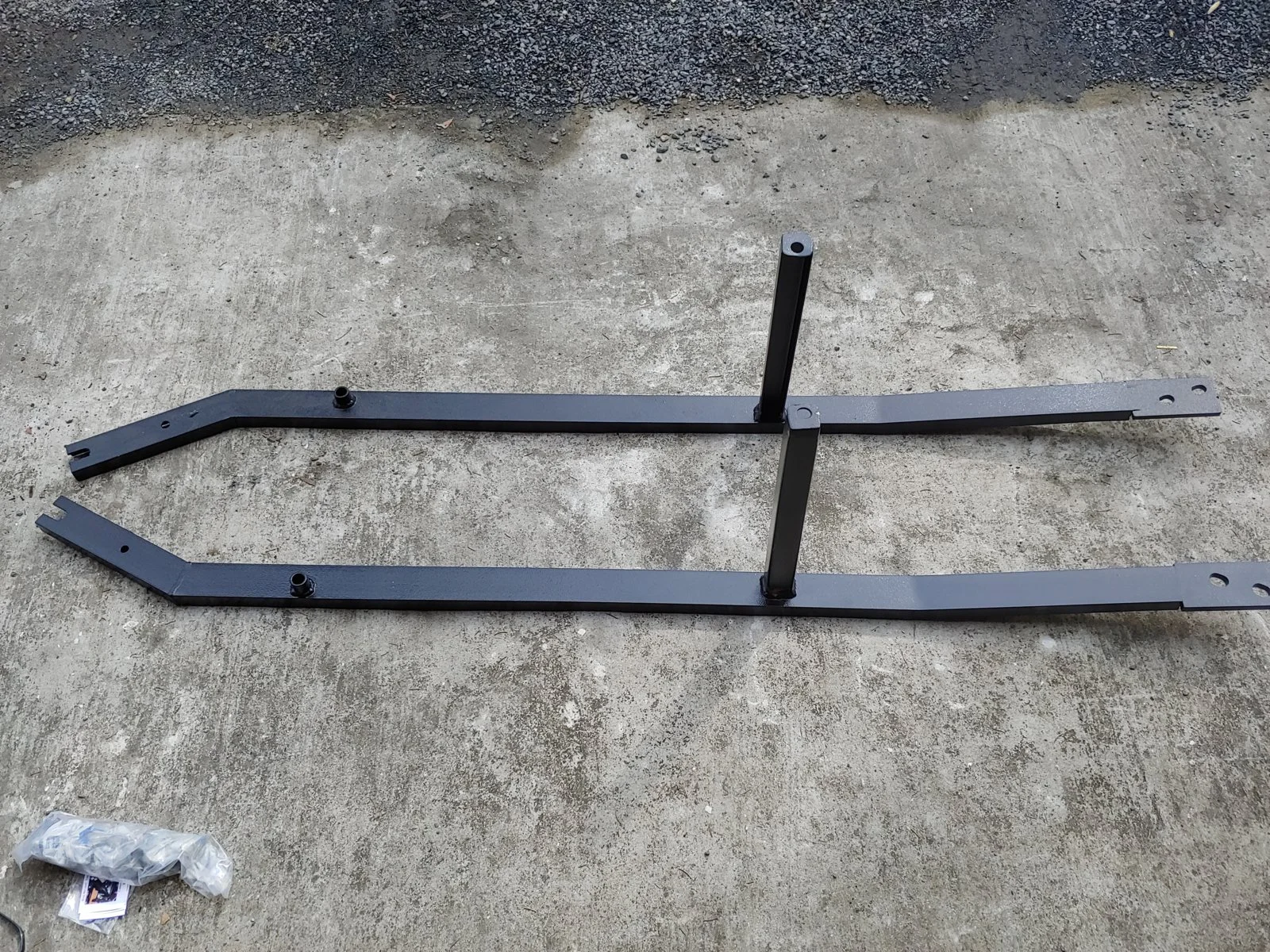

These are replacement braces specifically designed for '05-09 Mustang convertibles only. V6 or GT models are a direct fit using original hardware & existing attachment points to vehicle body as OEM braces. They are constructed with channel steel with no area to trap moisture promoting a rust environment. A military grade black wrinkle powder coat finish will ensure these braces will outlast the life of most vehicles. They are constructed in Wentzville Mo & powder coated by the premiere shop in the St Louis area Gateway Powder Coating. The price of new OEM braces from the motor company( $1500) and being the owner of an '05 vert compelled me to address this rotten brace issue. The total cost for a set of braces (right&left) is $450. That includes shipping to anywhere in the USA. Canada is an reasonable option, just abit extra on freight costs. OEM reconditioned braces are available for the keep it original guys. Replacement hardware sets of 12 bolts are an option & can ship with braces.

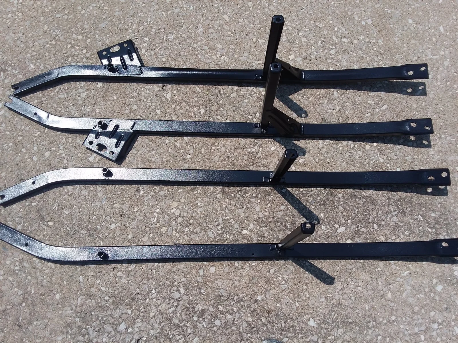

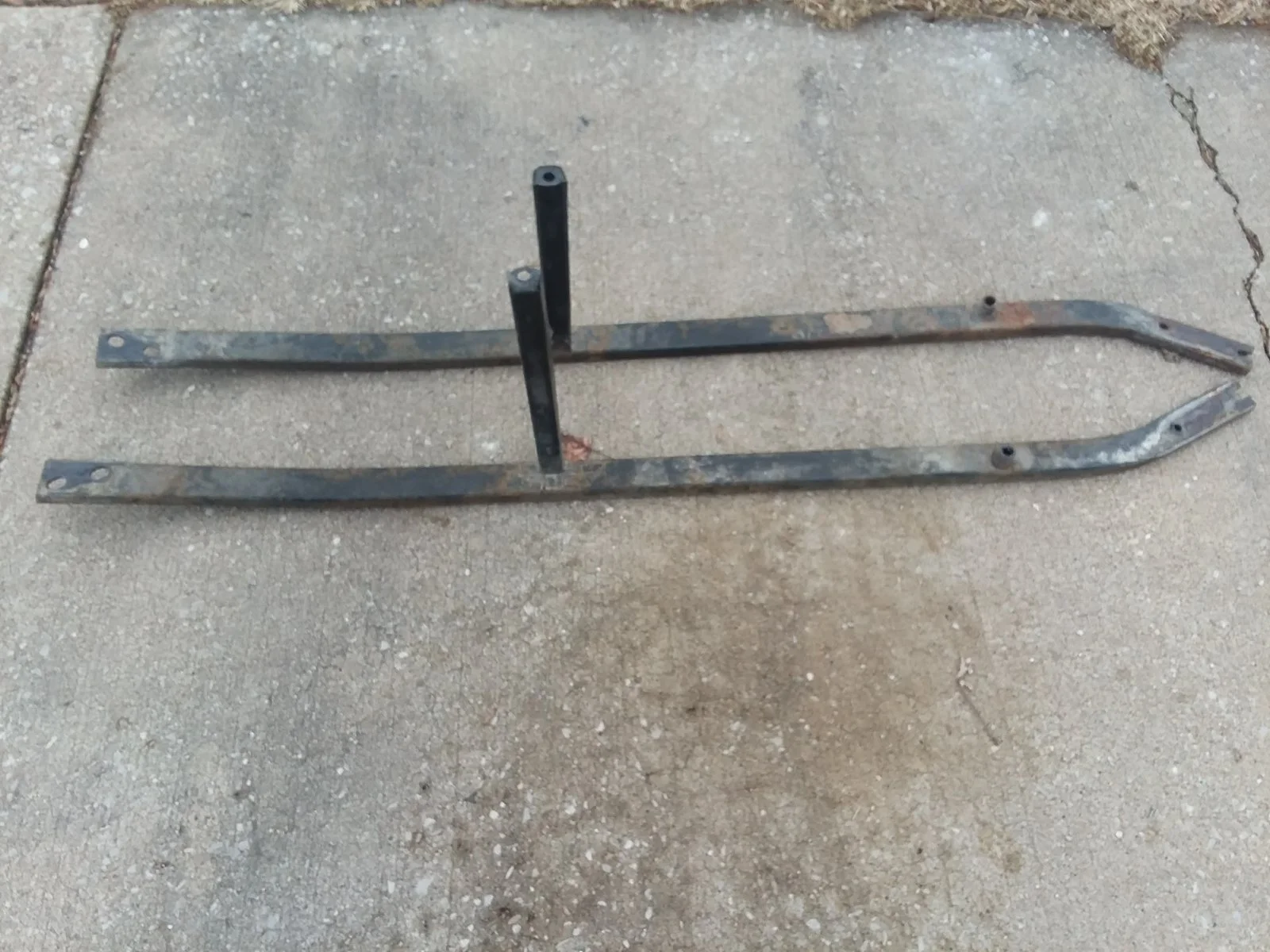

These are reconditioned OEM braces available for the keep it original guys. The lower set in the foto is '05-09 set. The upper set in the picture are from a 2010 convertible. These will rot out also as they are constructed with square stock, there is nowhere for moisture to vent. An awesome powder coat will help keep them dry on the inside.

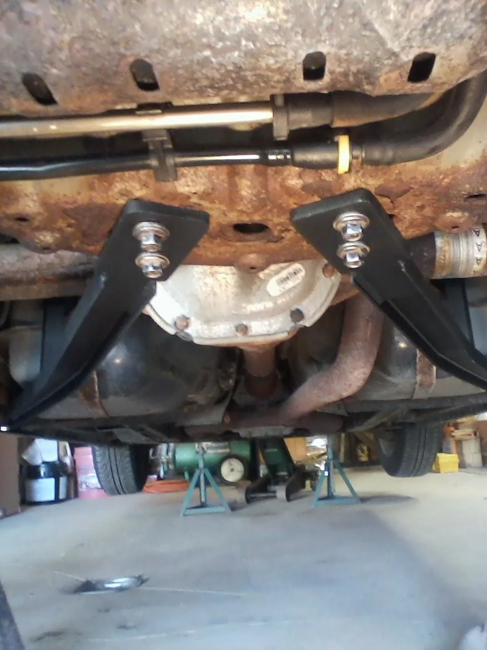

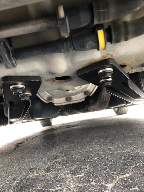

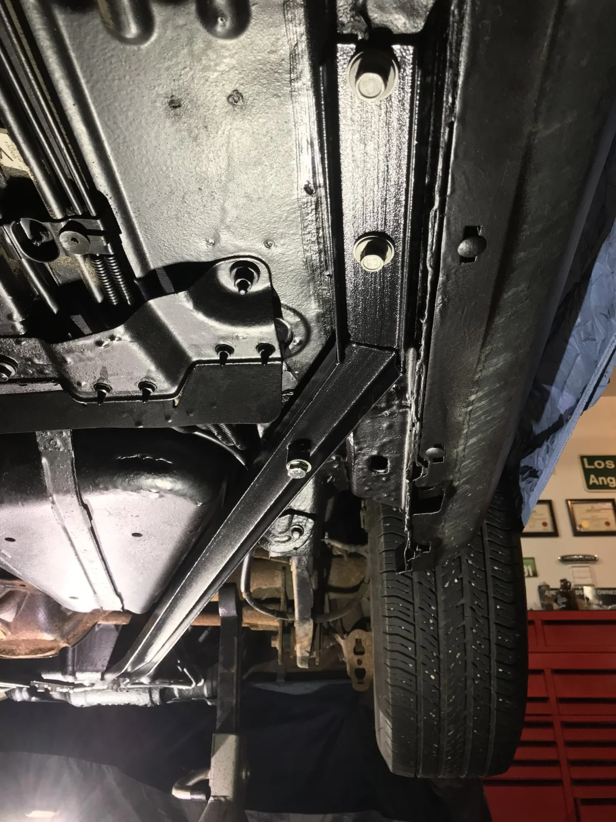

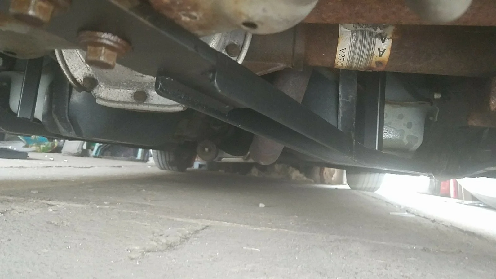

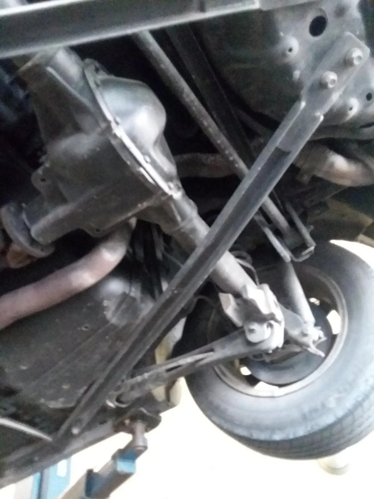

Pictures of replacement braces on my Mustang & other happy convertible owners. My '05 vert
A ladies convertible from Ohio good to go!
Another success story from the Midwest, thanks Duane. Enjoy your ride
Trunk picture
Picture of new brace with rotten OEM brace needing replacement
Some more success stories

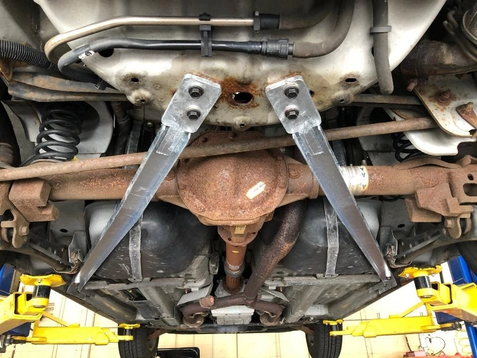

Hope everyone is safe out there, we have a stock of braces ready to ship if you need a set during this garage time. We are offering soon sets of braces with a galvanized finish. Extremely durable finish with a little glimmer to them without the concerns of a chrome finish. What are your thoughts on this? Also a happy convertible in Buffalo NY and happier owner.
Sure does make a case for undercoating. Once upon a time, dealers offered it as a new car add on. Living in Miami at the time was always a good idea.
You guys living in the snow & salt regions of the country, if it were me I'd look into that. Good job on some nasty cancer .

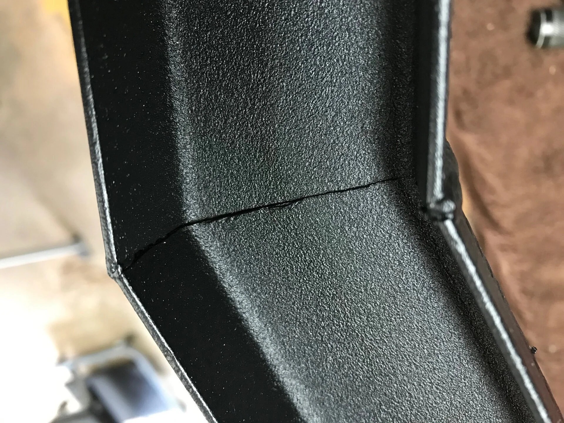

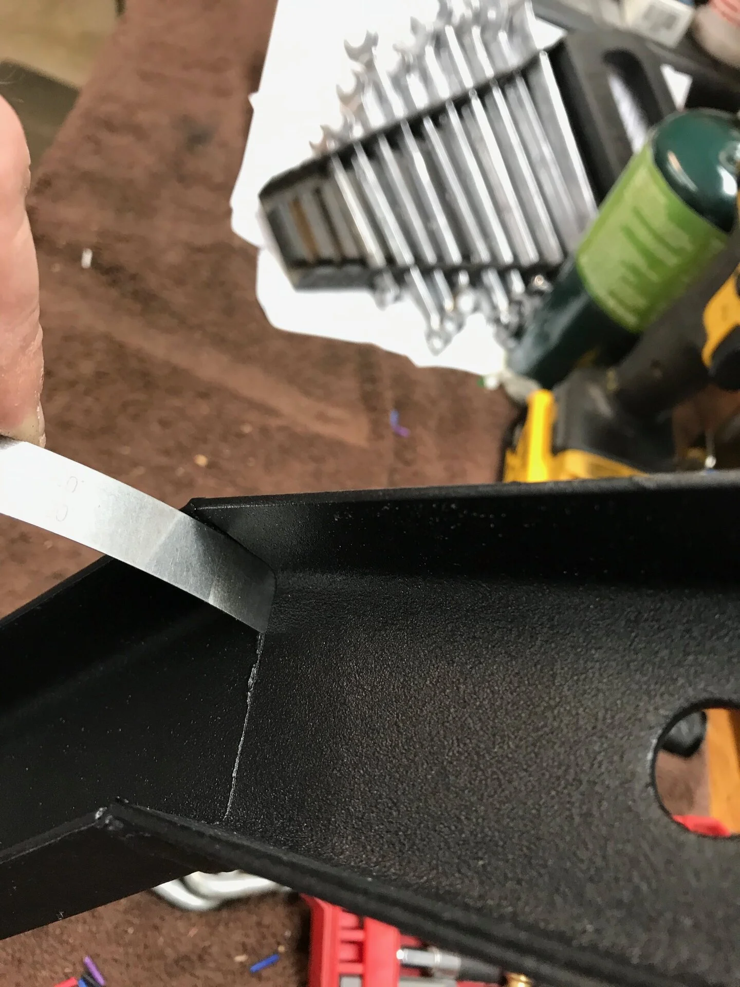

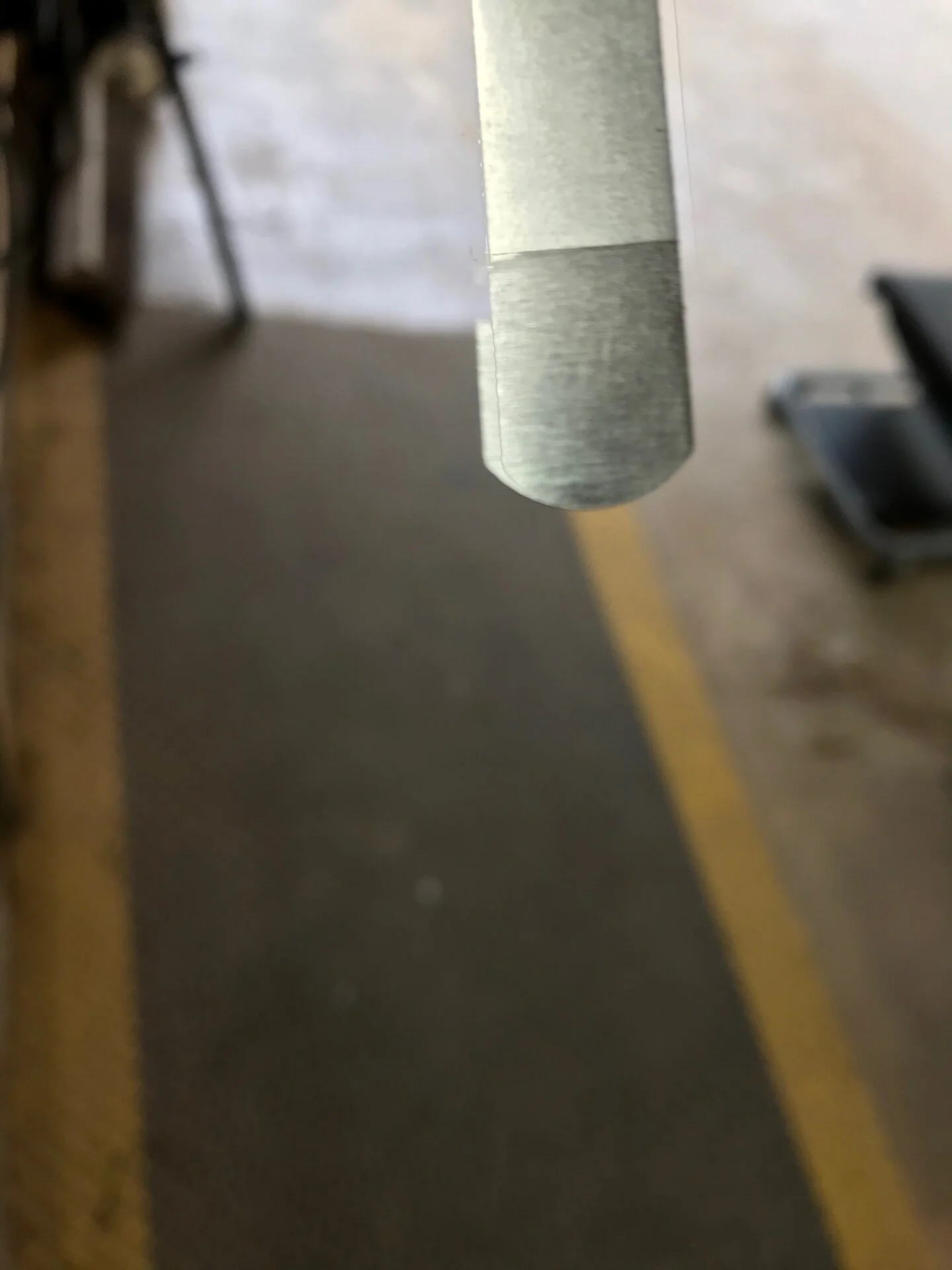

Found some issue with my set I ordered from Bud....welded on one side only and ground flush..
Feeler gauge tip disappeared in the gap indicating the weld did not penetrate at all.
I don't need this to come apart under my vehicle and potentially cause Lord knows what...
As a courtesy I made Bud aware by e-mail but it seems of little concern as "all are manufactured like that". My only option was to have the joint re-welded.
He was adamant that I return his set and not tamper with it....
Well I had the joint cleaned and welded on the inside. I know now that they will no longer have the potential to fail at that point.
Rest of the braces looked great, I opted for all hardware which looked like quality stuff. Packaging was superb as well.
So if you receive a set like this, do a very close inspection of that joint.
Happy motoring..
