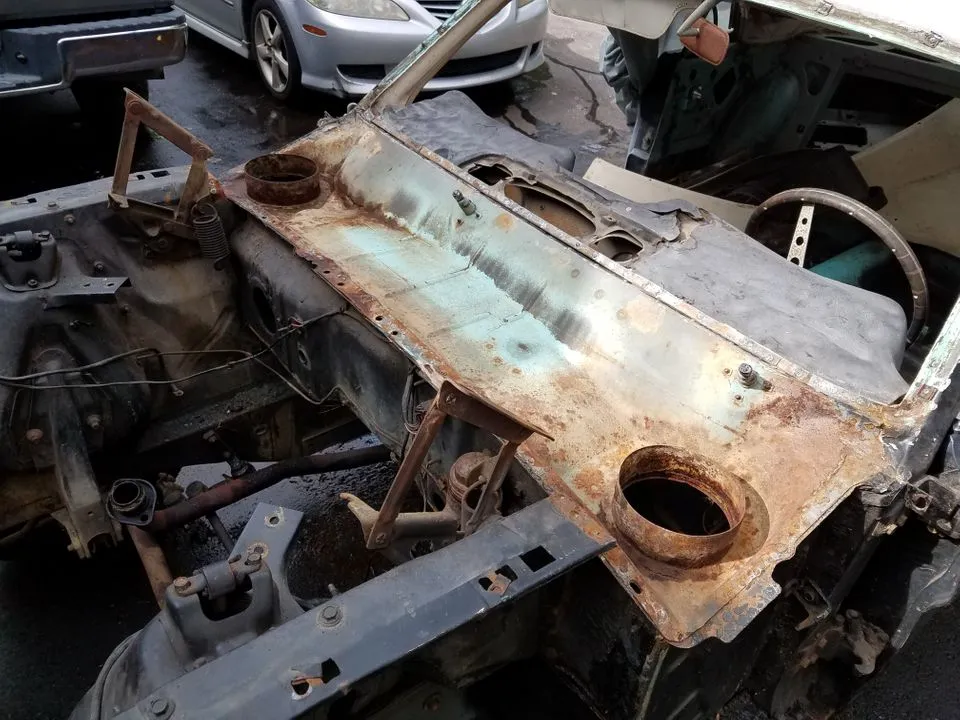

If the floors under the driver foot well are shot...that means your cowl is most likely leaking onto the carpet, which retains the water and makes a rot-rich environment. In short...you are already in for a "big money" project...replacing your floors wont do a bit of good if your cowl is still leaking.
cowls dont have to look horrible to leak like sieves....this is what mine looked like...didnt keep it from destroying my floors.
