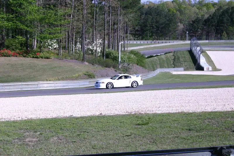

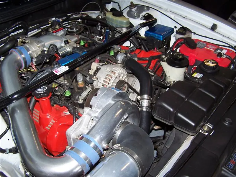

I spent about $2500 on my set up:
Vortech V2 SQ NON-Intercooled
Morpheus Power Pipe
SVT Focus Fuel Pump
Lightning 90mm MAF
42# Injectors
NGK Plugs
Stratmosphere Porsche Diverter
Tuned by Doug from BAMA TUNING (very conservative)
381.5rwhp/377 rwtq
I have run 12.50@110 spinning through 1st.It should go low 12's with my new rear suspension, but it is actually built to open track.
