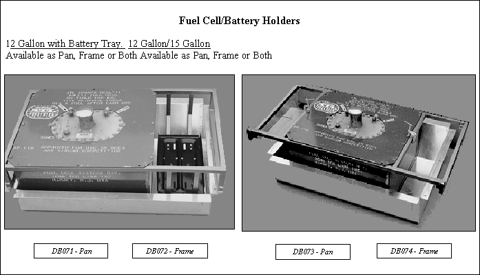

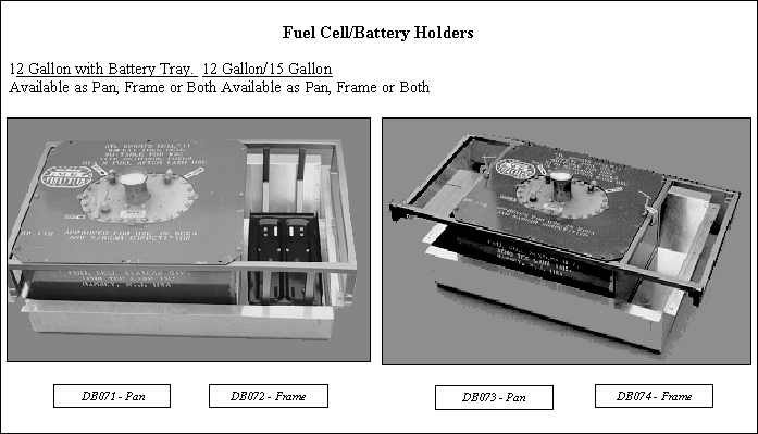

The easiest no-brainer is to take thehueypilot's advice and get the sportsman or pro racing cells from Fuel Safe. You can get drop in units from Mustangs Plus for <$1,000. Another options is to get the standard off-the-shelf 15 or 20 gal. units and use a pan and tray to mount it in the trunk. The tray and shelf are available from Delta Bay Mustang. Taking this route will save several hundred dollars but installation isn't as clean.
